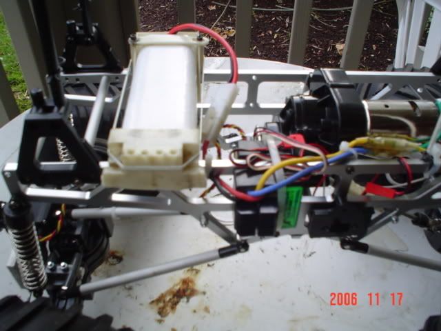

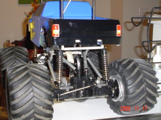

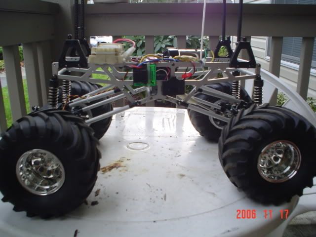

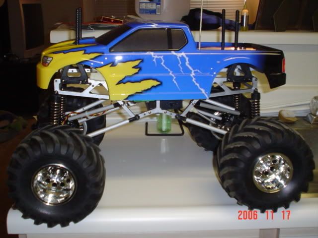

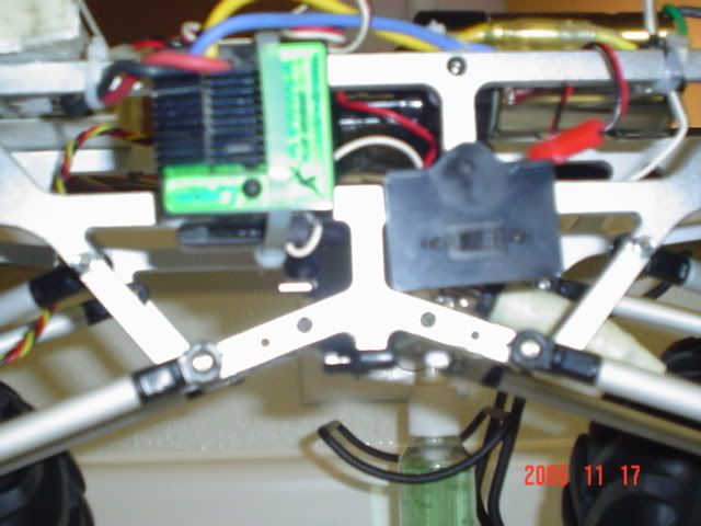

here are some pics sorry for the quality got a ****ty camera:

ok I'll try and get pics up tomarrow, I lowered the body as low as it would go and I lowered the whole truck down over an 1.5" now fromt the ground to bottom of chassis is about 5.25" I like how it crawls and works now like stated a lower COG is great, flip it once because I hit a hard line on some rocks, when before on the same terrain I would flip it on any line across this one rock, now I just crawl on and over it. I am gonn go with 2 lathe motors and 9 tooth pinions my buddy is sending me his 2 new and un used trinity P2K2 motors also. so I will see what combo I like better. I also have a GD600 sitting here for when I decide to go complete rock crawler.
