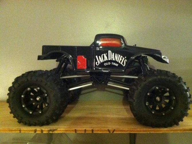

I have a Wheely King that I turned into a crawler. I made all my links and servo mount from aluminum. I flipped the chassis so the battery is in the front. Check out my photos on my page. Let me know if I can help with any mods?

I wanted to build my own, so I bought 1/4 aluminum rod and drilled and tapped them for Traxxas rod ends. I wanted a longer wheelbase then the ones from hpi. My truck sets at 13" wheelbase.

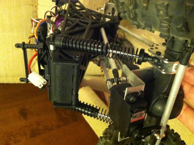

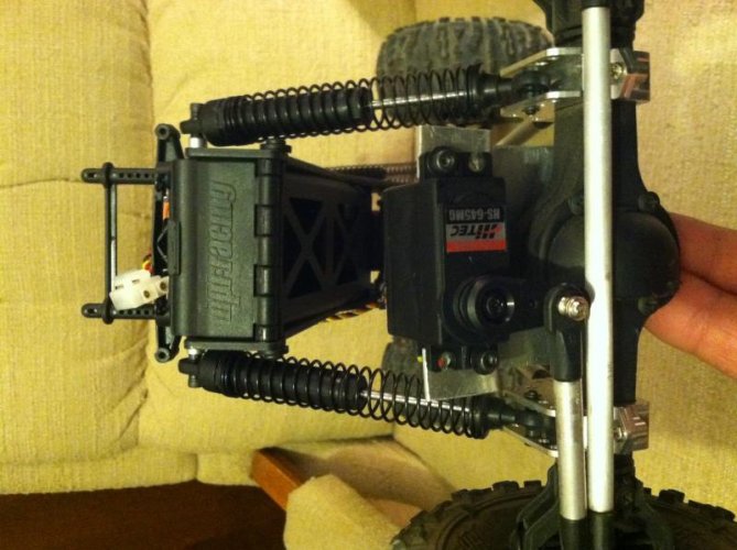

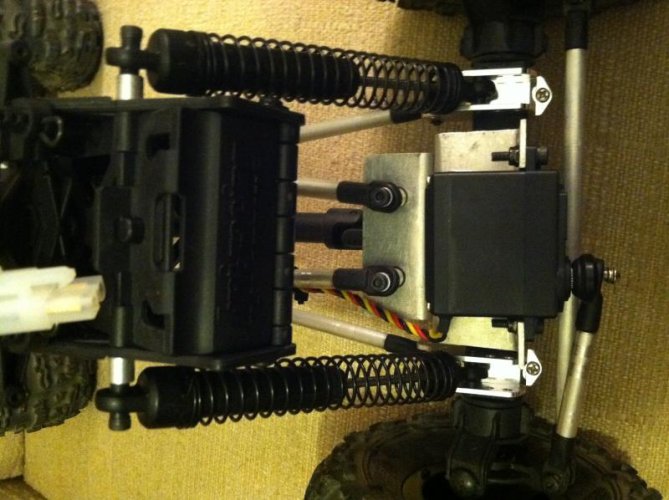

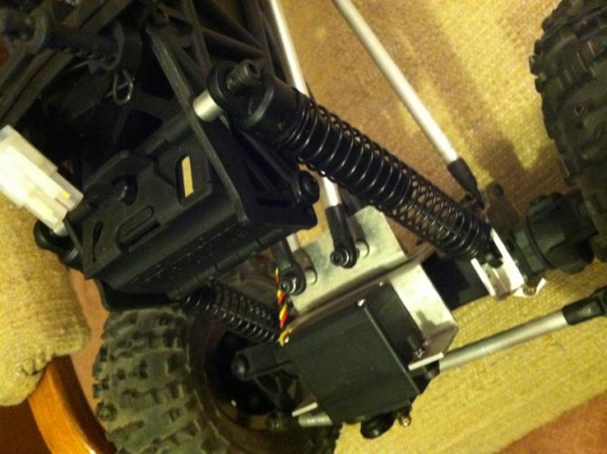

I just made a front servo mount using a template and made it slighty to small :) lol
Time to make another.
Stupid printer didn't scale it right!
Im not sure if this will help you but I made a template using thin cardboard and then out of aluminum.
Hmm that seem to be a better idea...... I have another template that is scaled right so I'm pretty sure i can make it....
I just need some aluminum thats the right size....
Right now I'm just using some thin steel.
Here it is as it sits
