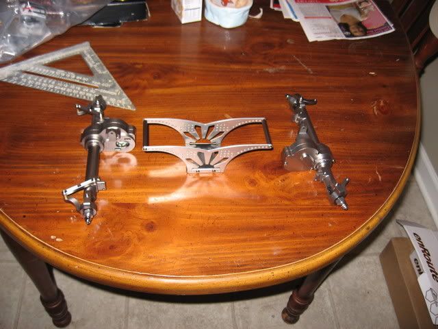

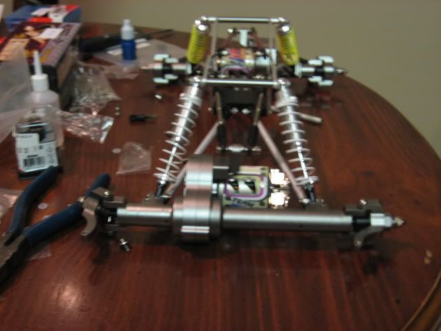

Here is my parts list followed by a few pics
Kamikaze Kustoms ZERO chassis
Berg axles
45t v-11 motors
CC Sidewinder ESC
CC BEC
Hitec 5955 steering servo

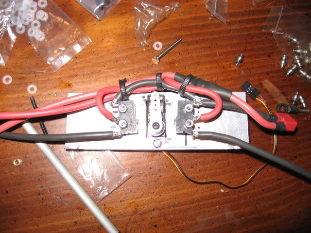

Hitec micro servo for the dig
Two micro switches
Ax10 bent lower rear links
Ax10 straight lower front links
Traxxas revo pushrod #5319 rear upper links
Traxxas revo pushrod #5318 front upper links
Jp Customs 90 mm shocks
Losi white springs front
Losi yellow springs rear
Nuts and screws from the Berg kit
Panther tires
DX3R radio

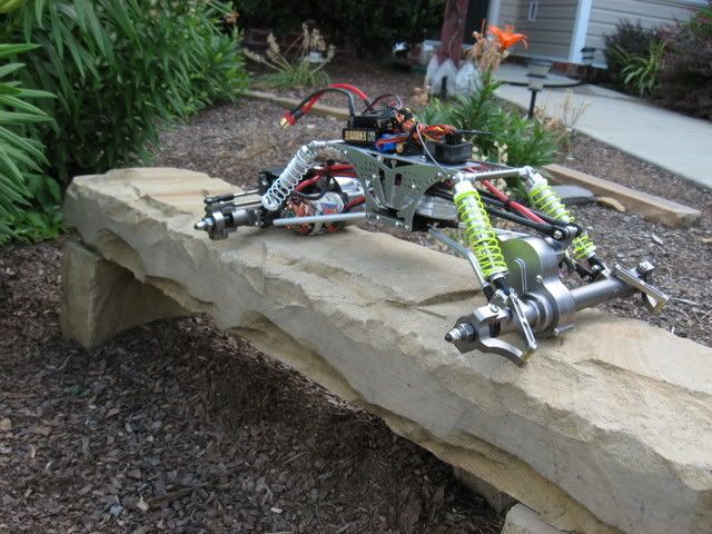

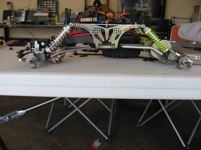

This build went together without a snag other than i can not find any wheels i can get my hands on quick.
With this setup I have just over 3inches of ride height and a 12 3/8 wheelbase. The suspension moves perfect and super smooth.The rear axle is clocked up as far as it can go without the upper rear links getting into the case at full flex and the front axle sits perfect for the steering.
I must say this chassis with these axles will be hard to beat .
Let us know what you think

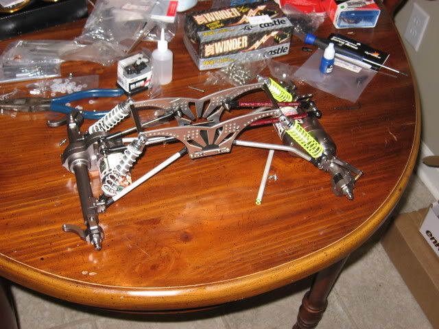

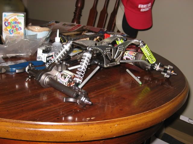

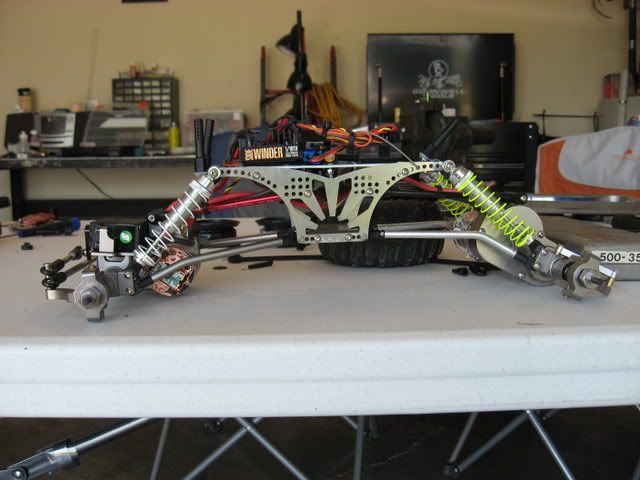

I was working on this rig this morning and the more i looked at it the more i thought it needed a set of bent links up front. So before i ordered a set i noticed that the stock Berg links are a little longer than the Axial links this chassis uses and light bulbs:idea: started to flash.
I took the links provided in the Berg kit and the set screws then replaced the Berg junk ends with normal Traxxas ends. The length of this allowed me to place the links in the vice(they are solid links) and bend them untill the wheelbase was correct.
So for people that do not have a set of Axial bent links and do not want to buy any this works great.
A few pics. The links that i made are the ones on the front of the truck.
