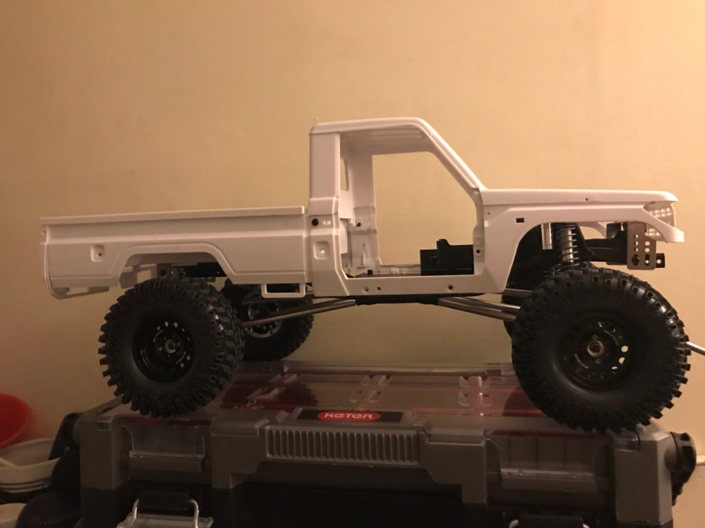

Hi all
Starting my first crawler build with a new RTR SCX10.2 coupled with the hot Killerbody LC70 body.
First on the list is to get the body lower but the stock shocks seem to be limiting how low i can go. Ive see a few people with what looked like a lowered setup.
Just wondering if anyone had any ideas
Will update this thread as i get into it.
You can buy shorter shocks or you can install internal limiters in your shocks to drop the height.
I think you should also invest in smaller tires. Those are too large for that body. You will have lots of body rub because the wheel wells are small and those tires are massive.

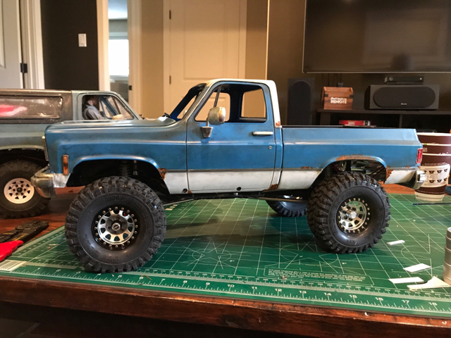

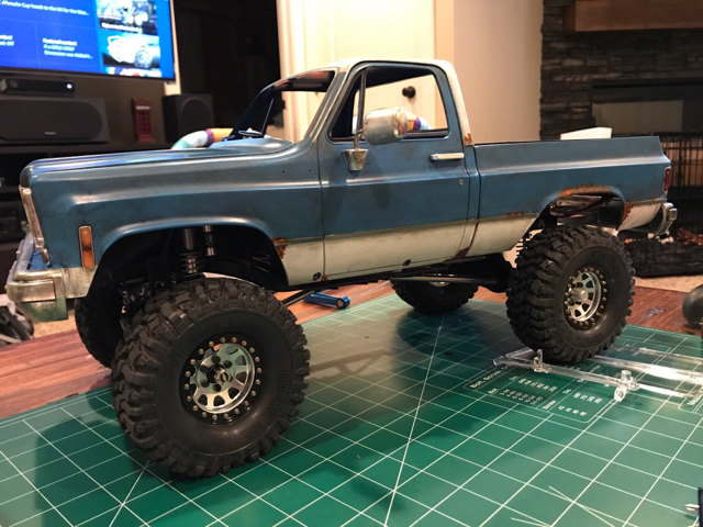

I completely agree with Jato. Tires are way too big. I faced the same problem on my build, went with the original size 1.9 Rock Beasts and it makes a difference.
I also had my ride height too tall for my liking. I limited the shocks 5mm internally to essentially drop them to 85mm shocks and I'm more than happy with the result. This truck goes anywhere!
BEFORE
AFTER

Managed to get the body lowered on the weekend, needed to put together some lower shock towers for the rear, thats already made a big difference.
I've now got rubbing at the front though, desperately need some new tyres

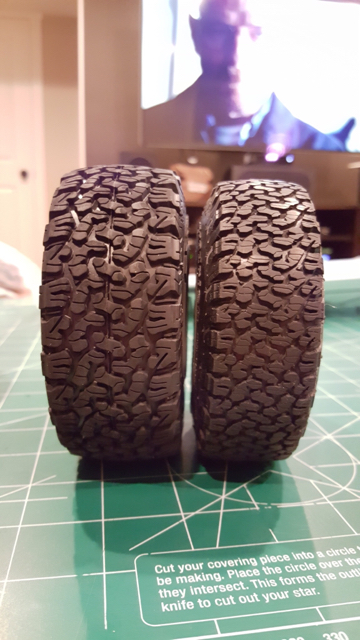

Run the Prolines then. Way better tire anyways, a little smaller, and very scale. The compound is much softer and sticker than Axials too.
Here's a comparison photo I took:
BEFORE
AFTER

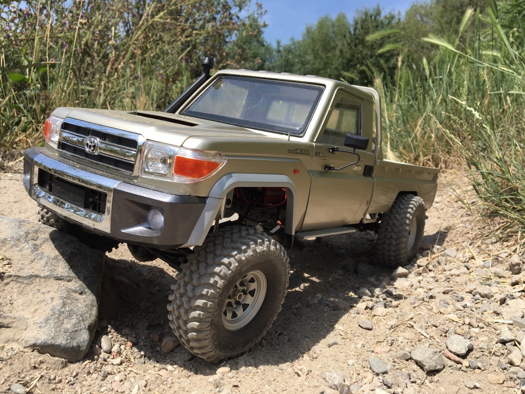

1.55's seem to fit this body a load better. Here's mine on a Trailfinder2, stock rims and mud grabbers (had to fiddle a bit to get it as low as possible).
I'm guessing you're having the most issues with the rear shock hoops. You might want to look for a cantilever shock setup for the rear on the 10-2, the rear bed really needs to sit on the frame rails, for which the 1.55's will help a lot (doubt it'll work with 1.9's).
Dinky link cantilever system for the rear! It's what I'm doing with mine on a scx10 1.0 and the bed sits flush
