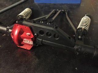

She got me
ARB diff covers
VP 10pc Ti link kit.

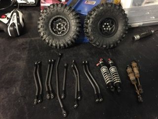

Pro-Line Powerstroke shocks- I had a set of rears I stole from my Slash so I only needed another pair of rears.
The RipSaw Tires that come in the kit seem nice and I really didn’t want to ruin them by gluing them to the kit wheels. I decided to buy some cheap bead locks from Axial until the VP wheels I want come off back order. The bead locks needed the SLW hubs, so I picked up some VP 475’s.

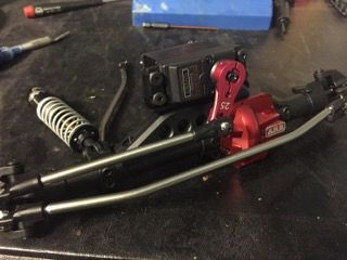

The first big dilemma was what servo to use. I really wanted a waterproof servo. I was not sure of what servo to buy and looked at Xpert, Holmes Hobbies, HiTec , Futaba and some others. Everything was out of stock or not water proof. I ended up getting a Futaba S9157. Lots of torque, waterproof and has Futaba quality behind it. I really don’t like the Futaba website and looking at the servo chart the only indication of a waterproof servo is a small “wp” in the servo specs. But a couple of emails to Futaba helped and I think I got a good servo in the end. To finish off the steering duties a Robotronics servo horn is attached to the servo. I did’t know any better and got the long horn. I had a little panic when I read that the long horn won’t fit at all. Fortunately when all together it clears the diff cover, but only just.

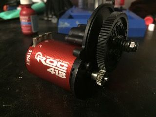

I read a lot about the ROC412 motor and how it can break drivetrain parts. My original plan was to replace parts as they broke. But it took so long for me to build this truck that Fathers Day and other present worthy event came and went. So my wife got me Super Shafty Beefy Top Shaft, RRP Slash slipper and MiP driveshafts. Also picked up some Hot Racing steel gears. Should be bulletproof now.
I took this photo before I installed the upgraded parts.

I decided to to the stock driveshaft mod, put the female shaft on both ends and cut the male drive shaft half to go in the middle. I got to the point of installing them but not quite to gluing a metal dowel in the male half and then my wife gives me the MIP drive shafts. Now I can go install the MIP and take off the never used stock shafts.

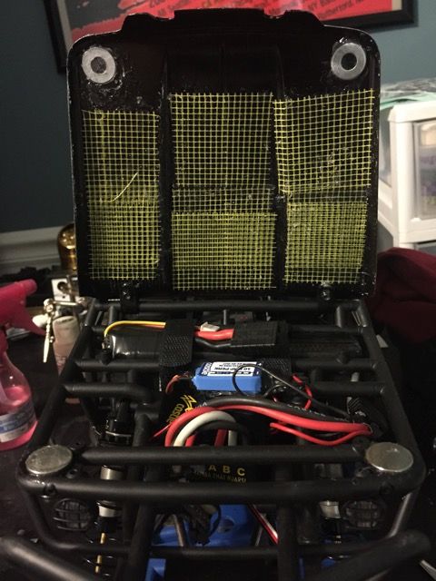

My battery is pretty big so it rubs the hood. I layered some drywall tape and shoo goo to prevent the paint from rubbing off. Used magnets and washers to secure the hood. I think it has a nice look when closed.
there seems to be several options for waterproofing the electronics. CorrosionX and Conformal among others. I settled on CorrosionX.I dipped the MMP and the motor sensor board. I used liquid electrical tape to seal the ends of the BEC. Starting the build I wanted to achieve fully submersible (for a quick creek crossing or the like). But the deeper into the project I got, I decided that I am going to try to avoid water. I'm glad that I have a water proof servo and that the ESC but I consider it more splash proof now.

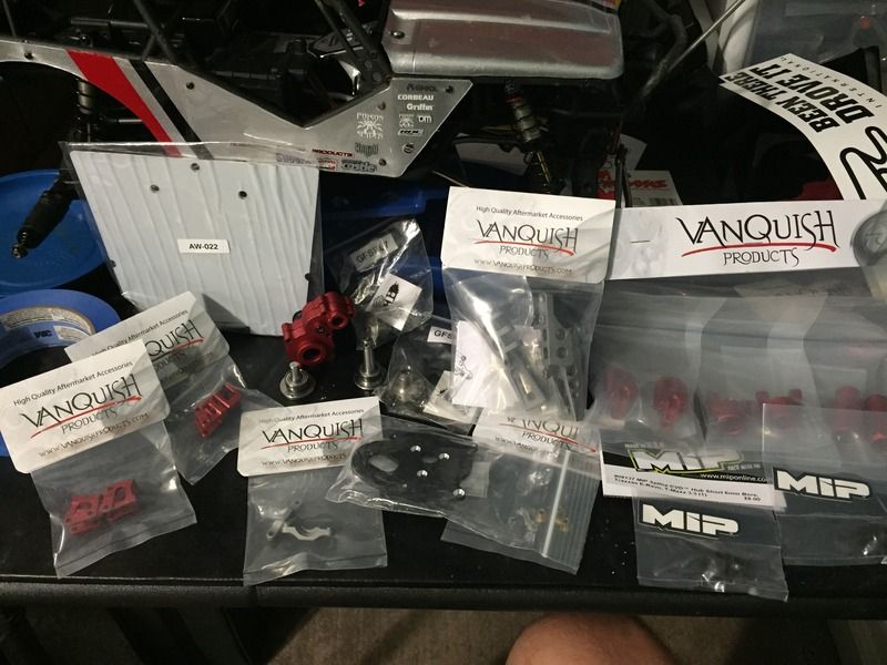

Happy Birthday to me! Had a great b-day. My wife and mother in law are great! I'm busy installing these parts now.
Oh man that's a good feeling. I love getting a box full of new parts and I love VP stuff. Enjoy!
It was fun installing all the parts. And it looks great. One thing I am not impressed with are the small screws that attach the axle truss's and rear lockouts/chubs. Super easy to strip the plastic axle housing with screws. There just isn't enough plastic to screw into. I think I will want to get some BeefTubes just so to have some metal in there and get some machine screws.
The VP axle lock outs and chubs are really nice. They fit the end of the AR60 really well, almost a press fit. Their brass bushings for the steering knuckles provide slop free movement.

Although you can't see it when installed, the VP red AX10 transmission case looks very cool. It is fully bombproofed HR steel gears, SS motor plate, 6mm outputs and Beefy top shaft with RRP spur.
Unfortunately the servo has not proved to be bombproof. It has great specs and from a quality company but the gears striped with only 2.5 hours of use.
I emailed them to see about a warranty.
