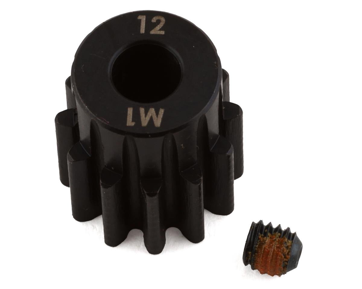

TRA6482X - Traxxas Machined Mod 1.0 Pinion Gear w/5mm Bore (12T) to gear it down two teeth
www.amainhobbies.com
Traxxas Machined Mod 1.0 Pinion Gear w/5mm Bore (12T) [TRA6482X]
Traxxas Machined Mod 1.0 Pinion Gear with 5mm Bore. This is an optional machined pinion gear intended for the Traxxas E-Revo 2.0 and the Traxxas... TRA6482X
