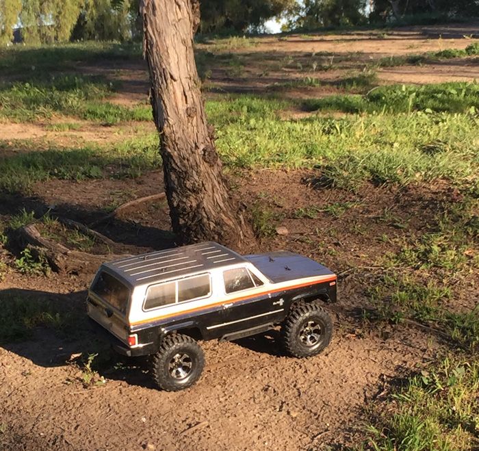

Took the Blazer out for it's first hard crawl today. It did very well with the body being so huge and all the bumper overhang. Not as good as my 2017 Wrangler but it has a few mods and is 3in smaller and 1 1/2in narrower. But still very happy with how it ran. Decided my tire/wheel combo for it is the proline BFG krawler T/A 4.75 on plastic Incision wheels
I took the classic alloys off my wrangler and put them on the Blazer - whoa, these are the shiznit, and the sx pitbulls are a perfect size. This thing actually crawls pretty good now - weighted front wheels helps as does the wider tires. They stick better too. Shortened both bumpers at least a quarter inch, trimmed the body to fit, and put all metal pivots in the steering linkage - they had too much toe-in. Checked all the screws - lots of not so tight fasteners. Suspension preload is backed all the way off. Who says there isn't TT on a Axial - HaHa.. 3S works just killer.

As promised...I have to re-size my images before uploading them to photobucket - they don't do that automatically anymore. If I use the online program to do it they get all pixellated. So here are a couple of decent resolution of my Blazer updates...
Sucked the bumpers in, front and back. Had to trim the body some for both bumpers, mostly in the corners, but in the center as well for the front. Shortens the whole rig by just over half an inch and improves approach and departure quite a bit.

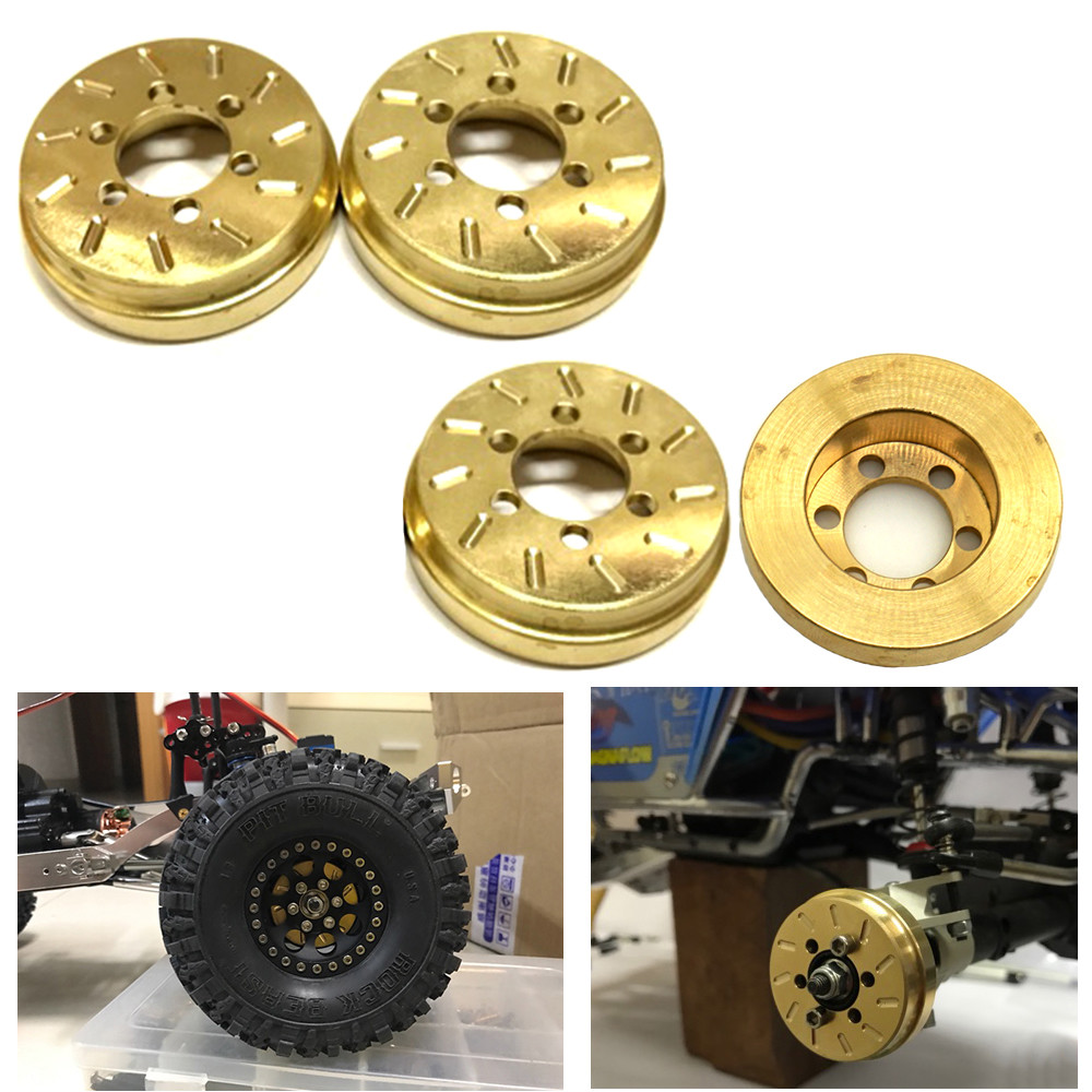

The Pitbull SX are about 4.5" overall with a lot of tread so they're darn close to the stock ones, but much wider, way more grippy, and IMO the MT Classic style slotted mags are just ideal for this vintage. And the fronts have the brass discs that look like rotors and add a couple of ounces to each wheel - really helps with uphill traction.

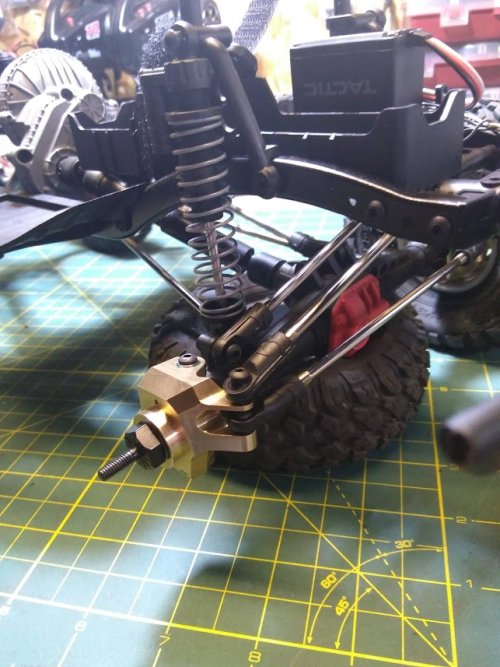

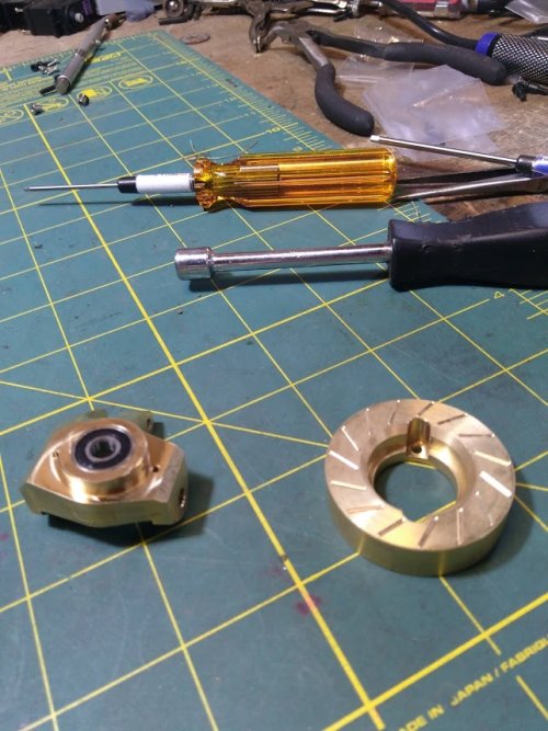

Did some improvements today . Brass parts and ebay wheels ,, On a budget for this one to see if I might keep it , The HR brass knucks are nice ,The weights needed a litte work from my lathe to get wheels to clear, Lower the weight,, Looking at moving battery to high for my like-in,,

I was looking at the same parts online...good to know they fit this version of scx10. "thumbsup"
Where did you fine the brass bake rotors? I haven’t been able to locate any.
