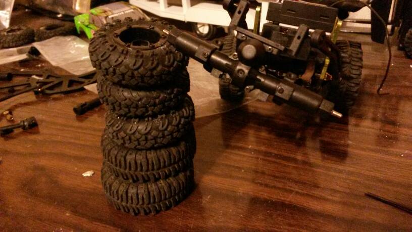

I put the Hsp's tires in the freezer overnight and I can't get the tires off.The glue is stronger then Losi's and the tires sidewall is thinner so I stopped at the first sign of a tear.I guess I'll have to buy new wheels to mount my Mickey Thompsons but at least I'll have these shorter tires mounted on wheels I can swap to either truck.If they fit I would like to use them on a sct.Has anyone tried mounting a crawler wheel on a sct?
I believe the sct uses a "D" shaped hole with no pin or hex, so I don't think they'll mount up. That sucks the glue won't give, I was interested in the tires for scale builds. It has a cool tread patern. You ought to get some DDT wheels for your Mickeys. I have three sets, and I just love them! And Danally is going to be, or already is,selling them with beadlocks.
Good call thank you, I remember his motors but I forgot he made wheels.You might still enjoy having the Hsp tires, they would look great on something smaller like a Jeep or Yota and for how round the contact patch is they grip well.Either the foams are precut or they barely rise into the tire above the wheel, they wrap around rocks like no foams.Id be happy with them if I could get a bit of weight inside.The fake beadlock is molded into the wheel as one piece including the screws so it seems like there is twice as much rubber glued to the wheel.Maybe I can glue large washers on the back to get a bit more weight.Once you get used to thinking about your axles catching, these tires are fairly capable as is since the ride height is lowered.Pro's and cons.

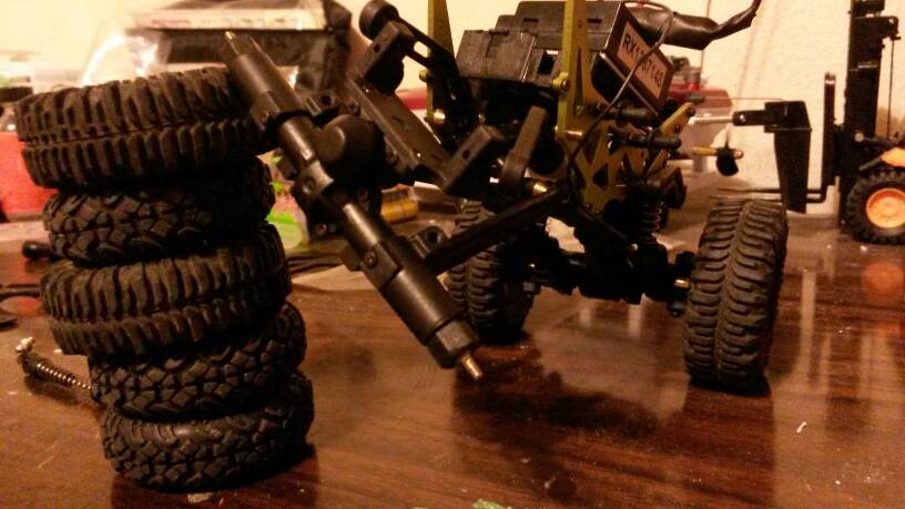

I think the suspension would operate better with longer upper links.The ones on the bottom are longer so when you lift a rear tire the upper link tries pulling the tire forward a little instead of allowing it to rise straight up, making the shocks bind.I'm pretty sure its a copy of micro crawler parts, then when they extended the wheelbase they only extended the lower links.I tried running a droop setup and it articulates smooth that way but the links pull the wheels forward to badly to use.Im honestly not very worried about it though since its so stable on off cambers, the springs bind before they compress enough to case a roll.

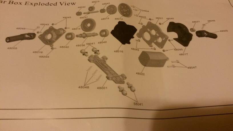

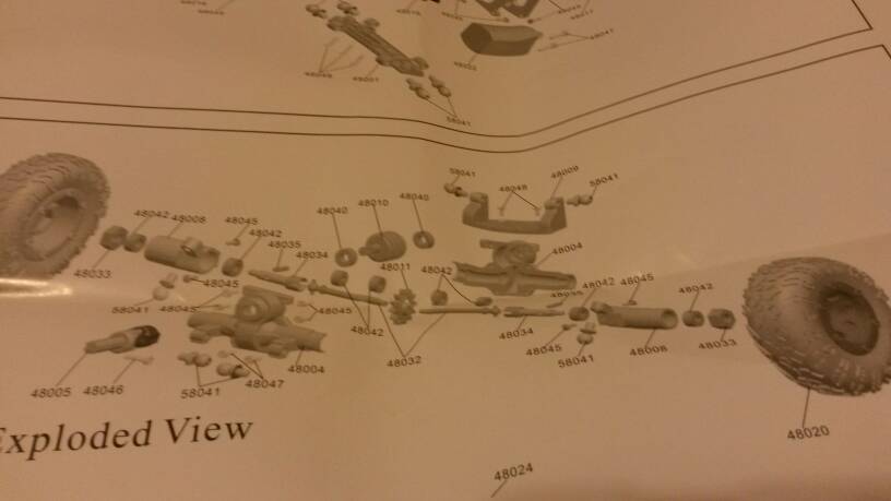

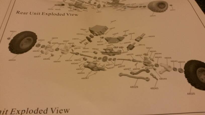

While I was taking these pictures I noticed it shows straight upper links the same length as the lowers.The ones on my crawler look completely different so hopefully they were using up old parts or something and the later versions are corrected.

No the tires are alot smaller, not good for ground clearance but a blessing for scale guys.I posted a picture of them with Rc4wd's Mickey Thompsons.

While it's apart I decided to have another go at getting more articulation and I had some success.I noticed the Hsp links were slightly thicker then Losi's and they weren't able to twist, they were acting as a hinge instead of a ball joint everywhere there was a short ball stud.I replaced the short Hsp ball studs with longer ones from Losi and it still wasn't right.The next picture is with the upper links in stock position and Losi ball studs.
The lower links were inside of the mounts on the axle.I flipped the ball studs so they were outside of the axle mounts.Then did flipped the ball studs on the upper links inside of the frame and I ended up with nice smooth articulation.I just need to add rubber bands now to limit it.The rear end just wants to twist now without springs instead of moving side to side or up and down, it actually seems perfect.
