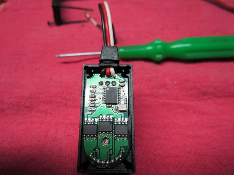

Will these controlers work with the new brushless servos like the turnagy 910.
If the servo motor is truly brushless, then no. The controller works with DC motors.
If you have one of these servos, open it up and see if it uses two or three wires to power the motor. Be aware that some DC servo motors have a wire going to the motor case - this is just for RF noise suppression and these motors really only use two wires to operate.
Try powering the motor with a few volts and see if it will run.
If you want to send me one of these servos, I will check it out for you. Send me a PM and we can sort something out.
I'll pull it apart again to see if there are three spots on the board, The board is connected to the motor.(no wires)
Those ones are harder to take apart. Solder braid or a desoldering tool of some sort would be good. Otherwise, get the pad hot and smack the servo sharply onto a board or something to try and get the solder off the pad.
Good luck!
My guess it's brushless.....
