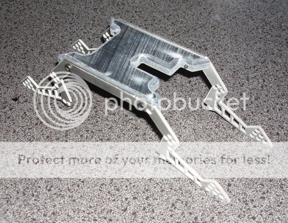

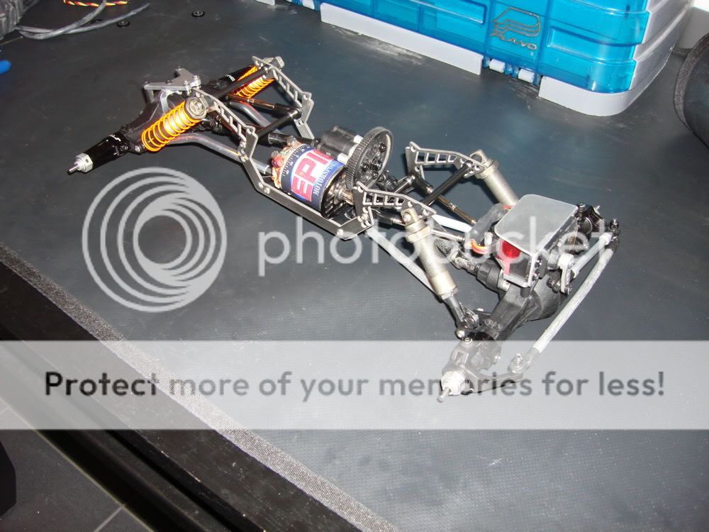

So after running the stock chassis for quite some time I decided it was time to step up my game. I gave in and finally decided to build a new El Nino chassis based rig!
This one is actually made of .071 grade 5 titanium! so actually it's a Ti NiNo!
specs are:
axial axles
axial trans w/ vf dig(soon to come) hitech 645
45t Epic motor
jr ds8711
BEC
Tekin FXR
Custom Cut bent lower liinks in rear
Custom Cut front lower links.
jato 61mm turnbuckles for uppers with revo ends
tcs 4 link plates
mayhem wheels(new)
losi rock claws but new HB rovers awaiting wheels..

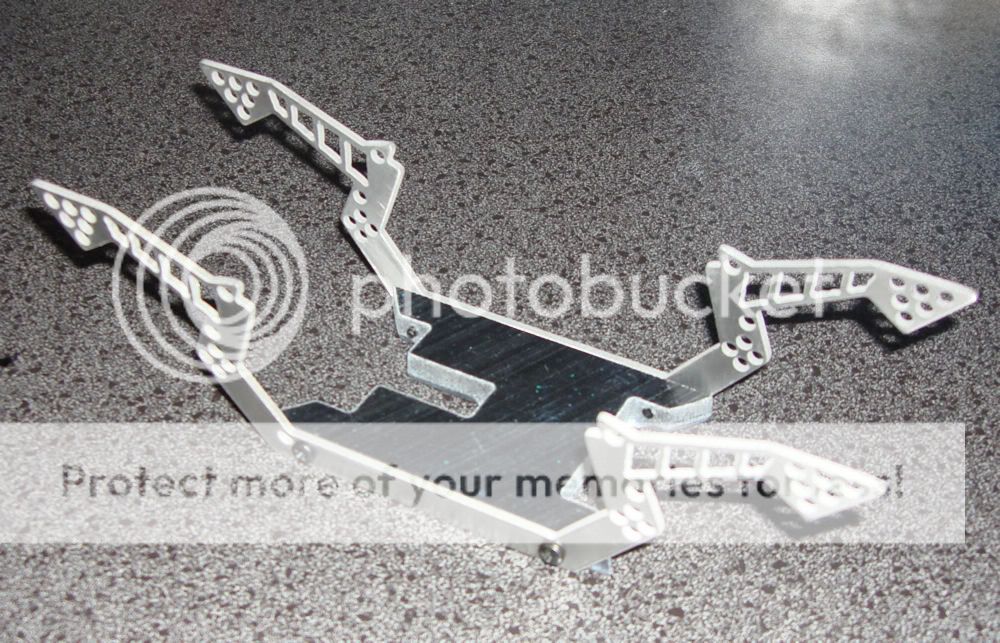

I took the Chaotic Crawlers El Nino and modified the skid just a bit. I did a lil Jenny Craig on it down to 60mm so i could use Axial Chassis rods. Then i 1/8 rounded the entire bottom to prevent any hang up..

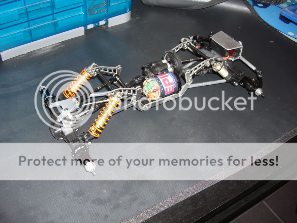

Few Starter pics so far. Will Update as it advances....
Since i just love the look i decided with the Mayhem 7's.....All Aluminum...
And i picked up a set of the new HB Rovers for tires
Normally i stuff them with the hybrid mems but for the winter i am running the allweather hybrids from rock hammer....So far so good...
GOTTA love the camera phone crap quality...haha

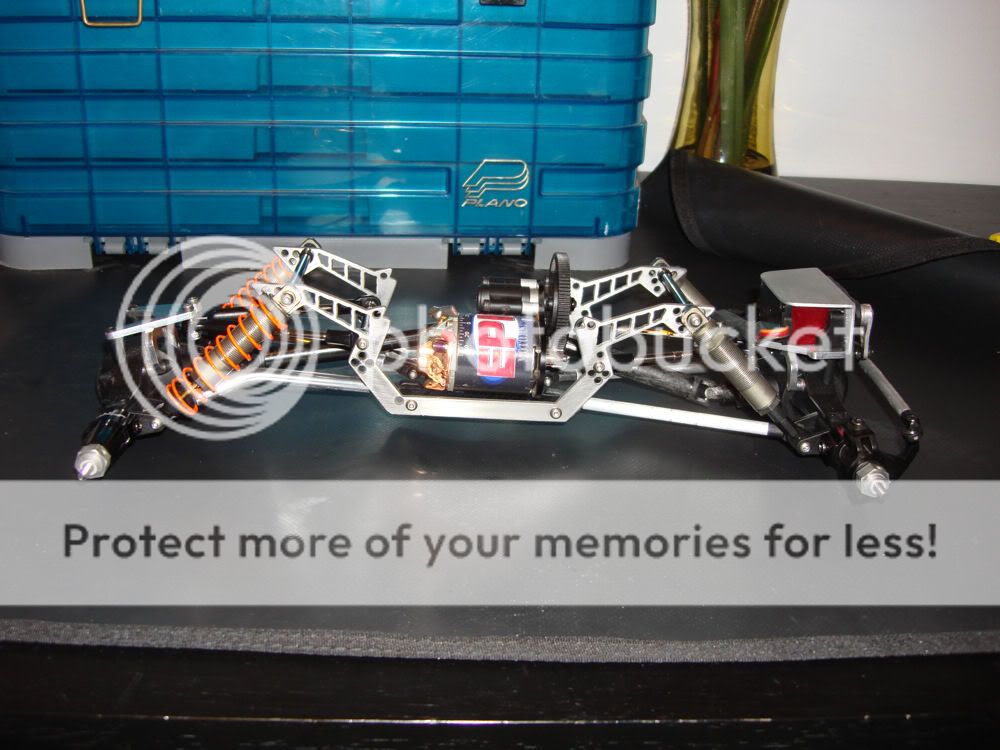

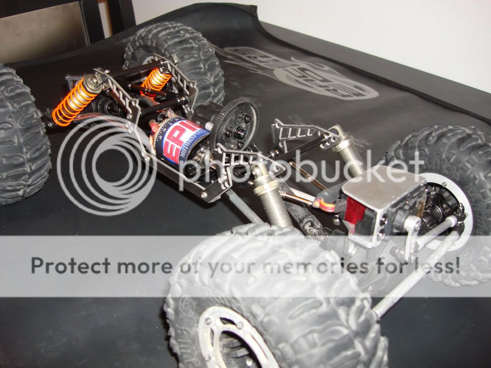

Ok I got it into a roller.... I wanted to keep the bent rear links so I ended up using my old links and just cut them down, drilled, and retapped em... The suspension height took some tinkering to get it to sit right but i have it now right where i want it. Other than i want to put some internal springs in the front and change out the rear springs with some red's to gain more flex in the rear. Because this chassis is so much more narrow than the stock one i think i am gonna struggle with electronics some....Especially my dig servo since im throwin in a full size...
Any way on with some pics...

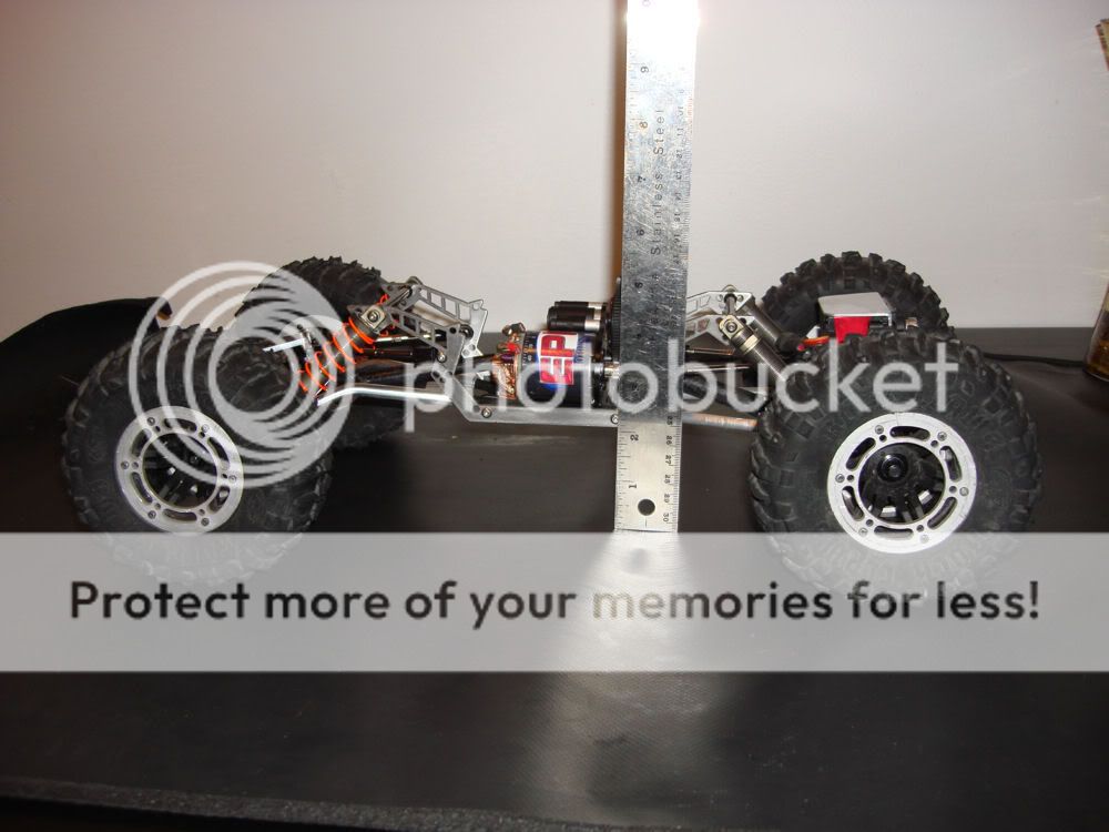

Got my belly right where i like it...even on 2"

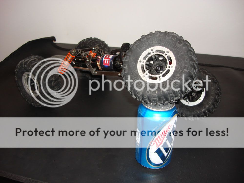

And of course cant forget the miller flex shot....That can is max flex on this beast...
Pics taken with old stock shoes...

2" is exactly where you want it sitting for our terrain!
mine was at 2 1/8 but I dropped her down a hair tonight like this rig!

Ya I took it out for the first test and it is amazing beast. I was quite pleasantly surprised. Like chaotic mentioned i did some lines that i have tried for days. It was sweet. I just took it out as-is tho. So now i am going to finish it up by putting on the dig and a few other special items. But i am looking forward to the possibilities this thing has. There is so much sidehill that 2" is perfect. I ran a bit taller before and it is kind of a joke. It tips way too much. I will post pics as i get it done and am looking forward to more great products from Chaotic Crawlers. Once these chassis are available i would definitely recommend them to anyone. Like night and day..

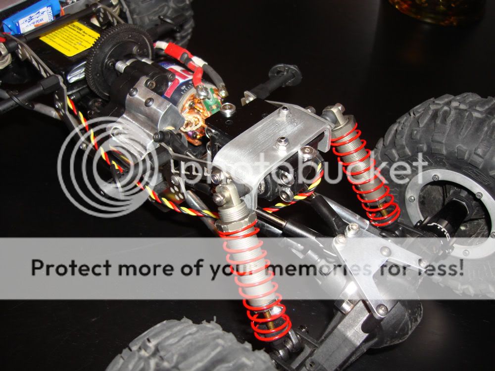

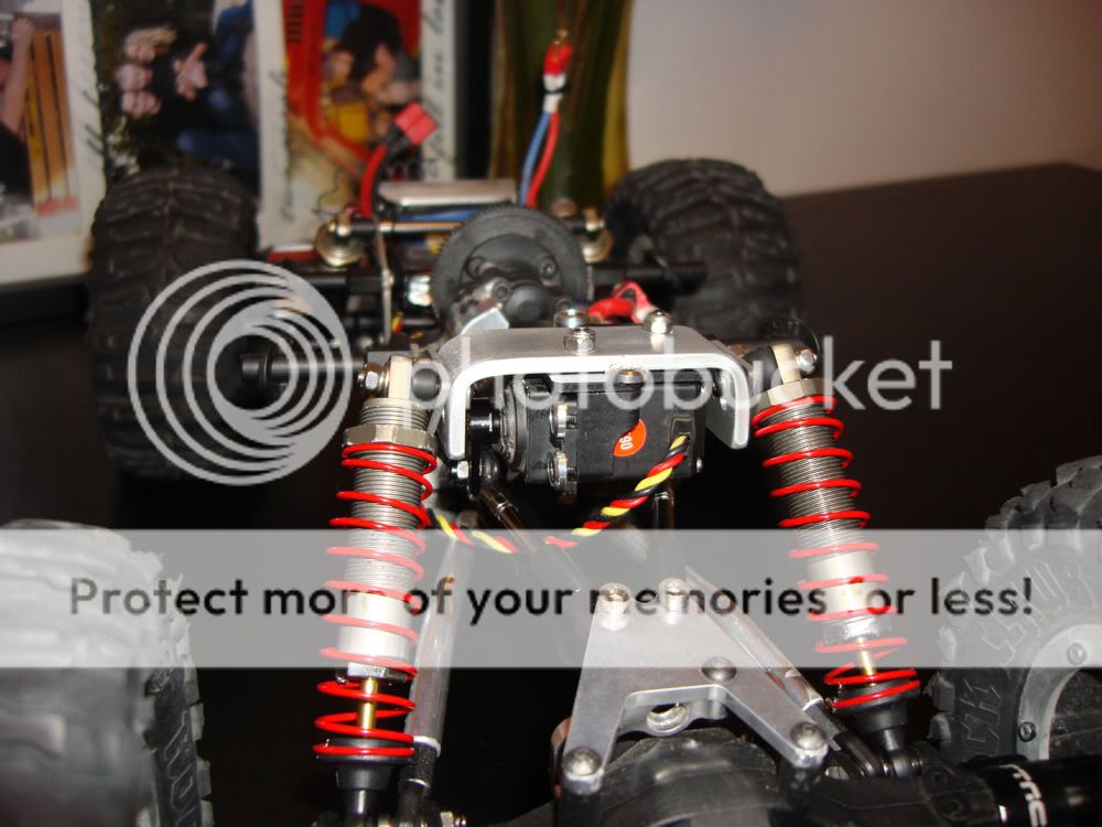

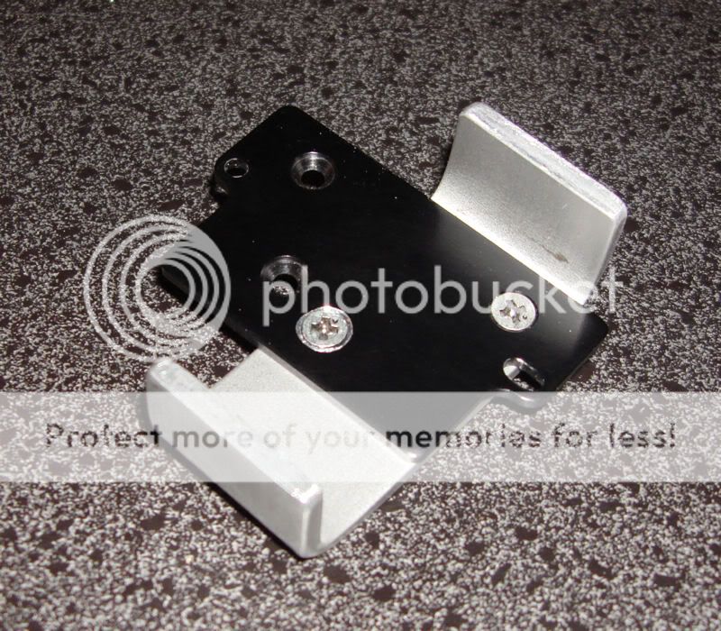

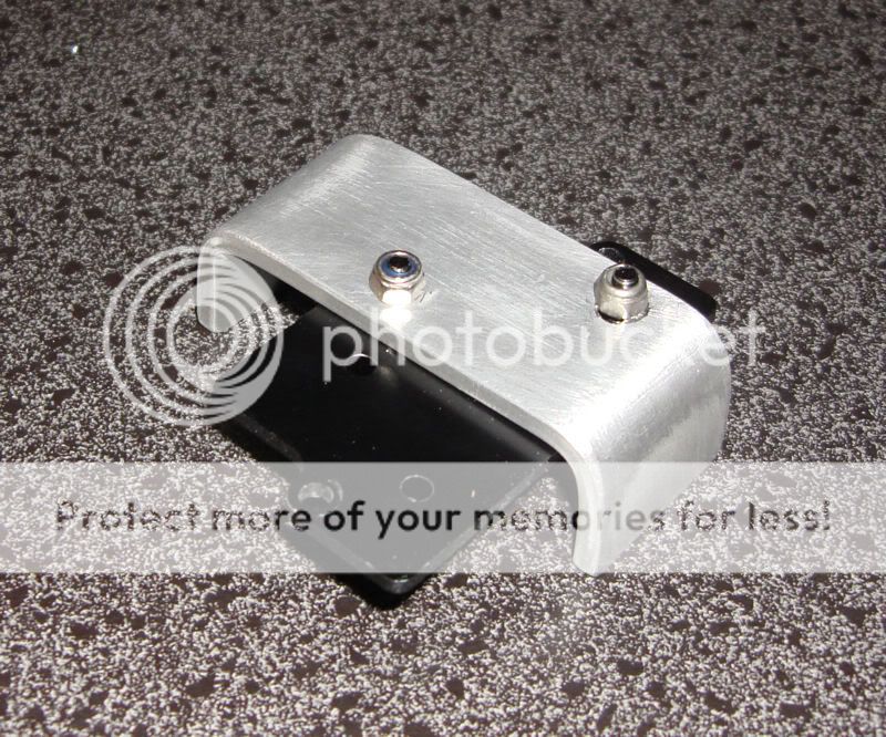

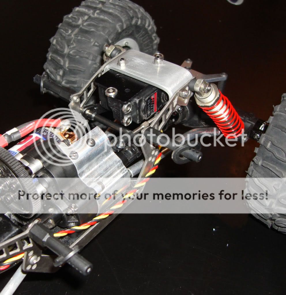

So While i am awaiting my new black DNA dig, i borrowed one temporarily so i could not only run it but mock up my custom servo mount. I really wanted to run a full size servo so i could gain a little more power. I currently have a Hitec 645 in there and it seems to work good. I will have to test it out on the rock to get the official test though.
Pics of the bracket and installed....
That is a tight squeeze with that dig servo. What does the chassis weigh since it is Titanium? Looks good!
Ya it is pretty close...but i wanted to get the servo as low as possible...there are no rubbing or grinding issues so im good with it. I am not sure the weight but it is extremely light but very strong. Maybe contact chaotic crawlers they might have an idea on the weight.

i love the thick material you used for the mount.
mine is way thinner and i think I need to use something thicker like that!
