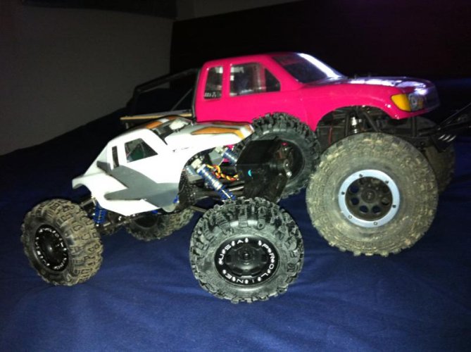

Well it's been a little while, i figured i should pop some pics up.
First is how it looked until this afternoon, pictured with my SCX10
Added Proline wheels and Chisel tyres, with MIP driveshafts since purchasing.

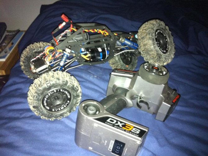

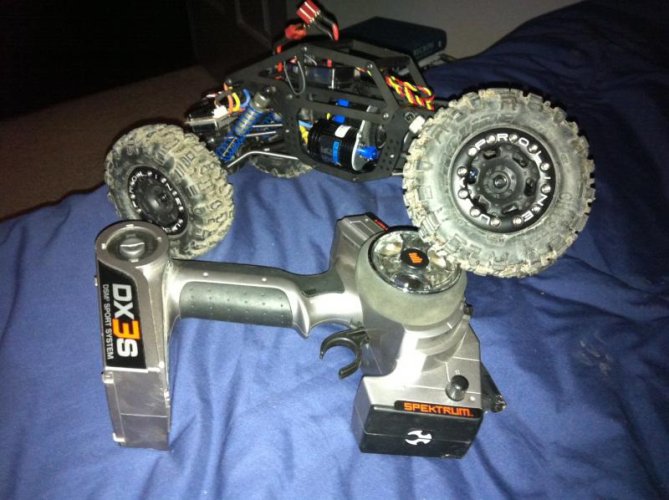

Second two are how it looks tonight, after adding on a Chaotic Crawlers bodiless chassis and Ti upper and lower links.
It's 10pm here now, so i only got a chance to make sure it drove straight, but tomorrow it's off to the rocks!

Perhaps a little. But the cross braces on the pro are aluminium, where the CC are Delrin. Not sure on the weight difference there. With no lexan body though i think the CC will work out lighter than the Pro.
