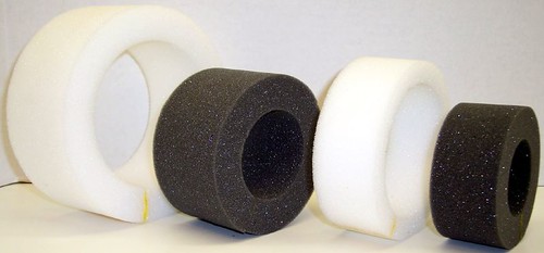

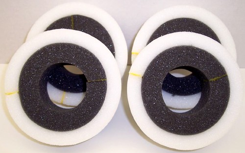

These are CNC cut, 2.2 and 1.9, dual stage foams for rc rock crawlers. The inner foam is a very stiff foam while the outer foam is very soft. These are cut from conventional or open cell foam. They are not memory foam and are not temperature sensitive.

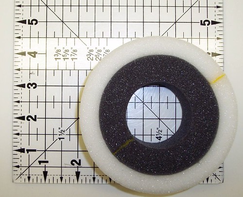

A single 2.2 foam weighs 0.8 ounces complete (less than 1 ounce).
The 2.2 foams measure 5.5 inches tall and 2.25 wide.

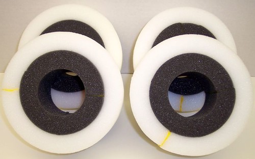

A single 1.9 foam won't even register on my scale they are so lite.
The 1.9 foams measure 4.25 tall and 1.50 wide.
Here is a size comparison photo between the two foams.

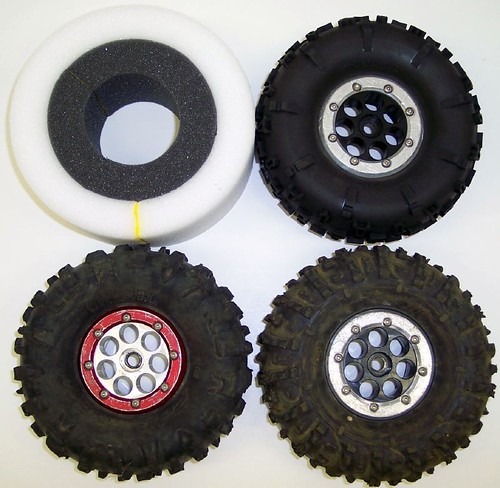

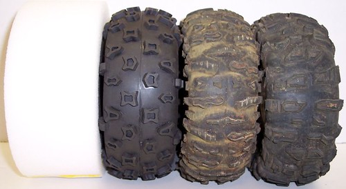

I have the 2.2 foams installed on my berg with Hot Bodies Rover tires. This is the best foam combo I have ever tried with Rover tires. They hold a side hill fantastic and I was able to complete lines not previously done cleanly before. I also have the 2.2 dual stage foams installed in my son's berg with Pro-Line Chisel tires and they work much better than the previous foam set up. Both bergs are using Mayhem 7 wheels. As stated, these foams are very lite weight which will help for those looking to go liter on there comp crawlers.
I am using the 1.9 foams in my Hilux Bruiser hybrid scale crawler in Pro-Line 1.9 Flat Irons with Create A Crawler bead locks and they perform wonderful. I am also using them on a 1.9 Losi MRC with VP bead locks and my custom 1.9 cut n shut Panther Cougars. The 1.9 foams made a night and day improvement for both sets of tires on both trucks. The scaler needed sidewall support because of the heavy weight of the crawler and the Losi MRC needed side wall support because the Cougars are so soft.
As you can see from the picture, the foams all have a seem on them. The reason is because they are CNC cut and the blade needs a way in and out. The foams are shipped out pre-glued using a foam specific adhesive supplied to me by the manufacturer.
