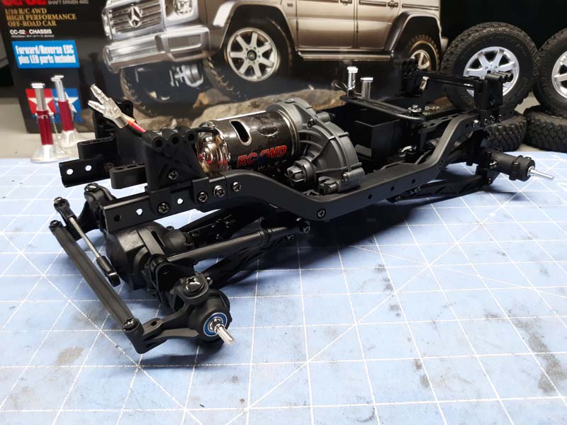

Front and rear assemblies completed, and ready to mount to the chassis. You have the option of mounted the servo laying down or upright - I chose to mount it upright as it puts the arc of the servo in line with the axle.
And mounted up....
Transmission drops in from the top and is secured via 4 screws from the bottom coming up through the chassis into the glued nuts inside the transmission.
A closer look at the overly complicated extensions with all the inserts....

Just one more chassis addition before moving to the axles - the lower link mounts. Both upper and lower link mount to a single bracket, of which 4 are attached to the chassis. They are offset slightly, and have 2 mounts so they can be mounted 4 ways. Lots of wheelbase options.
Time for the axles! Same gears as the rear of a CC01 so the axles are 12/22 geared for a 1.83 ratio. Of course they can be built with the diffs open or locked (locked in the same manner as well as a CC01 with plastic inserts) - since I'm building for the trail, I locked up both front and rear.
No bearings needed in the axle housing here for shims, the gears fit nice and snug. I didn't shim a thing.
The knuckles are designed different, but use the same axle and bearings as the front knuckle of the CC01. I didn't test fit, but I'd be willing to bet the CC01 knuckle will bolt in here, though the steering geometry might be a bit off. If that bolts in, then Dynahead portals should bolt in as well. Hmm....
Front built and ready to go. About 34 degrees of steering..:shock:. hopefully some CVD's are in the works.
Moving to the lower links. One thing I was absolutely not a fan of is the plastic pivot balls. They are attached to the sprue right smack in the center of the pivot ball. They need to be trimmed very carefully to pivot properly. Eventually, these will get a metal replacement of some kind.
Nice to see a proper rear axle. Unlike the TLT, CR01, and F350 there's no steering knuckles out back, and no lockout required. If you like 4 wheel steer, you'll have to purchase a complete front axle.
All links made, and both axles complete... something looks off up front...
Yup, that can't be right.
Turns out I was not paying attention as well as I should have and bolted in the front axle upside-down. I had to remove all the link mounts and steering links, flip the axle and re-mount. Whoops!! After some re-assembly, we're looking much better!

Mounted to the chassis...really starting to look like something here!
Of course, I always do some break-in on the moving parts. About 5 minutes on 3V in both directions to seat the gears, spread the grease and check for any issues. Driveline is smooth and silent, as expected from Tamiya. Couldn't resist bolting the wheels on check it out.
Standing on the wheels.... Chassis has a lot of flex, more so than my CMX and CFX twins. Suspension feels great on the bench, oils and spring rates are spot on.
If CVD's are eventually an option for more steering, Some narrower shocks will be needed. Everything just clears as-is.
