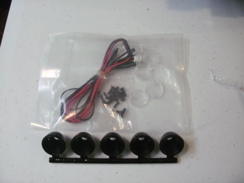

i start with a basic r/r light kit from china, it was about 11.00 usd
whats nice about its 1/10 scale and it plugs right into your receiver or a 4.8 battery pack

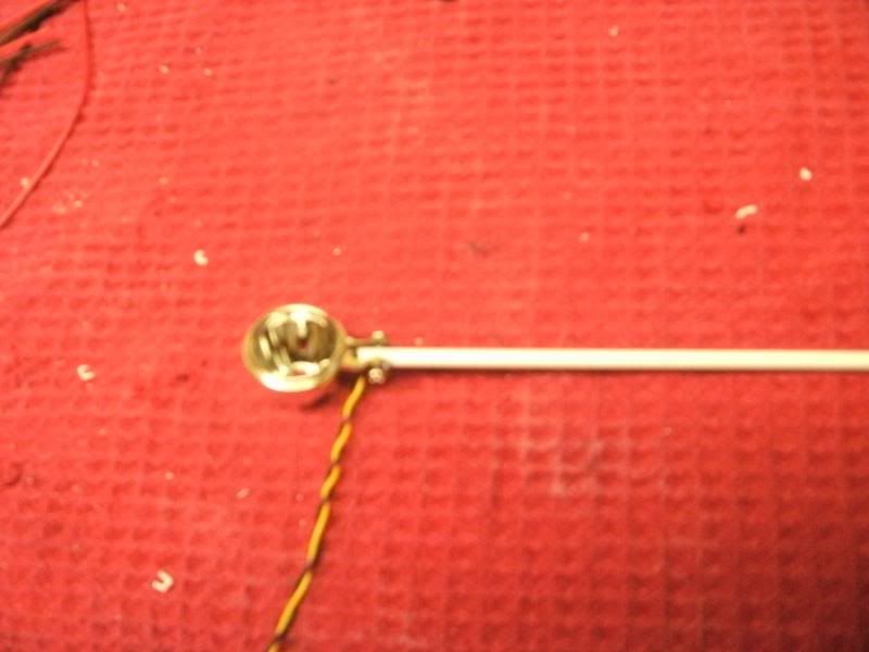

next i cut each light bucket from the main light bar, keeping the main bar as a part of the light bucket. next i cut a hollow round plastic tube for the neck, next i drilled a small hole in the tip of the tube and the light bucket , this will let the light buckets tilt
next i ran small wiring through the rod and attached the light buckets with 2 micro screws
next i cut 3 pieces of shrink tube and cut one of the lights off the main
ok, this is how i did this end of it, now i have to make 3 more, after this i will show you how to do the other end of it

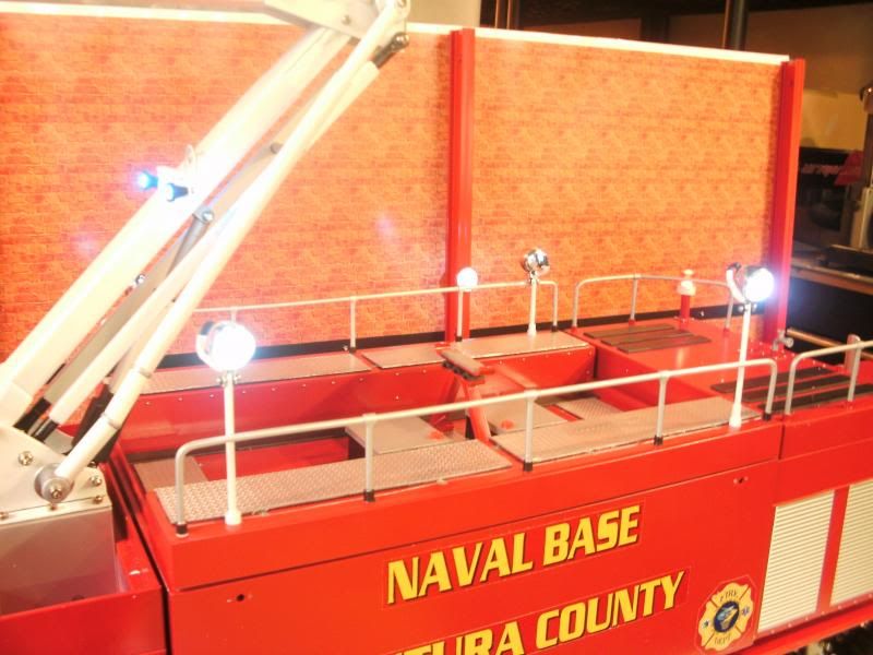

the search light are up and working
the boom lights are working also
