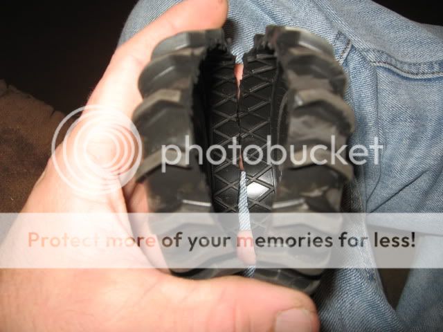

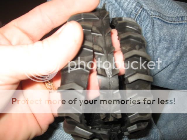

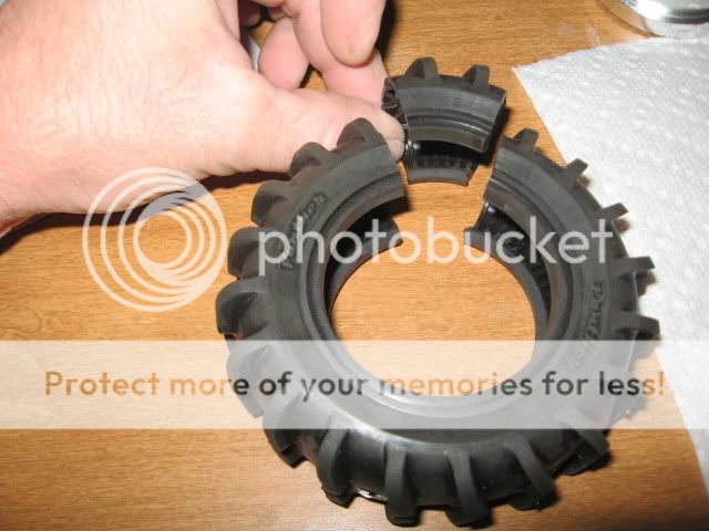

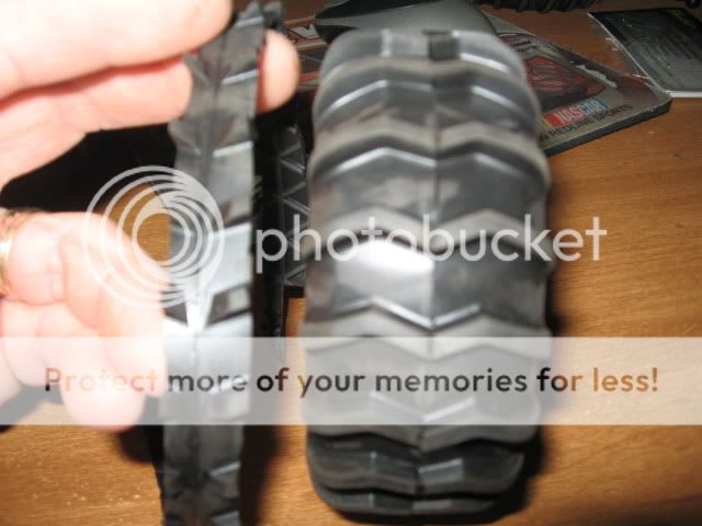

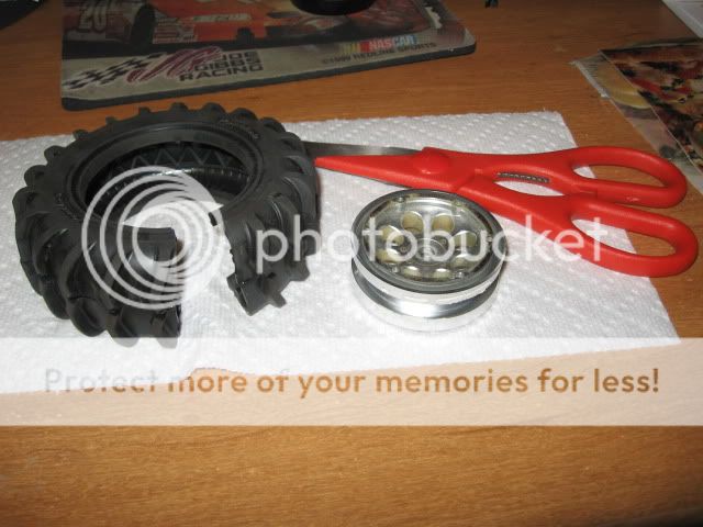

First I took care of the width of the cobra but cutting out a 1/2 inch out of the center of the tire and glued the 2 halfs back together.
Here's a shot of the factory cobra next to the cut one.

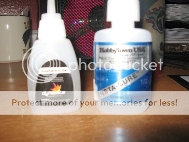

Here's a shot of all my MRC tires together and the glue I used

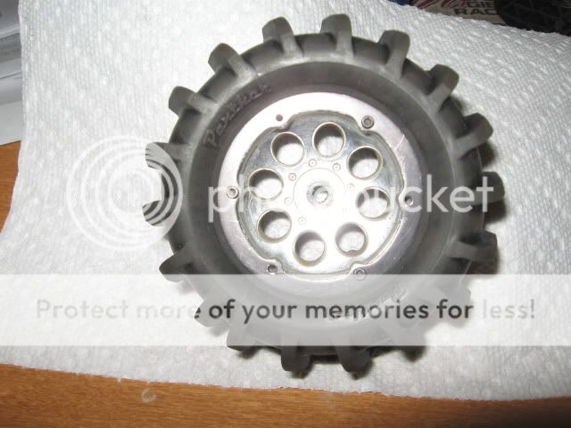

Well i managed to get 1 tire done and mounted up on a rim I'm useing my Axial 1.9 rims and have stuffed a losi memory foam in for support. I must say I was nervous to cut up a tire and put it back together but to my suprise it was kinda easy:shock: I guess just take your time measure twice and make your cut:mrgreen:

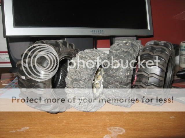

Make sure when you make the cut to reduce to 1.9 cut where you wont cut through the logo on the tire. Here's the pictures on my very fist cut and shut cobra!

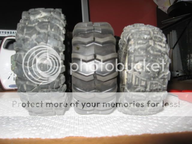

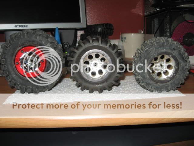

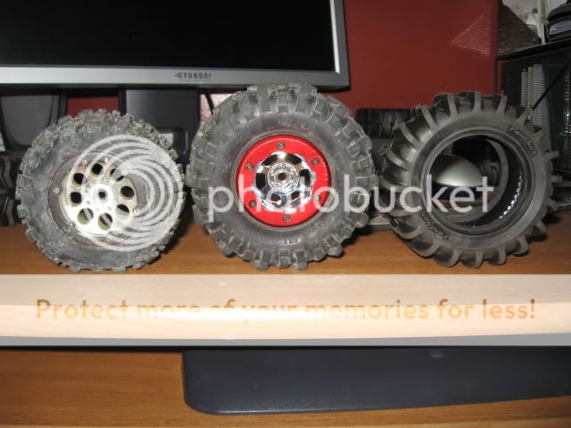

Here's some comparison shots of the cut cobras and the proline brothers!
As you can see the cobras are just a tad taller then the chisel. I was shocked I thought they would be a good middle between the two. but now It's time to finish glue and finish the rest so I can go test what is allready a great tire!

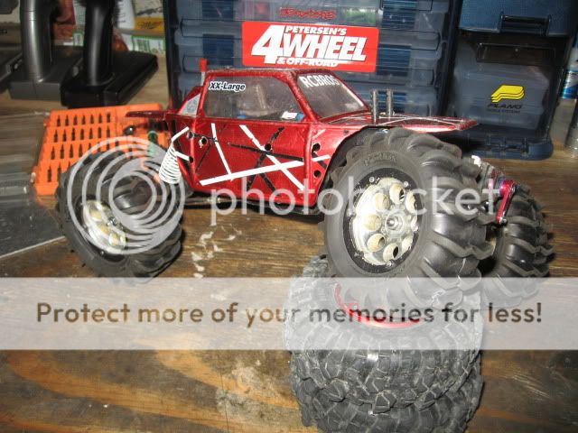

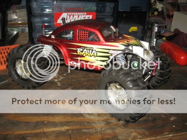

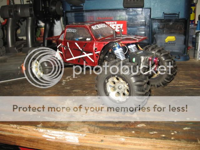

All mounted up but no testing yet...Wife says I've been spending too much time F'N with my trucks:?....whatever Headed out monday with soundcolor to give em a good beating but here's some pictures of them mounted up.
This is my Mini Monster Baja body (MLST2) still trimming the fat so to speak.
Very Nice!"thumbsup" Are those MLST2 shocks as well? Looking to get new shocks myself - how do you like those?
Looks great, let us know how the testing goes:)
I think that you have your shoes on backwards. Let us know how they work mounted that way. I have mine mounted opposite and I really like them."thumbsup"
I'm running the stock MLST2 shocks and I bought the white soft springs. very happy with them. I'm gonna try running the cobras both ways and if your wondering I have the Losi memory foams in for support!
