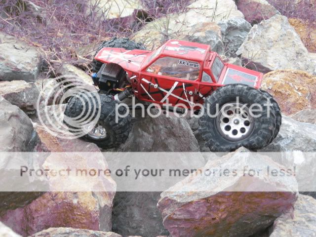

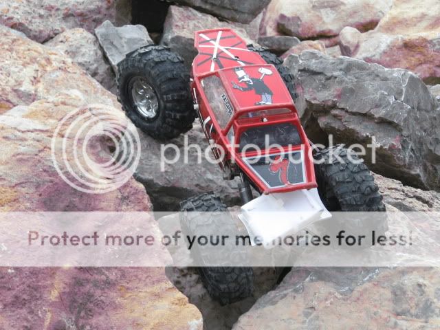

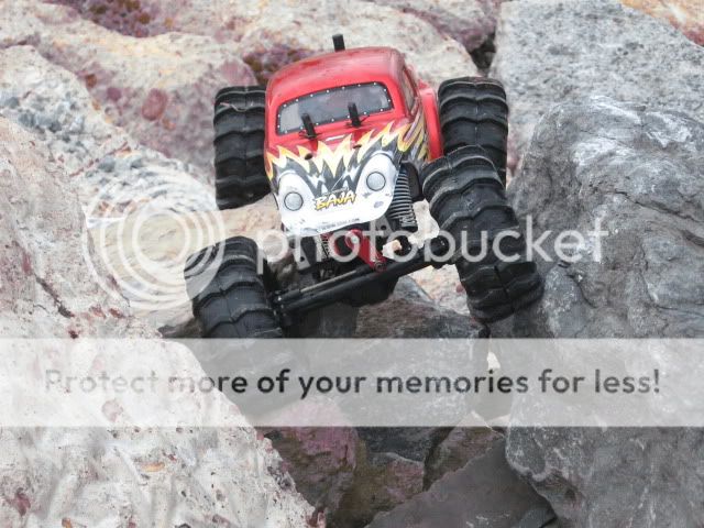

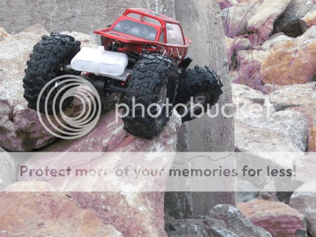

Soundcolor and I went out today and he's running my Frankenstein Body and I'm running the bug body and here's some pictures of the day.

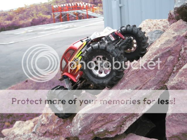

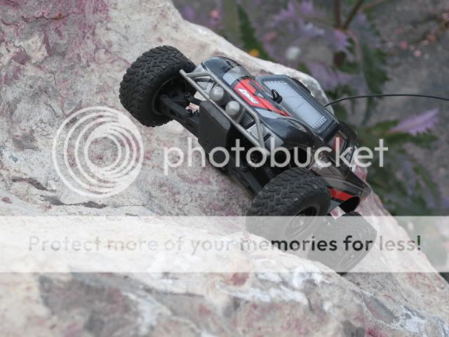

Here's my next Rock Racer:twisted::twisted::twisted:
Well may be not:cry::cry::cry:
