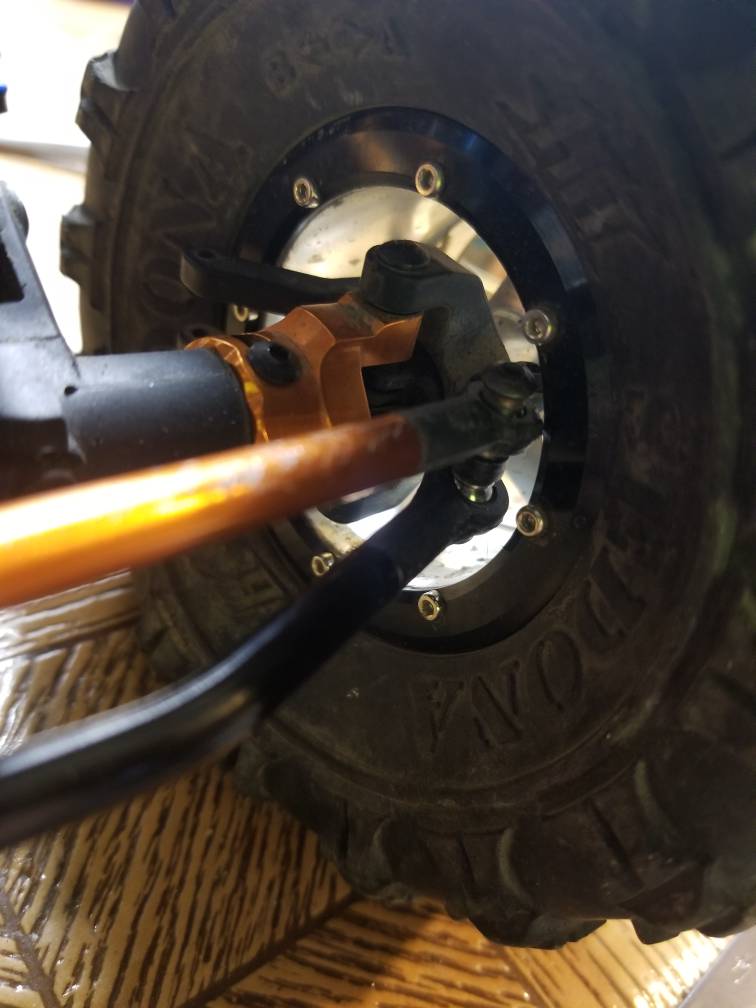

1.As seen in the last pic I have a rubbing issue. At first I has the entire hot racing steering setup on it and it worked fine but that whole setup was worn out. So I replaced it with axial and now the beadlock screws rub the rod ends?

1. You need wheels with a different offset or different knuckles.

Any suggestion on the knuckles? I'm just stumped because I bought it and it worked.. I mean it might have rubbed but I didn't catch it because I noticed the slop and took it apart.

If it were me I would spring for wheels with an adjustable offset. That feature will solve all kinds of clearance issues. There are several options available, you'll have to poke around and see what works best for your budget.

Havent had a crawler in awhile. Adjustable offset wheels are new to me. Suggestions.

There are several. Vanquish/Incision, LockedUp, Gearhead, and SSD come immediately to mind. If you're super budget conscious, Crawler Innovations makes a nice plastic glue on 2.2 wheel that utilizes the VP hub bolt pattern.
There are other options on the horizon, but I'm not sure if they are available yet. You'll have to keep an eye out for them.

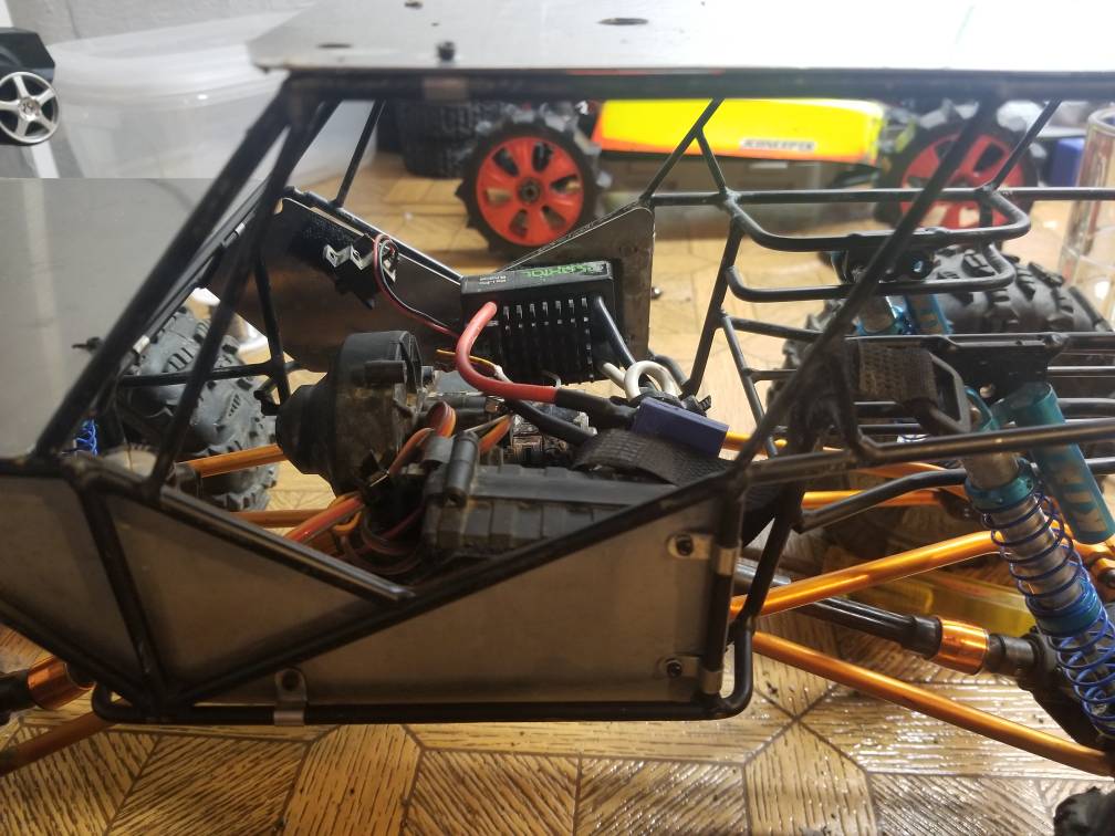

550 can motors won’t readily bolt up to the Wraith skid either. It’ll need some shimming and trimming. So stick with short 540 cans the the aforementioned HW1080 or go brushless.

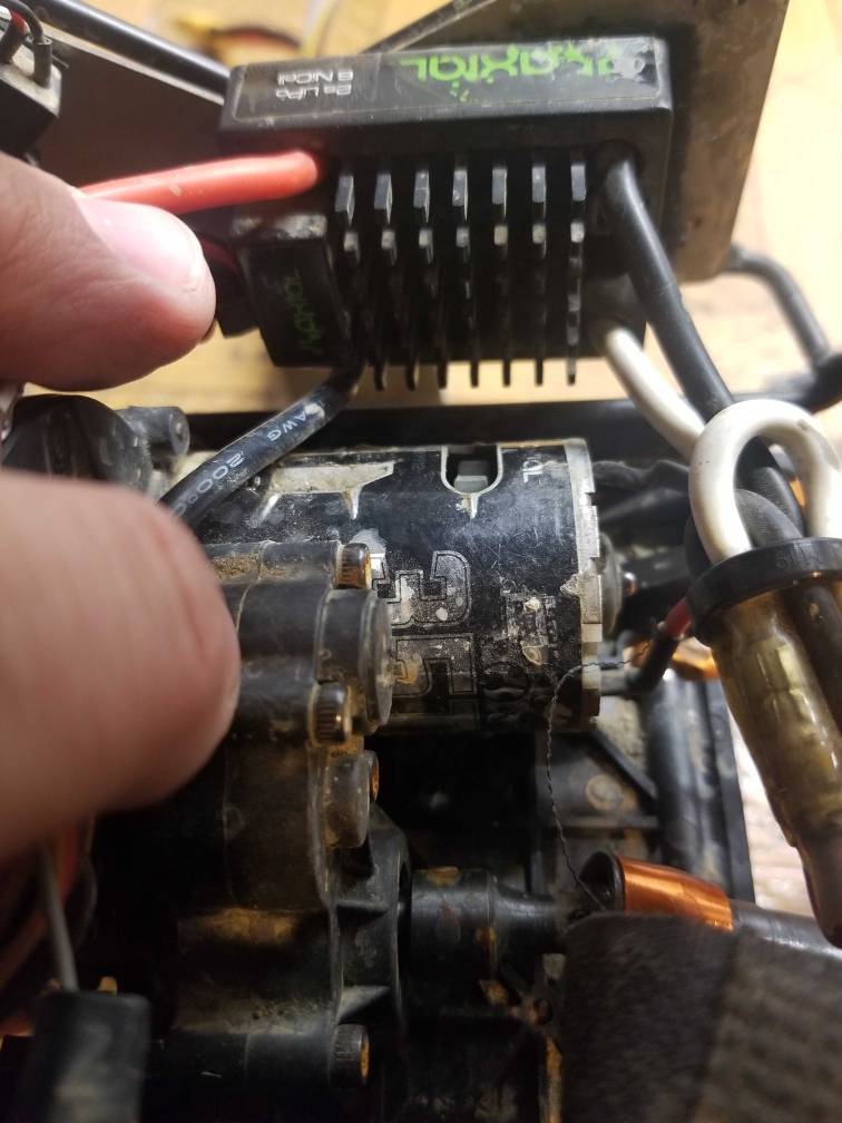

Isnt this axial motor a 550 can?
Anyone know where I could find a "pan" insert for this to hide all the wires etc
Thats just an 540can 35turn, not totally horrible for crawling but thats only a budget spec sealed can motor.
A 550 motor can just interfere with the right rear upper link mount, you may have to just touch the skid slightly with a file/dremel to get a 550 to fit.

Couple of questions-
Can you post a pic with a front wheel off so we can see what hex's it has?
It might have the narrow SCX10 hex when it could have the wider Wraith hex instead which will move the wheel out.
Even if it has the Wraith hex theres wider hex options out there which might gain enough.
That ESC is an Axial AE-3, which is a rebranded Castle ESC. It is a good esc for brushed motors and will handle 3S just fine. I'd buy a Castle Link to tune it though.

As for wheel hexs- found a 12mm to 17mm adapter on amazon. They work fine.
