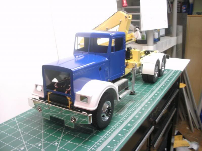

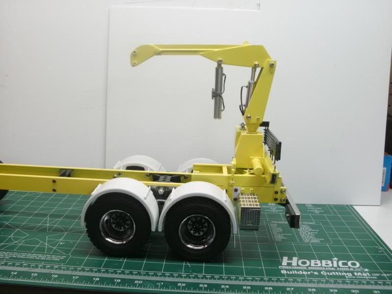

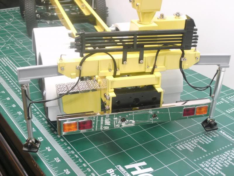

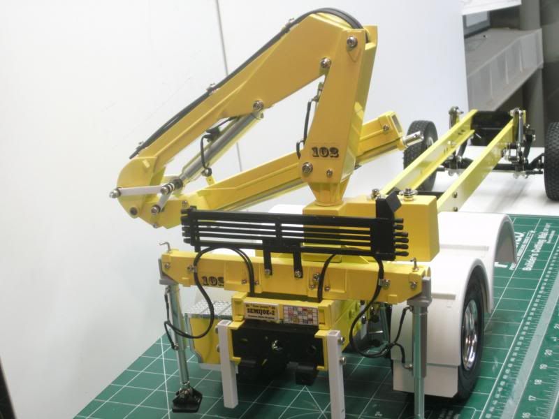

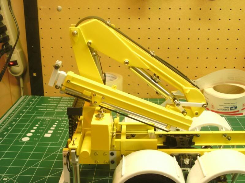

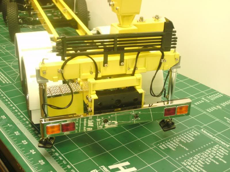

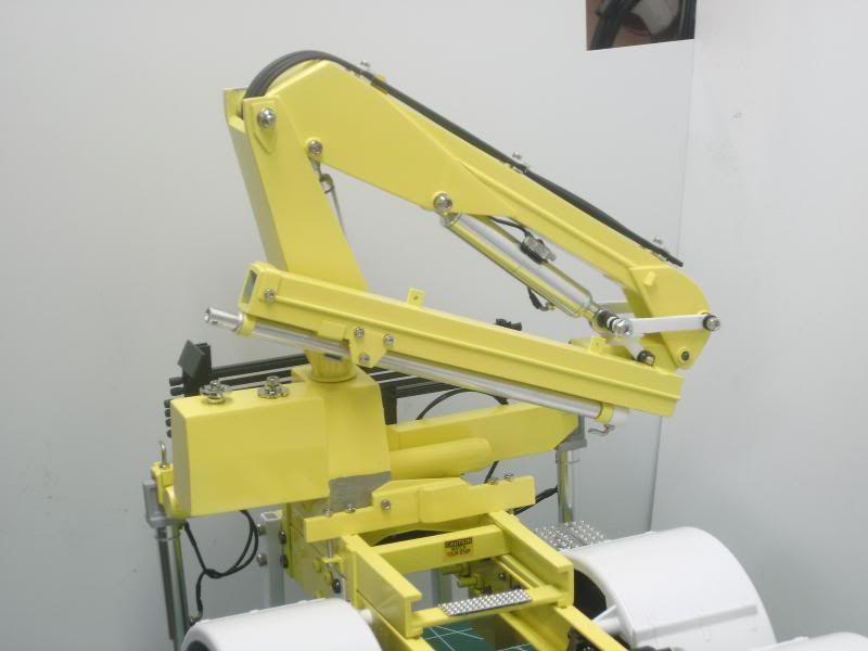

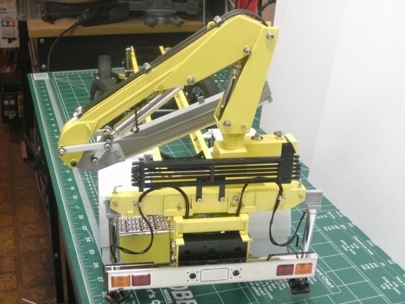

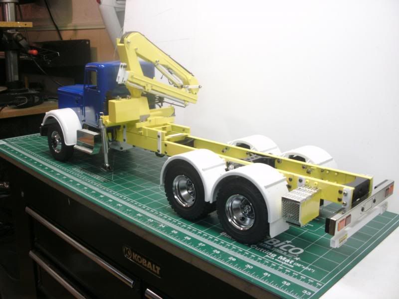

pivoting crane / hiab 1/14 scale scratch

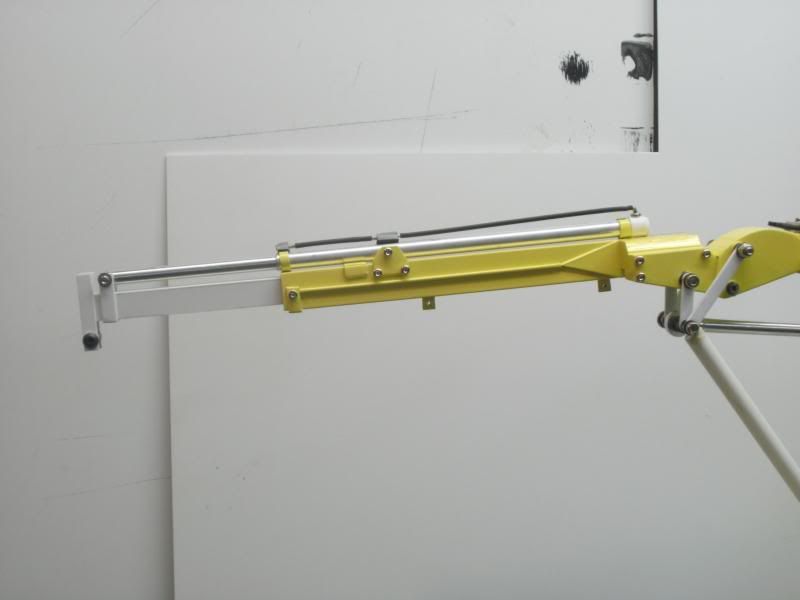

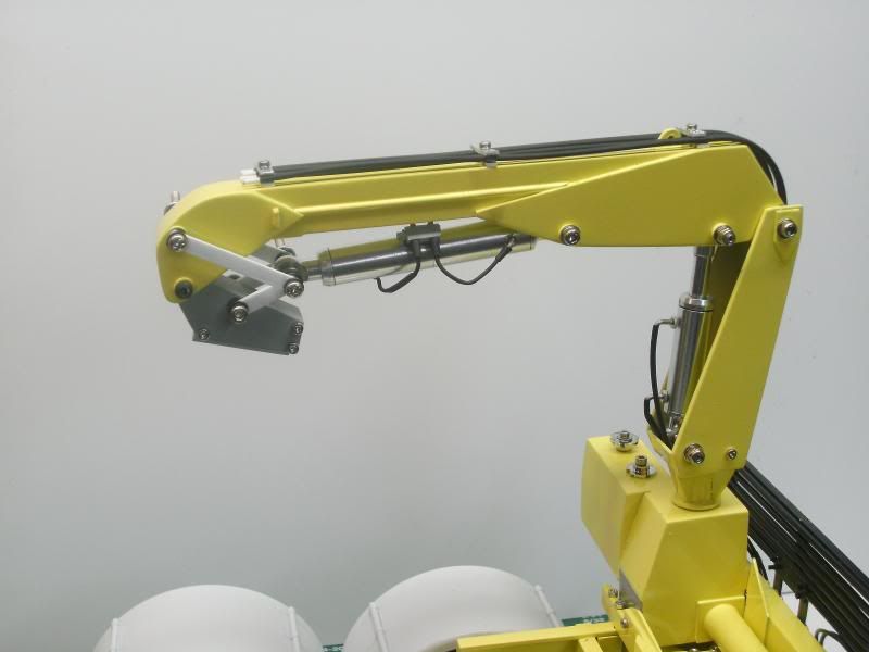

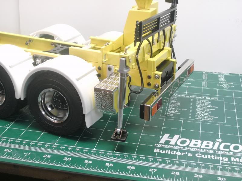

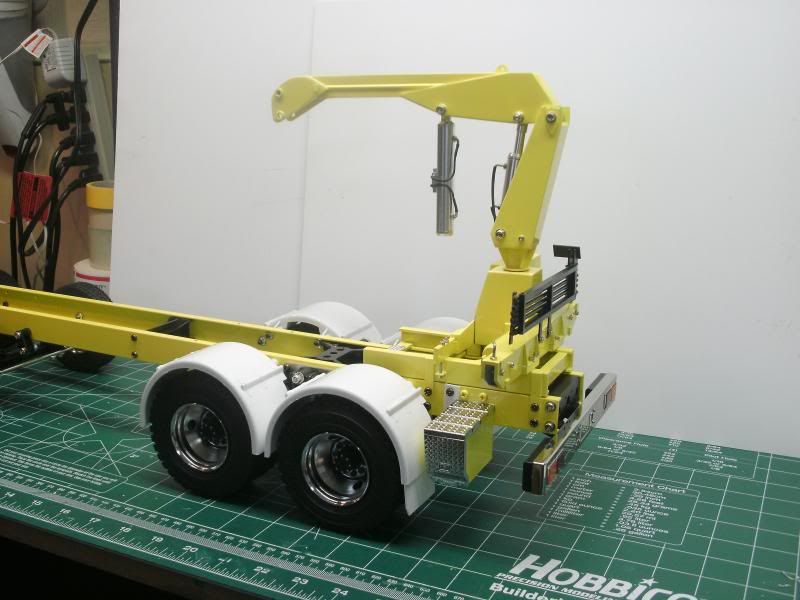

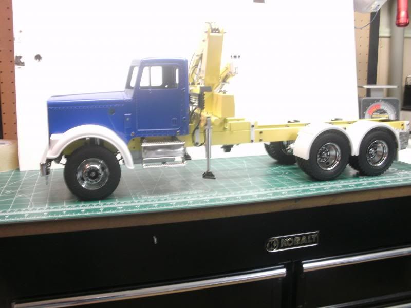

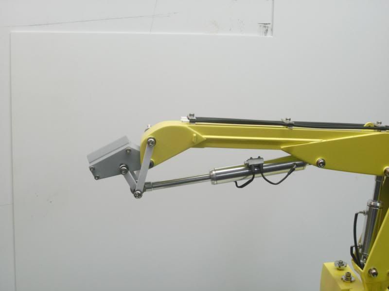

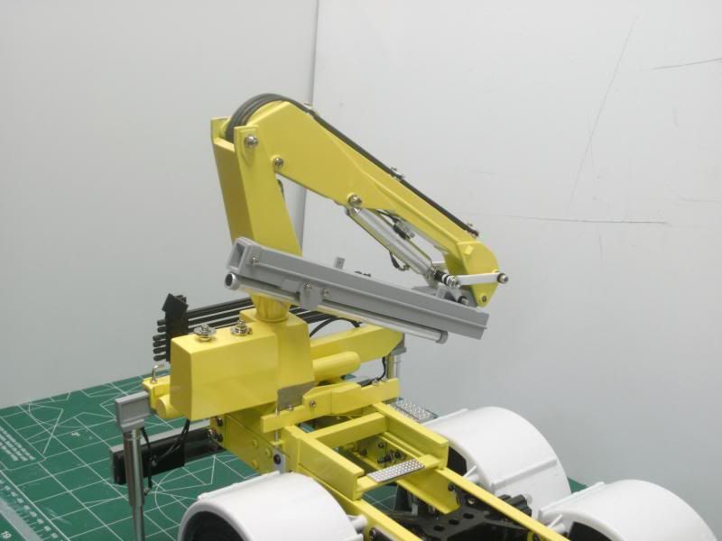

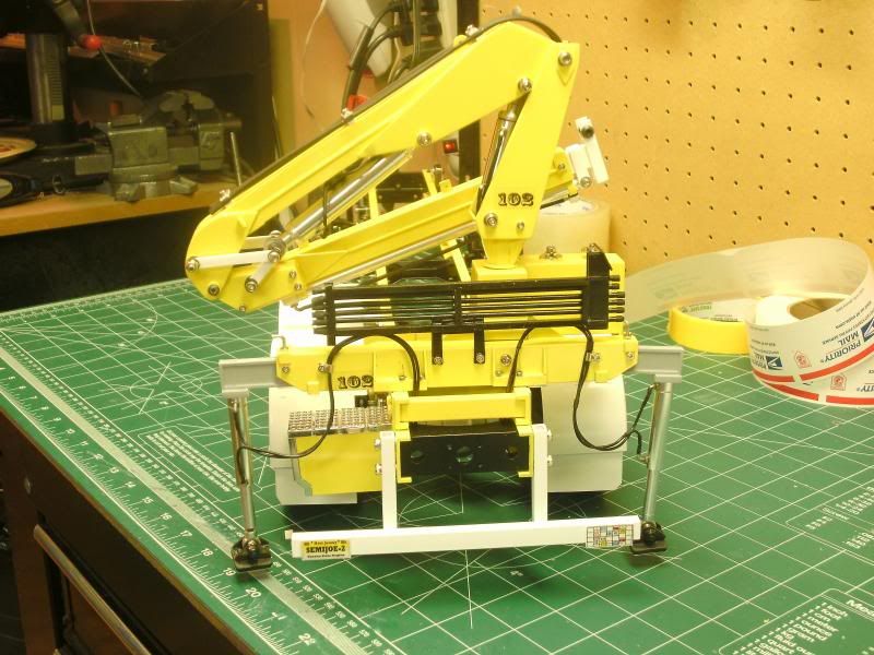

out riggers are done , lines are ran , tomorrow i will get back on the boom, there is still the knuckle boom to build and the extension boom to build, long way to go

Probably a stupid question...but have you ever considered any hydraulics for this stuff ???

hydralis for this build would have been about alease 1800.00 if not more
all the guys i know personally, all there trucks are shelf queens , they spend like 5000 to 12000 on them and they never see a battery . so to me making this for about 80.00 is money saved
this build was basically showing guys that you dont need a crap aload of money to make your truck look good

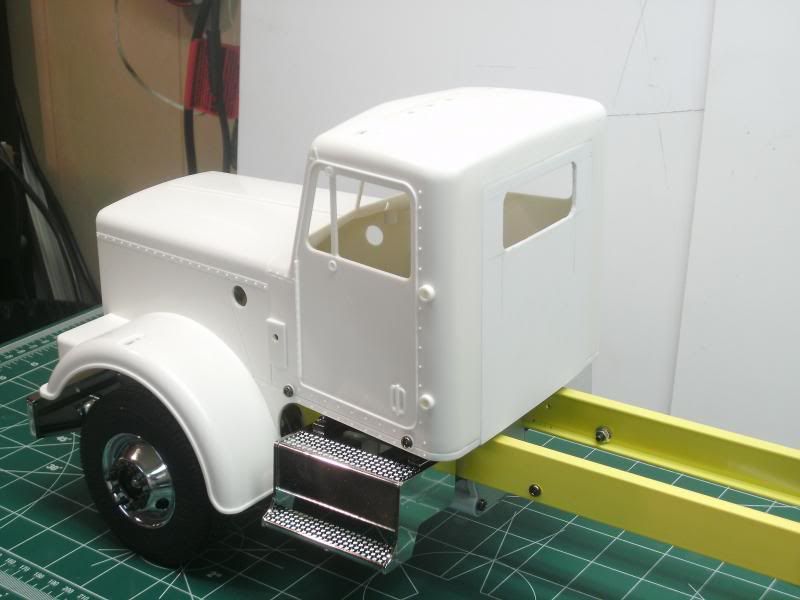

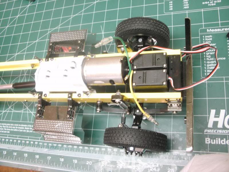

i installed 2x futaba servos, 3 transmission, stock motor 27 turn, bearinged, cab is a king hauler day cab and will hav a flatbed
