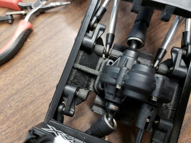

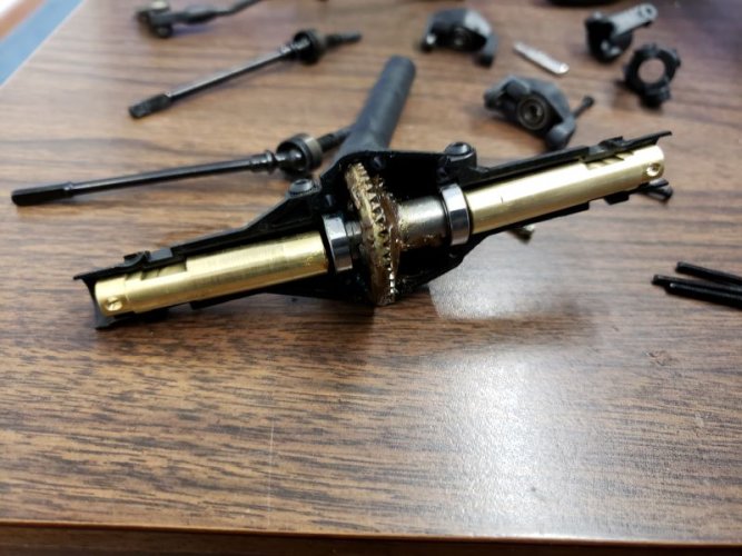

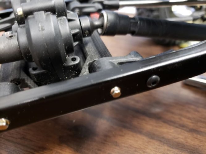

So looking to attend Zia Scale Nationals this year in New Mexico, I needed to build a new C2 rig and luckily found this Venture locally for a steal, $100 RTR! It had a broken chub and missing dog bone and was pretty dirty, but definitely had potential. After disassembly, cleaning and making the small repairs needed, I got it up and running.
Plan of attack begins......

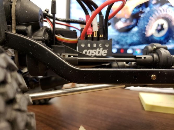

- ESC-Castle MambaX

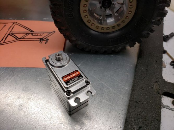

- Servo- Spektrum S6280

- STRC Brass Chubs
- STRC Brass Knuclkes
- HPI Brass axle weights (rear)

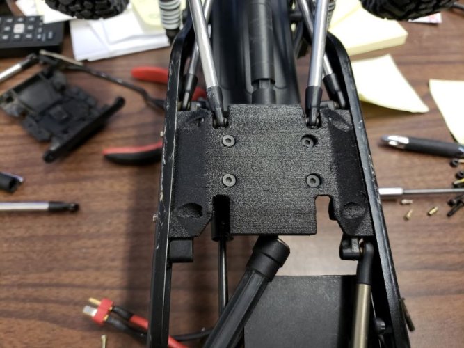

- Bow House printed skid

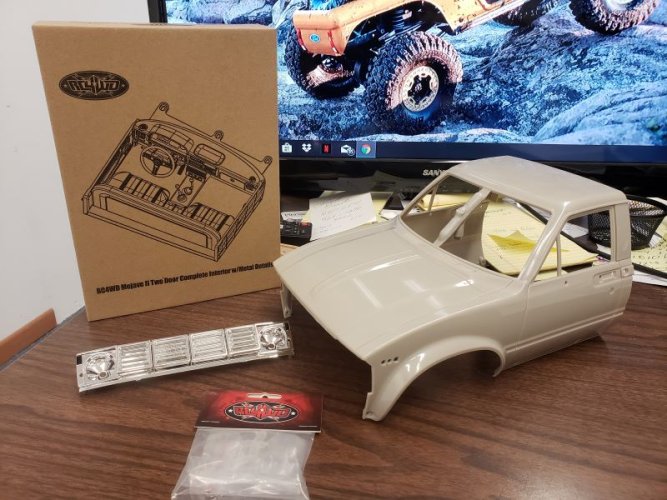

- RC4WD TF2 Yota cab and cab back
- RC4WD TF2 round headlight grille

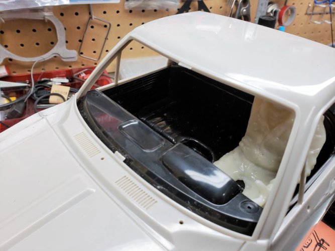

- RC4WD interior

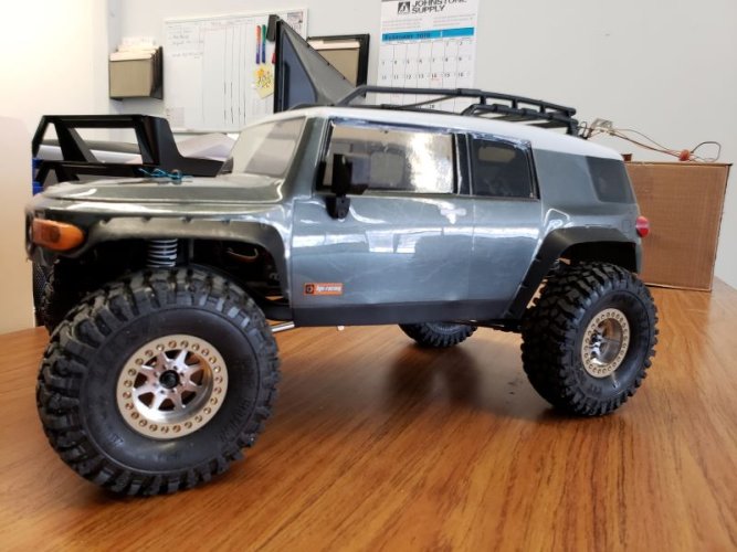

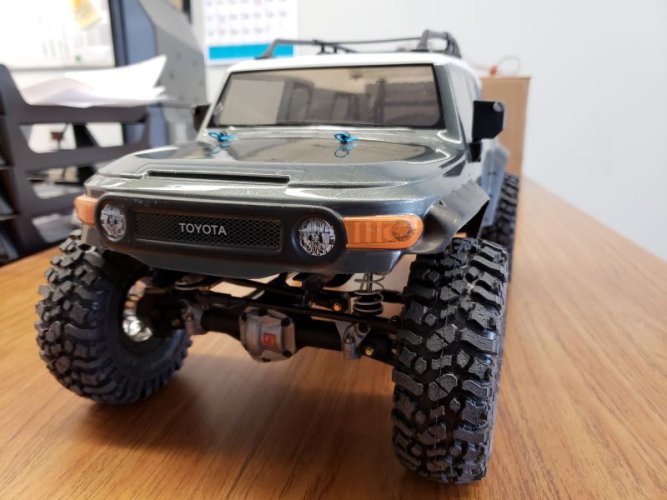

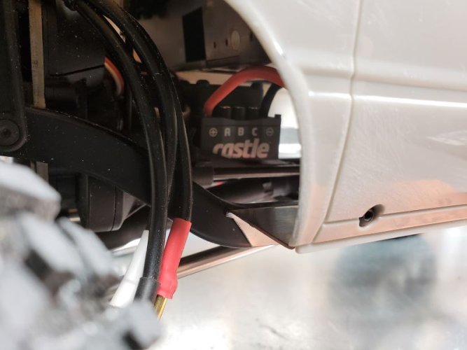

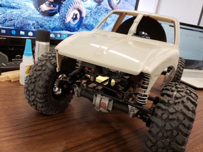

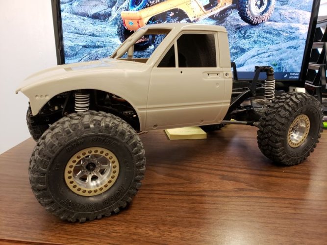

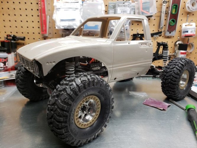

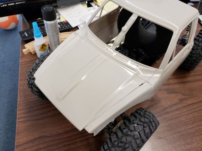

How it sits now waiting for the cab to get here. Going to make up a set of my FSL-2 Sliders for the Cruiser body and possibly offer link sets for it.
