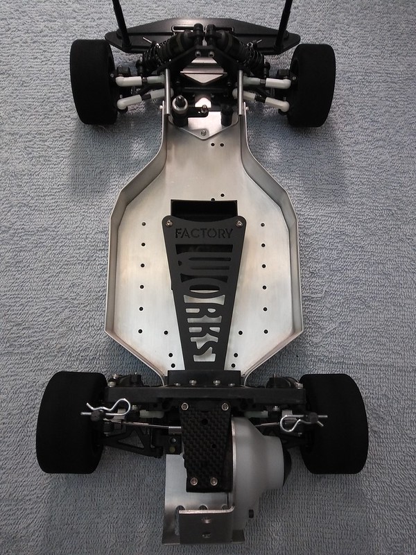

Team shocks mounted:
Factory Works Battery brace installed

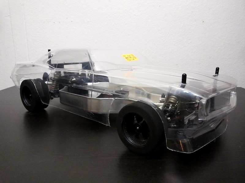

HPI 1969 Camaro body trimmed and mounted
Motor/Esc Selection: Castle Creations Sidewinder 3 5700kV
Steering Servo mounted
Completed Project - The Great Finale!
My Buddy can't wait to get this on his shelf!
Too bad he wont run her because she is a smooth roller. Gear mesh is perfect and quiet.
Let me know what you think!
