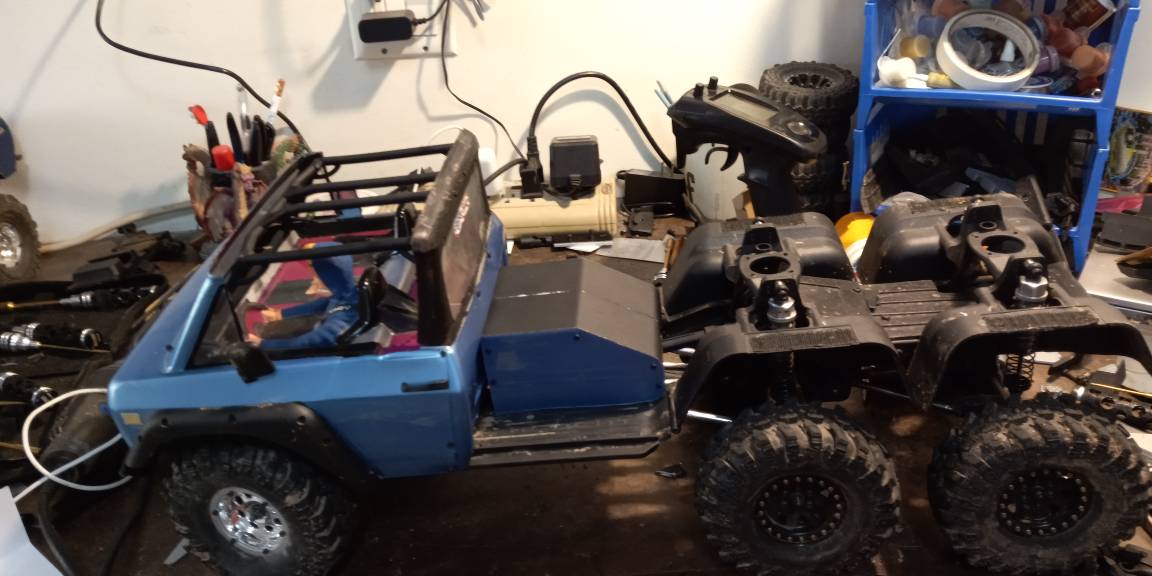

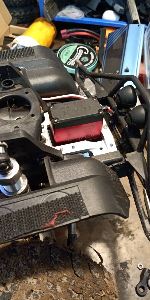

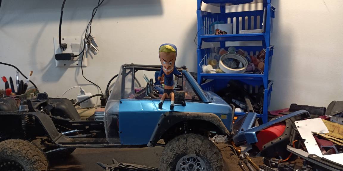

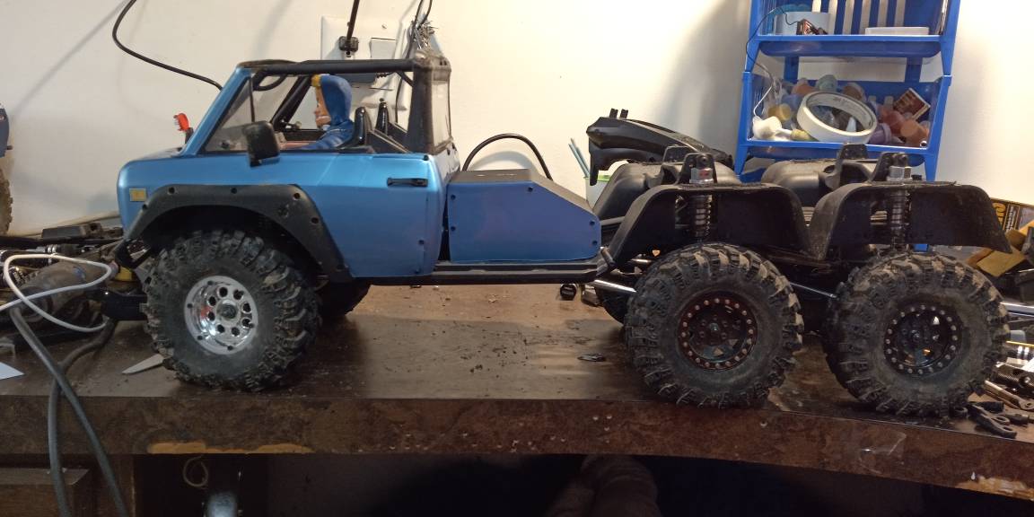

Dog house just about done. Put some mirrors on and couple other things.

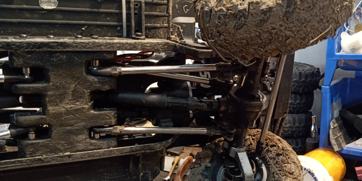

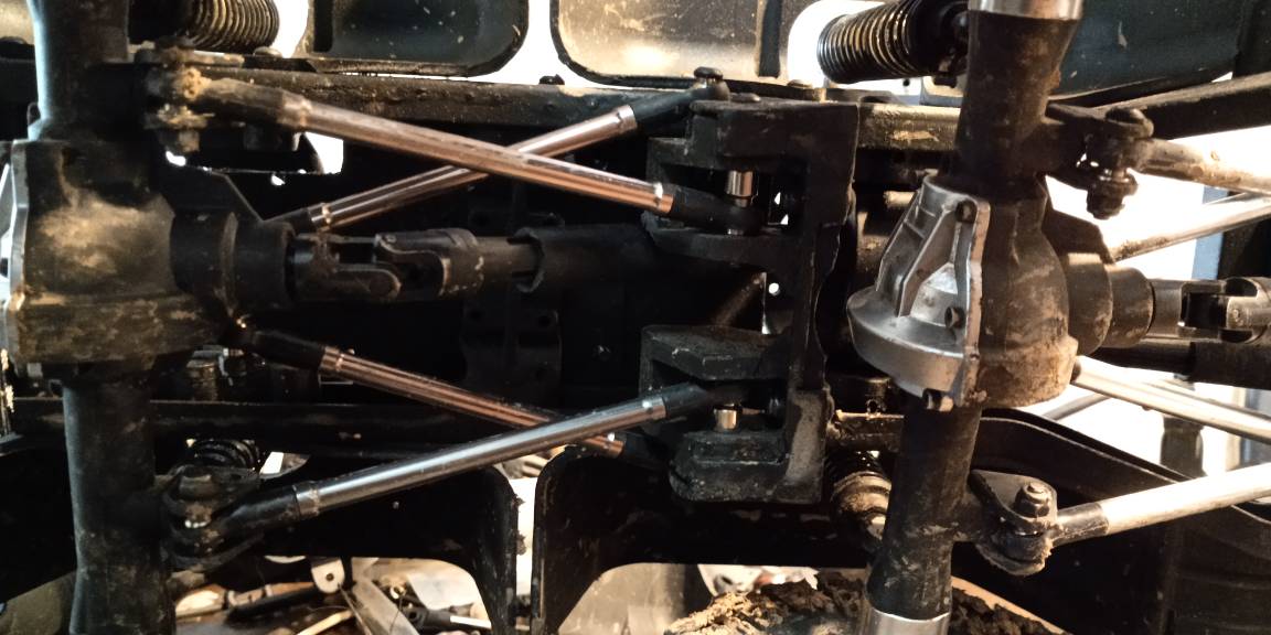

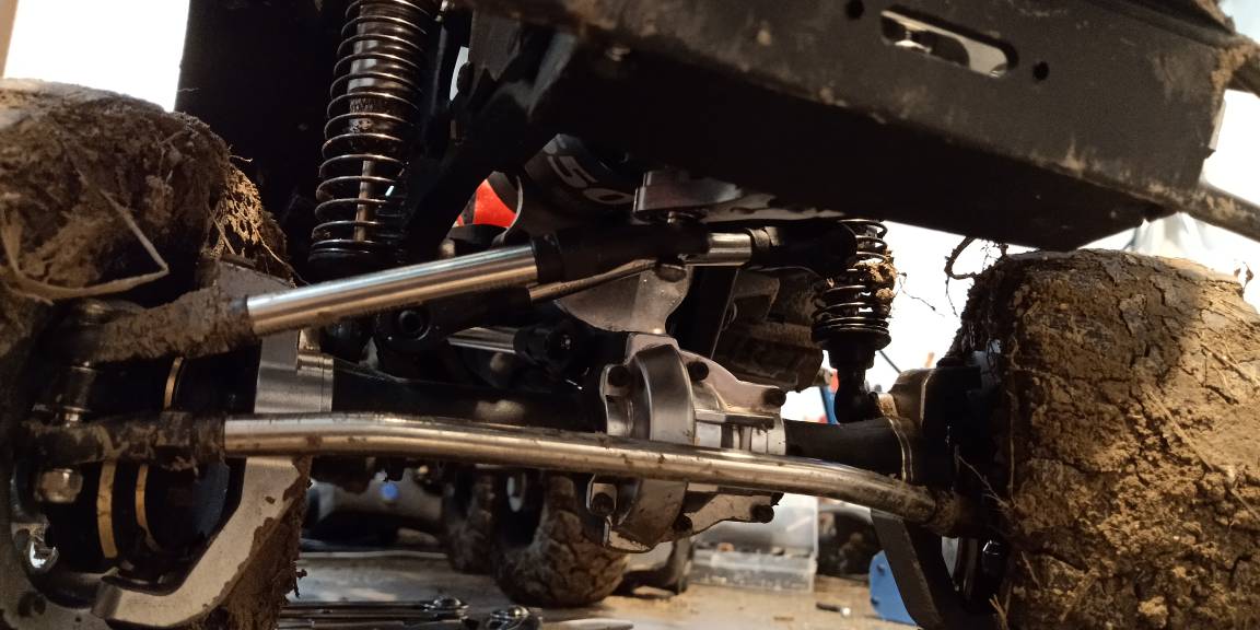

I also put a Club 5 RC link set and servo relocation.

Beavis never looked so focused. Did you actually cut an opening between the cab and the doghouse? Curious to see what you do with the space between the rear shock tower?
electronics?
electronics?

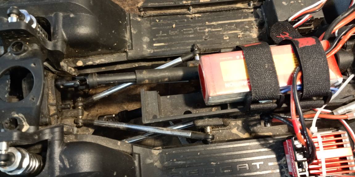

Everything is under the cab and dog house. The battery and transfer case were visible which is why I put in the dog house. It is open between the cab and dog house.

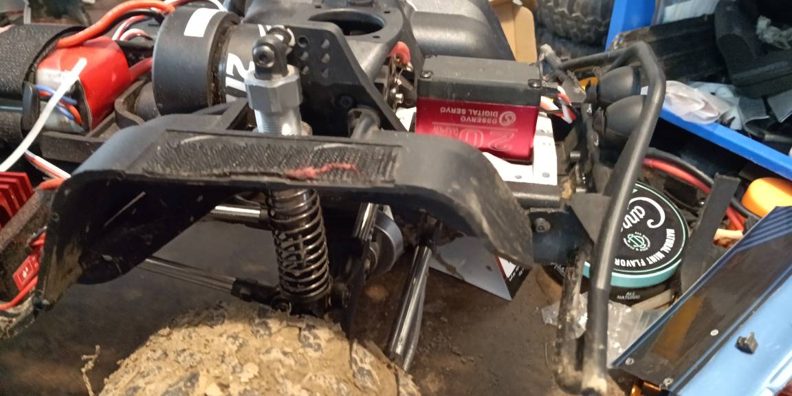

I figured that :ror:, I should have been more clear. I noticed a Hackamoto motor in one pic, but what sort of power and control is tucked in there?
It's the 21t. It's not as good as the Holmes but it's ok. I have a stock ESC in it yet but I will be going with either a hw1080 or AXE brushless.
Surprisingly with the extra weight and axle the motor doesn't even get warm on 3s. I use a Flysky FS-GT5 as the stock radio could use better throttle potentiometer.

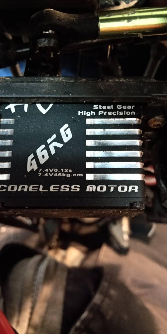

Servo is a ds3218 but I will be upgrading it as it's not up to the Job with 6 tires pushing into stuff and it stalls. I have a 638oz JX servo from Amazon. Have had good luck with them and for the price you can't go wrong.

Also just wanted to say the Club 5 Racing servo relocation is great. Everything gets lined up where it should be. Stearing angle and precision is greatly improved.

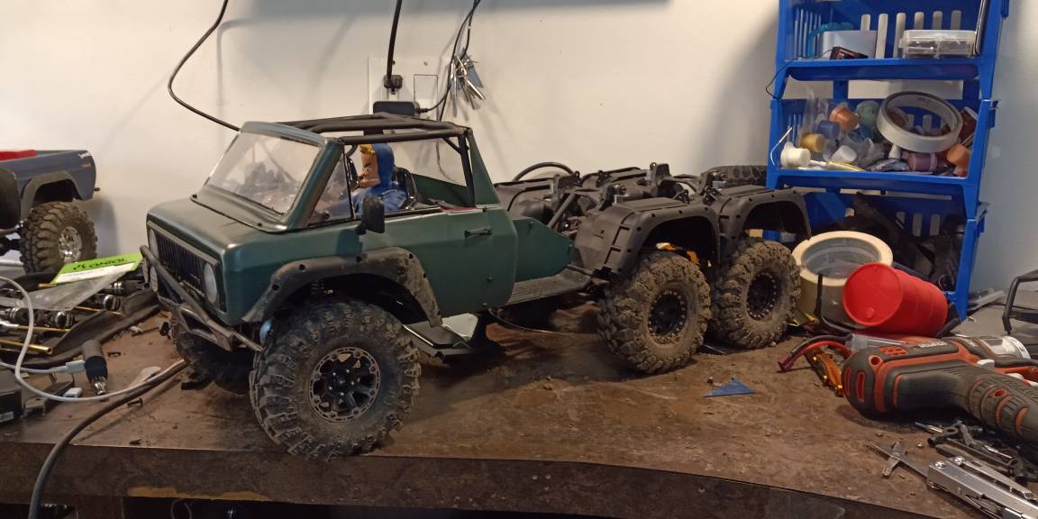

A little cab modification. I finally found my cut up clear body. Put the back on. I wish I had a roof but I will make do.

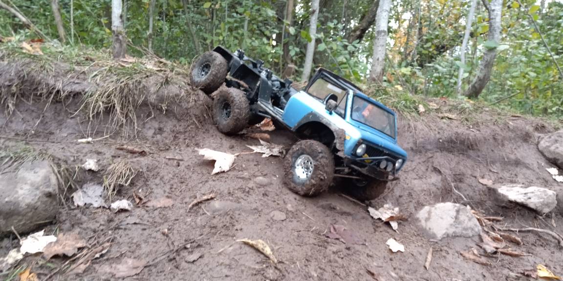

Did a little painting and trying to decide if I should put the Mercedes diesel in it.
It's not pretty but it's fun. It will do for now.
