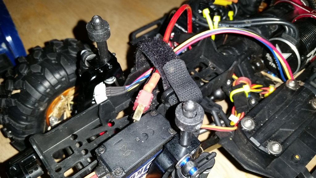

Blew the front body posts off of my SCX10ii Kit in a fall off a cliff & had a hard time finding original replacements in stock.
The diameter is perfect for old pan car type universal posts.
Few things that will need tweaking:
Cut the fat part off the bottom,
Drill a 3/32" hole at the desired height to pin to shock tower,
Drill body hole to 1/4"
Here is what I used for a front replacement:
TowerHobbies.com | Duratrax Nylon Body Post Black 2.5" (2)
