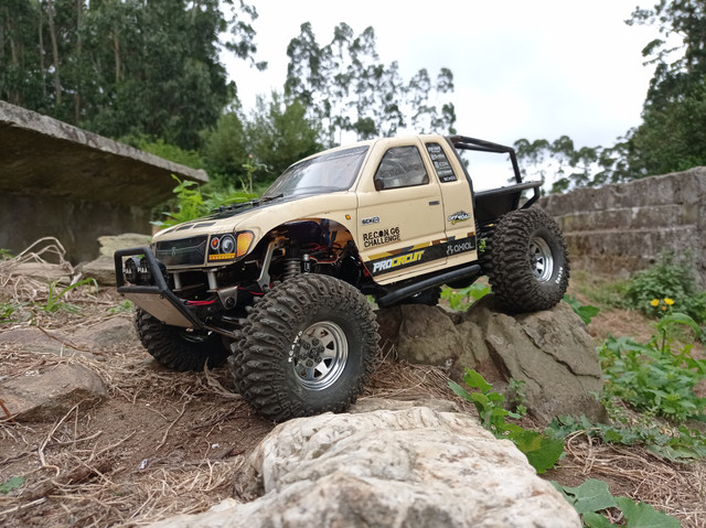

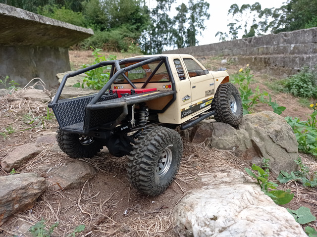

Silverado prerunner
WIP
Wheel base 340mm (Rear +27mm). Frame extended 35mm.
MIG welded frame from round 4mm stainless steel.
Carbon fibre frame, Extra Speed axles, dual gear transmission with belt drive primary gear, Tenshock 6pole 1750kv motor, 3S battery.

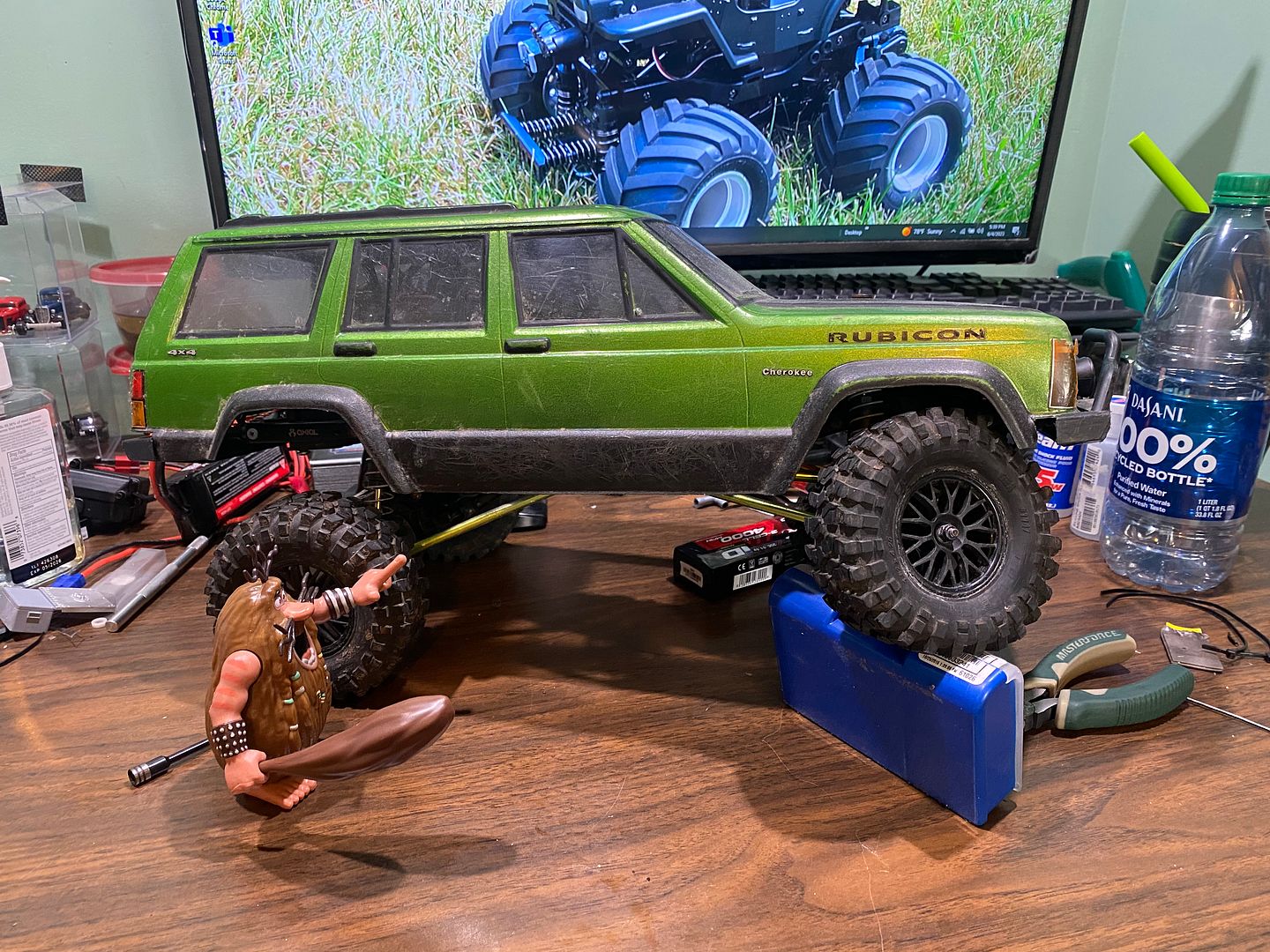

Bought this SCX10 2012 Wrangler Rubicon RTR locally for steal last weekend, only ran about 2-3 times since new 10 years ago! Still like new. Re-lubed all bearings, gears, replaced shock oil and green slimed. It came as-is with all the goods, scale details, winch, lights. All I had to do was a little TLC and a bit of rewiring and re-assembly of some parts to get it to run correctly. Very happy with this rig! "thumbsup"
HH TorqueMaster 540 35T
Hobbywing 1080 ESC (came with a mamba max pro sensored ESC, too big for this rig though so I took it off and set it for another project)
Hitec 646 WP Servo
RC4WD Warn winch

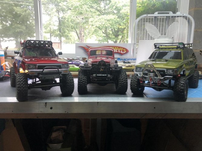

Just my junk.

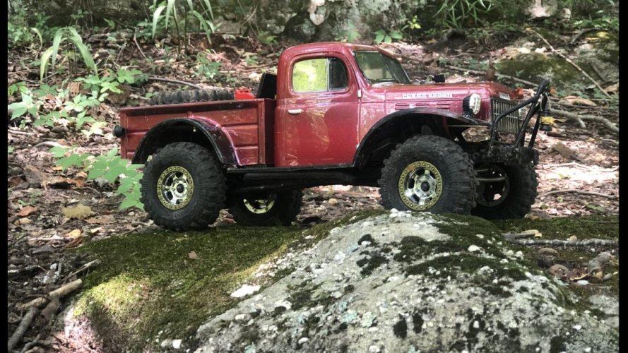

Power Wagon is scx10 with Castle Sidewinder 3 and rc4wd 35t boost with a tactic servo and proline swampers on Gearhead BTT beadlocks.
4Runner is scx10 with hobbywing 2800kv AXE system, twin savox 1230 servos, wireless warn winch, lockedupRC FI spools in boom racing phat axle housings and proline Hyrax 1.9 on rc4wd/ hot racing beadlocks

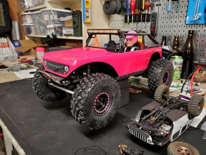

Wifey's Deadbolt got a fresh body and some VXT2s recently
