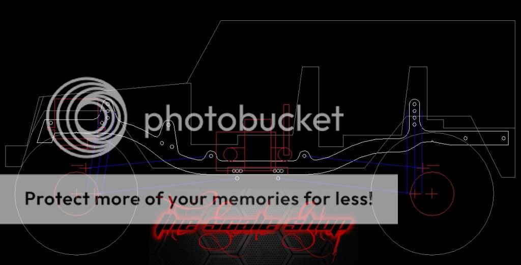

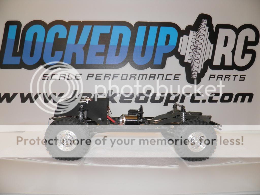

Chassis - Custom designed by Cory (Stang Killa SS) of The Scale Shop
Aluminum Scale Radriator V2 "Ultralite" - super easy to install, very light and looks fantastic!
*Warning* - once you go custom chassis, you can never go back
It makes the entire build so much easier.

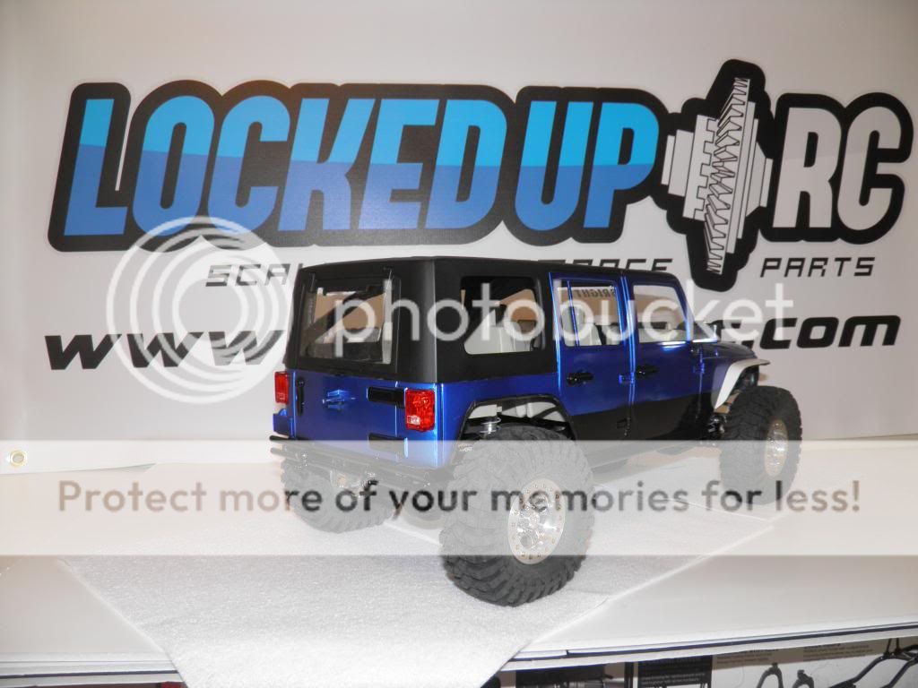

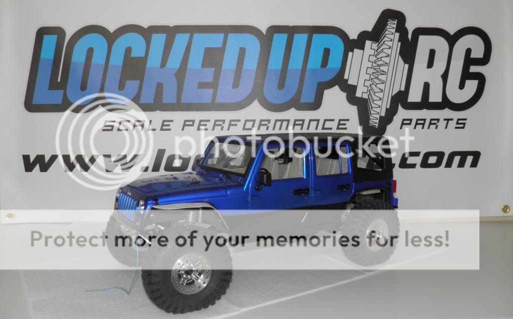

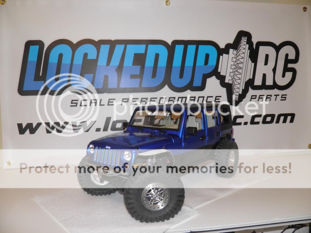

Body is a New Bright 4dr JK with some modifications that include trimmed front fender flares (still need to be painted) and completely removed rear fender flares. Ive decided to run it with the entire roof intact, as I just love its profile. Also, I plan on running the color as is, no painting required..bonus!
Custom made sliders, made from very thin galvanized steel to save on weight. Decided here not to mount tube sliders to it in order to keep things extra clean. Ultimately, it might be nice to have them as those are a useful point to wrap winch line through in the event of a rollover, but hey, it'll never roll over:tongue:

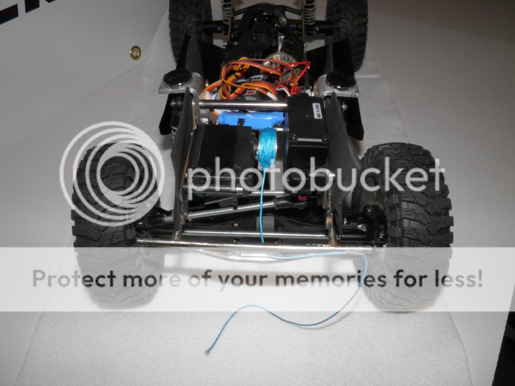

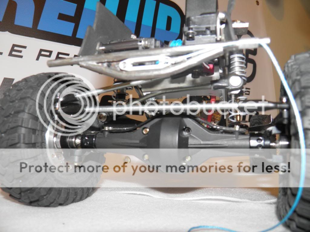

I made the front bumper to be class legal, and as out of the way as possible. I managed to mount the winch line fairlead between the two tubes to keep it out of the way.
The body is held in place with super strong magnets up front, and for now at least, two body posts in the rear to help align the body, and gives me the option of using a body clip should I feel the need for more holding power. I do plan on using two super strong magnets to hold the rear down as well.

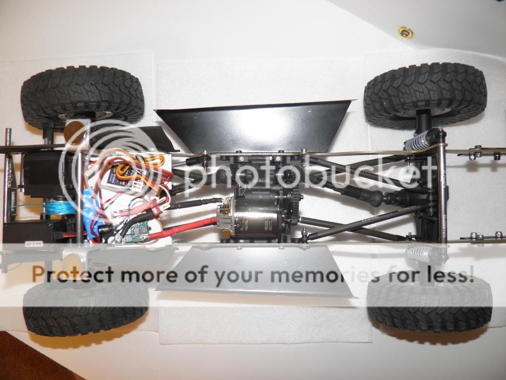

So far, during my initial living room testing, the suspension and steering geometry seem to be very good. There is zero bump steer, good but not ridicoulous articulation, and I was able to mount the steering link and drag link on top of the arms, thanks to the custom chassis.
