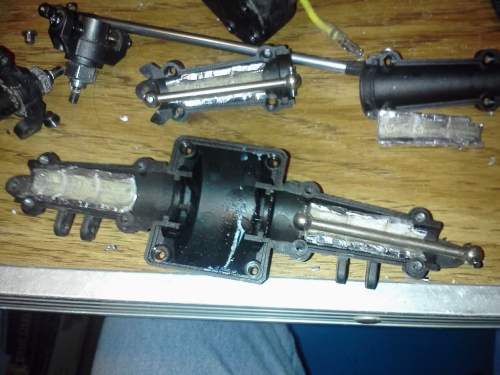

Inner axle weight added. I was able to get 3oz glued to the inside of the axle tubes with no clearance issues
edit:
I was able to get another 1 1/2oz inside the axle housing by glueing weight inside the diff next to the spur gear...its a tight fight but everything clears just fine. I could actually double everything up and get another 1-2oz if I wanted to...but im good with it like it is. Is now at about 4 1/2oz.
Pretty smart idea. Maybe make a mold of that and try making lead parts to fit in there? You could gain lots of axle weight then. Lead is easy to melt to lol
Sent from my SCH-I500 using Tapatalk
Ya u could definately do that. Theres still lots of room for the axles. U could easily get 5-6oz in there if u did it like that. Plus with the lead inthere it will strengthen the axle housings.
