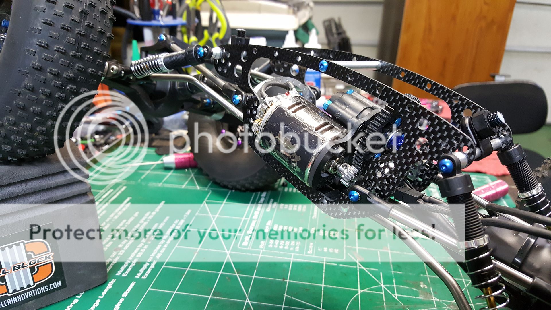

The goods...
Xciter body
Evo chassis
Ti links/steering
Scx/ax10 xr modded axles
Des Troy plate
Scx shocks (mrc springs)
Scx trans(alum HR alum gears/cf motor plate)
Dlux knuckles/ofna shafts
Gunner body mounts/posts
HH spools f/r
Od/ud
Creeper bob rear shafts
Shift hubs (rear)
2pc cf custom wheels
Narrowed voodoos
Br mini esc
HH Hv500 servo
HH 35t pro tm
Still waiting to purchase 400 13t puller when available:cry:

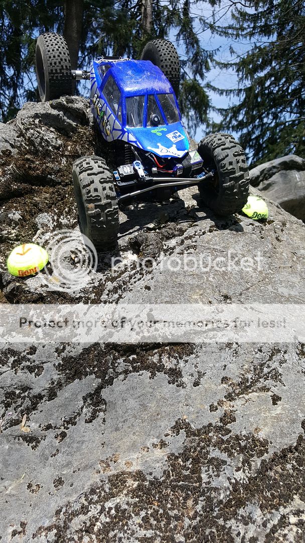

The 1st shake down run i noticed the torque twist was very bad so changed a few things & hope to see improvement! As it sits now.

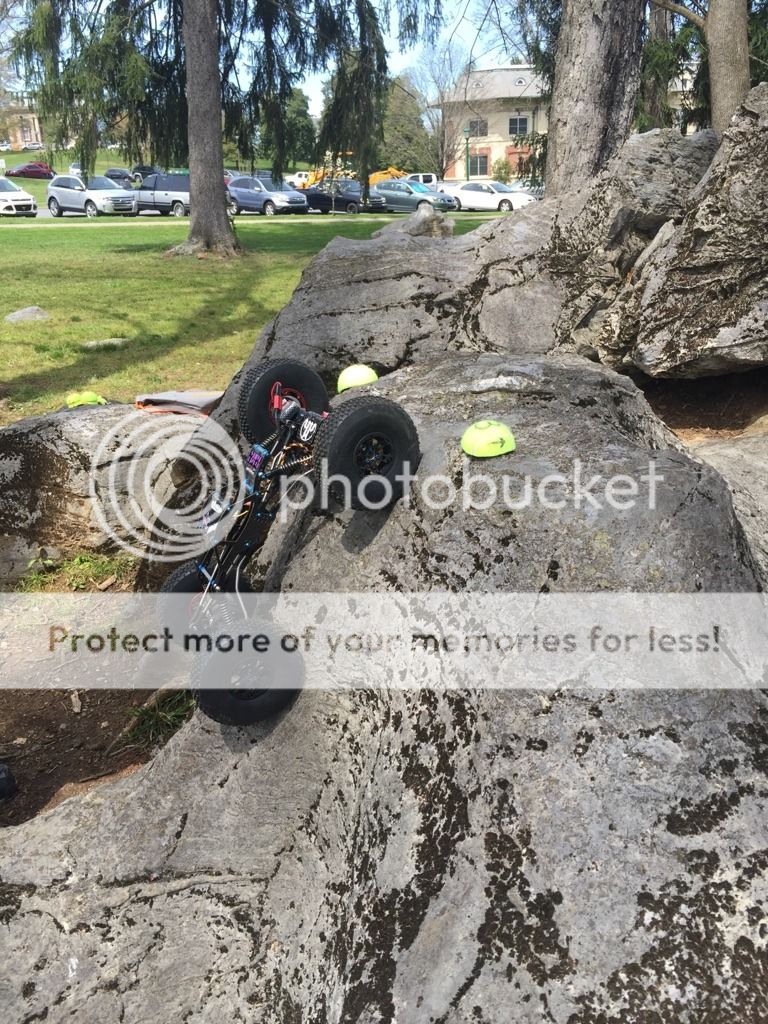

Got some runnin in today with better results! The front dont lift as much as b4 & sidehills much better. Still tuning on this thing(like it ever stops)but really like it so far. Got a few pics but not many from todays comp...

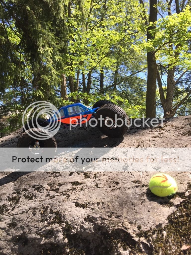

Gettin as much time in with my rigs as possible"thumbsup" The EVO is doin great 2nd time out! Still tryin to tune or find a sweet spot with shock oil & shock position...

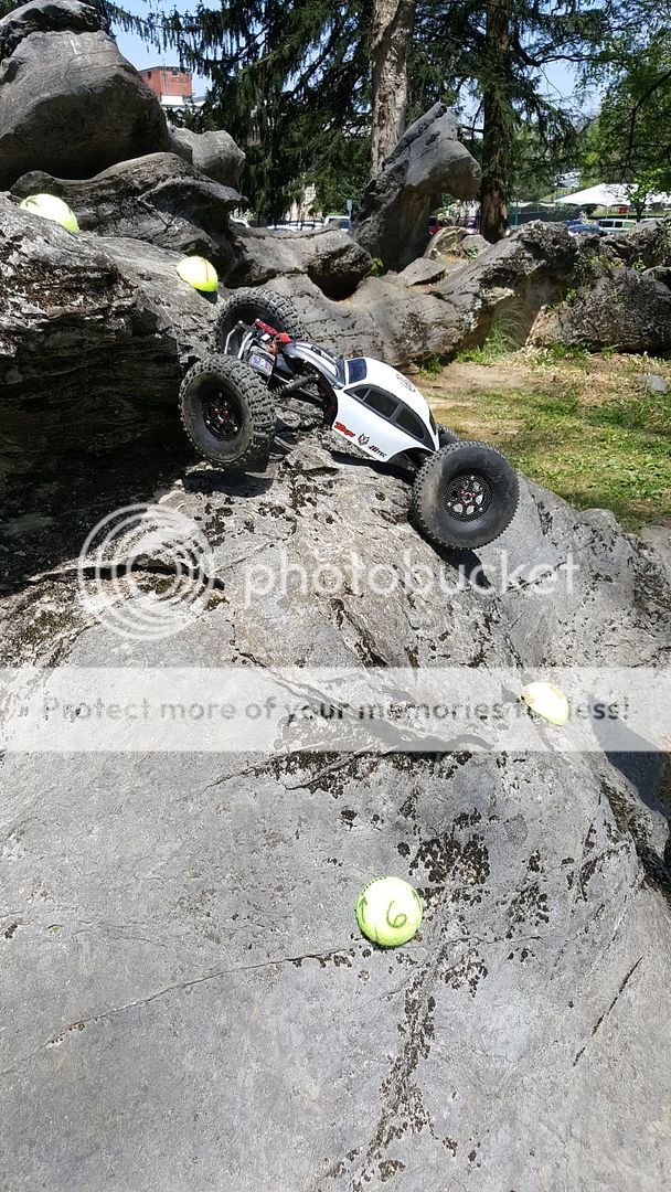

Ty Alamo! It went well today with great company! It was close today, 1st course was brutal:flipoff: Your suckerpunch did very well too! We run there alot so anytime"thumbsup" I hope we have a few more drivers next time...

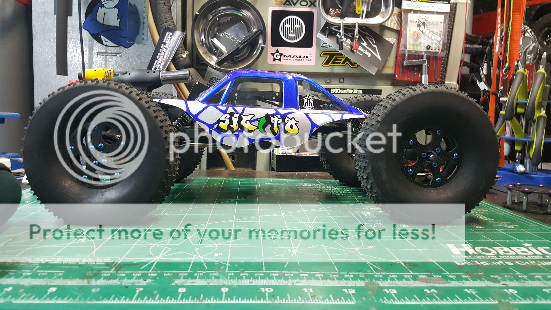

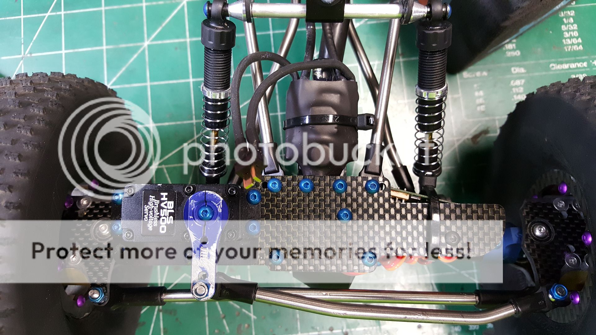

Few changes made!!!
Widened shocks out at chassis
Wheelbase narrowed in rear a lil
Clocked pinion down in front to get the plate(axle) level
Removed inner cf ring in wheels(2pc or 3pc optional)
Added 1 slug in Dlux knuckles (2 total ea side)
Trimmed body more for clearance
Added ti link sliders
Did a lil runnin today at same spots i started testing & Damnnnnnnnn what a differance! I think i will leave it alone for now & drive drive drive!!!
It did gain a lil weight but i never was tryin to go light as poss in 1st place"thumbsup"
