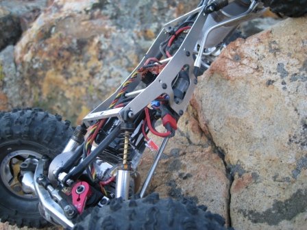

Looking at you pics, makes me wonder what knuckle weights you are running? Those look a bit unique.
SORRY. JUST READ THE FIRST POST AND SAW YOUR DETAIL ABOUT YOUR KNUCKLE WEIGHT. THANKS.

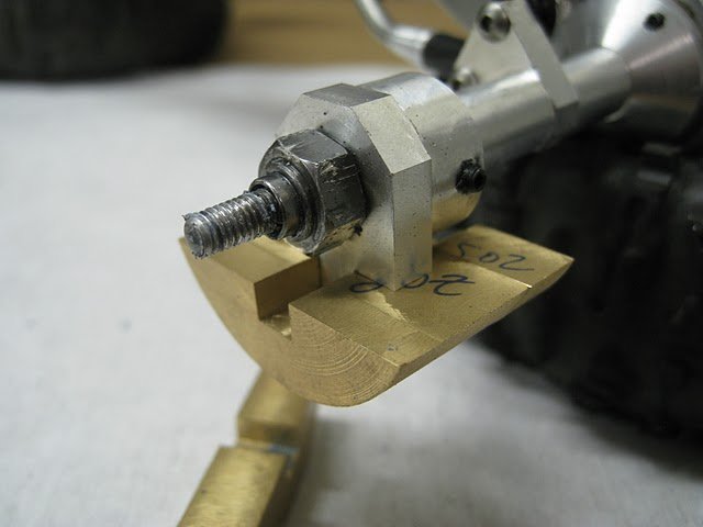

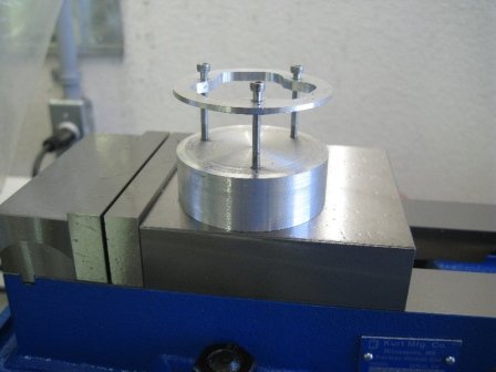

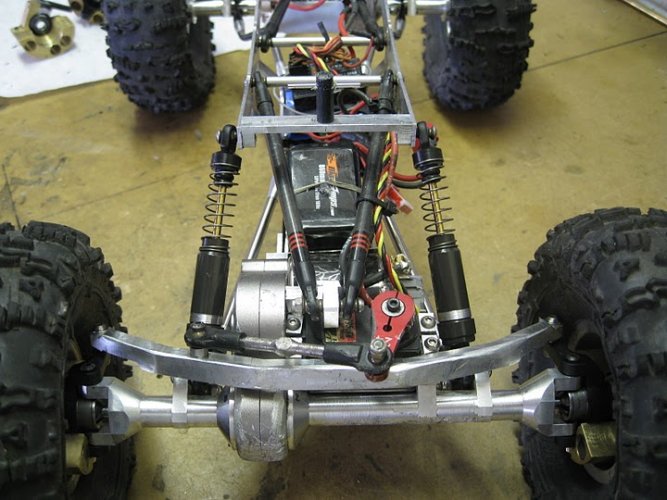

Before the St. George 801 comp I made some supplemental front knuckle weights that screw to the top of my existing weights. One full knuckle weighs 10.5oz. Also made some larger 3oz rear weights. Once I did some testing on the red rock, I didn't use either...oh well. I've always wanted to be able to adjust my track width in increments smaller than 0.25" as is possible with changing hubs, so I made some 0.063" 7075 offset spacers out of some scrap left over from my chassis build. I drilled 12 identical spacers at one time and then lathed them to the correct OD one at a time. Not too much work and well worth it. My steering now goes to full lock with no rubbing anywhere.
More improvements on the way.

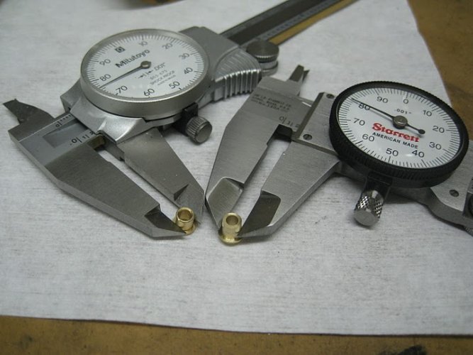

As many know VP knuckles are the best. However the brass Berg kingpin bushings don't fit them well at all (diameter or height). So I made some proper ones. Berg ones are 0.075" OD and the hole in VP knuckles are about 0.0825".
I made some bushings with OD 0.081" and made them a little taller than stock so I didn't have to mill the knuckle flanges or countersink them like some folks have to do. With these there is absolutely no slop or wiggle in the steering any more. Hey VP, if you want to make more money, start making some high quality, snug bushings to go with your fine knuckles. <!-- attachments -->
If anyone has any suggestions as to how to make Google consistently paste images without changing their size I'd greatly appreciate the help. The pics below should be a lot larger. Sorry.

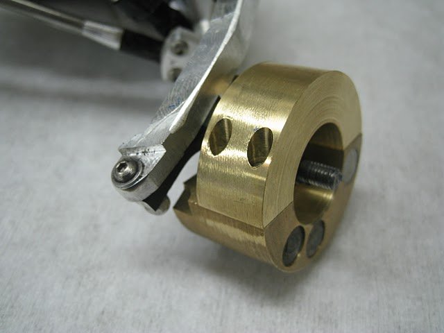

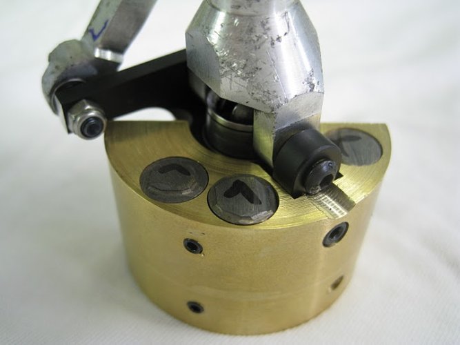

V2 knuckle weights and mo' stuff

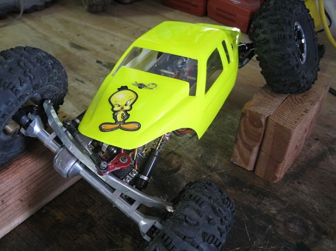

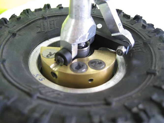

The old weights were cool but I decided to make a new set that attached to the lower knuckle arm to remove the high weight top mounted existing set of weights. Since I'm now using 0.063" hub spacers all the way around I made these 0.050" wider and didn't mill all the way through the weight. You can only see the tungsten plugs from the inside now. I also squeezed the tungsten plugs towards the bottom of the knuckle so I have room to add one more plug to the rear of the knuckle if I want to. All assembled the knuckle weights are within 0.05g of each other and are a little more than 6oz each. I milled out the tie rod to clear the knuckles and cleaned up the transitions so it looks better now. I like it that I don't have to shave the knuckles to fit my beefy bushings so VP's fine work is unmodified except for the 12mm bearings. Also made a new battery strap because when stretched over the top of the battery, an o-ring rubbed the front uppers. Kevlar fishing braid over the top is nice and flat and doesn't rub any more. I put a drop of goop on each battery pack to keep the strap from sliding forward. I ditched the HPI shocks in favor of short TBBs. I love Traxxas products and these leak a lot less than the HPIs. THe HPIs were also very thin after I turned them and they dented easily. Lesson learned. After some measuring my front caster was actually at 34 deg :shock: so I lengthed the front uppers to take it down to 30 :shock:. I left the arrow manufacturers decor on the front uppers because it looks cool. Also re-did my tacky yellow shell after destroying the old one. Luckily I had one Tweety sticker left. It's easy to find my rig with this color...check out the photos from the last 801 St. George comp if you don't believe me. Thanks for watching.
Are you just trying to bring it back to a more "normal" degree or did you experience some drawbacks?
After watching yours in St. George, I pushed mine to 30* now. I am liking it so far.
