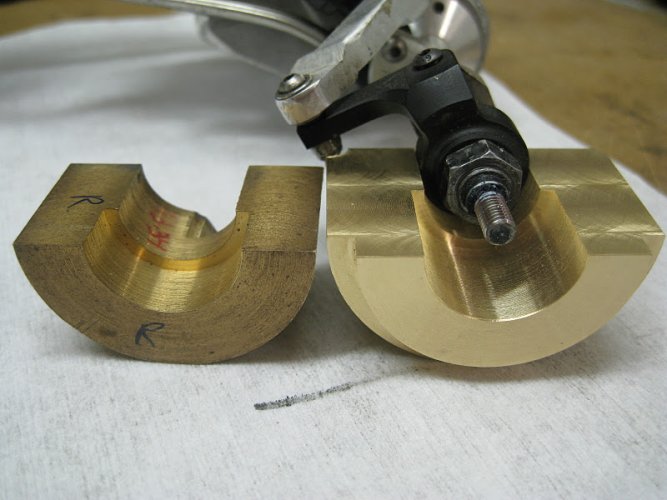

Nope. They weigh slightly more than one oz less each than my old wheel/tire/foam combo for a savings of ~5oz on the rig. My new knuckle wts will weigh a combined 4oz more than the old ones for a net rig change of about 1oz or so. If the front is too heavy I'll drill out the weights to lighten them up.
Got the lathe portion of the knuckle wts done yesterday. They weigh over 1lb ea. When halved and channeled for the knuckle they should be just shy of 8oz ea...without any tungsten this time. With the 0.9" wheel they stick "in" a little more but not past the margin of the tire. I beveled the inner edge to reduce snags. As with all of my stuff, these will evolve.

Finished cutting my new knuckle wts last night. They are 7.80 oz each. I've included my previous version (tarnished one) for comparison. I plan on putting 3 oz of W slugs in the new ones which will put them at 9+ oz ea...too much. I'll then trim them down to lower/forward bias the weight so they weigh ~7.5 oz with all three slugs. Then I'll adjust wt by removing slugs and find the point I like. I'm used to 6 oz per knuckle but with the new wheel/tire combo shaving 5 oz off the rig I'm not sure what wt I want to run now. After I finish these knuckles I can get back to making more wheels...and actually do some dang crawling!!!

What type(as in name) of mach. are you using? (combo lathe/mill or seperate?) Nice work! Love seeing guys come up with new things!
Smithy 1324IMX combo. Out of the box it's not up to my standards but after a serious cleaning, partial disassembly, tuning, modification and some high end aftermarket holding/tooling/accessories, it's awesome. The tailstock leaves much to be desired but I've not modified it yet. I've run it for many long days and the motor never gets over warm. Customer service rocks. It's not quite big enough so when I have a third garage bay or a separate shop I'm getting a Bridgeport and separate lathe.

Done! I milled the knuckles down to the point that they are 7.6 oz each with three W slugs in each one. I'm running 850/725 F/R hubs with one 0.063" 7075 spacer all the way around. Overall the track width is ~0.25" wider than my old setup. The front is ~11.25" wide from the very tip of one side wall lug to the other. Overall weight is within grams of when I started (5.25lb w 860mAh). I also swapped out my whored-out old rear tranny case for a new one too so that added a little weight too (not in photo). The new knuckles weigh 3.5 oz more combined than my old set so that's the weight difference between the old and new wheel setup too. I really like how it drives now. Some of my test lines that were excellent at resolving small improvements with a pass/fail outcome were a piece of cake. The little extra track width may be helping too. I'm very pleased with how they came out and dig they way they look, kinda utilitarian and beefy. It was a fun project and it felt good to get back on the mill after two straight months of 80hr weeks. Time to do some cleaning up and I'll make three more sets over the Holidays. After that I'm not sure what else I can make for my rig...but I'm sure I'll think of something.

Great work as usual Joel. Those new weights and wheels appear to have a very tight tolerance between them. Do you think when your hex's/bearings get a little play the weights will actually drag on the wheel or does it just "appear" that the tolerance is that tight?
Thanks. I was slightly concerned about that too so I beat on it hard yesterday...with no rubbing at all. the 0.025" gap seems to be enough. The wheels are very stiff and could actually go on a diet with no ill effects. If I get rubbing the ID on my V2 set will be a little larger. The bearings are 12mm that I pressed into the knuckles so there is zero play at that point. The hexes have no play yet and I keep them fresh. Any rubbing when it happens will place smooth delrin on polished brass and that's a pretty low COF if I'm not mistaken. I did fine sand the leading and trailing edges of the knuckle in case of trouble.
