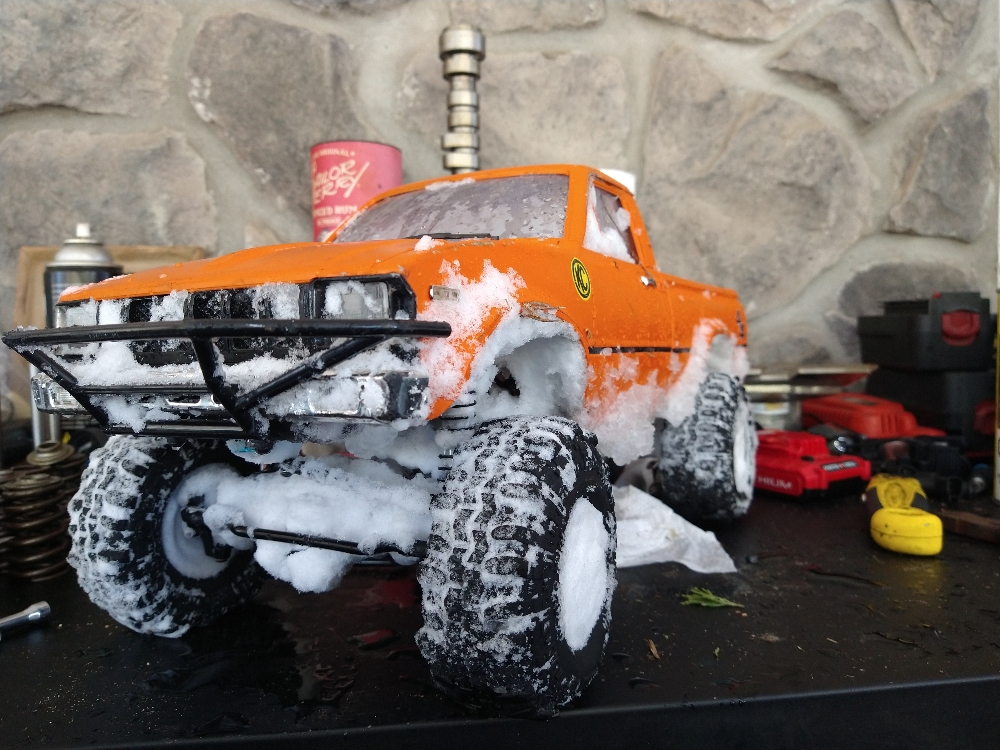

So during running in some deep-ish snow this weekend my slipper died... I really didn't use it, kept it fairly tight, but the pad broke apart. So now seeing that everything for the r3 2 speed is backordered, what is everyone using or doing withe a blown slipper? Epoxy it? Gasket material?
