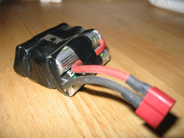

Small battery pack update
Yeap, I were. Those was the only batteries I used the whole day.
cool deal.. i will have to run those in comps then.. specially if they last you 15-20 mins.. they should last me longer with only one motor and a reduction unit ;-)
they sure was ALOT lighter than a normal pack.. at least half the weight if not a bit more. so you need 7 to make 7.2 volts? im guessing they are 1.5 volts each right?
They sure are a lot lighter. They're the usual 1.2 volts, so I was running at 8.4 volts. Which is probably why I didn't really notice a lack of power, or punch.
Reading over Energizer's pdf I see they have a 20% tolerance for some of their numbers. That can't make a good pack, not that it was a bad pack. That might even be normal. I plan to try CPB 1650 AAs.

although i hate the idea of thowing away a battery pack after one use, it sounds like a light, single use pack may be advantagous. Good idea Cory.
ahhhh, ok. i just read the pdf for the first time. i thought they were alkalines. i wonder why they are so light? I've had luck so far with my 9 cell AA pack.

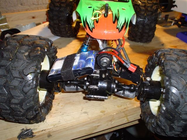

I'm posting a link to a new battery pack i just tried out , and must say were very sucessfull.
http://www.rcmadhouse.com/MadForum/viewtopic.php?p=1881#1881
You would of seen a link to my stick down here in Australia in the pic thread and seen that i was using the CPB 1800 4/5a on the front axle.

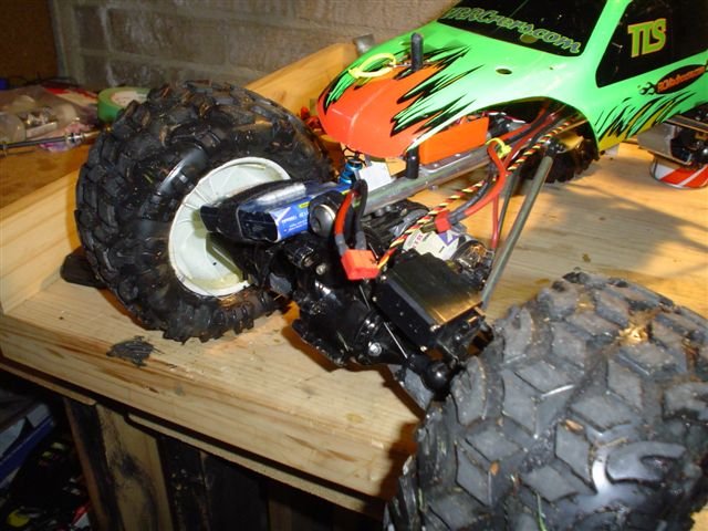

Well i got a pack of IB 1200 2/3a made up for me from i guy locally down here, i got him to use 10 cells so i'm running 12v.
You can see that they fit in the same spot as they are smaller than the 4/5a CPB cells but the beuty is that they are lower in height than the CPB pack ( great for low COG) and 10 of these cells weigh a bit less than the 8 cellCPB pack , they actually are just a little bit heavier than a lipo pack i had.
Got 30 mins running from the packs first charge with plenty of punch and only noticed a performance drop in the pack at around the 20min mark.Was a bit worried about the voltage draw on the pack but at 30 mins the pack was just warm.
Looks like i'll be getting another pack made up and use them for my comp batteries.

Kevin , i just tried that link and it worked fine .
Let me know if your still having probs accessing the link and i'll send you the photos to post.

Yep that's my only concern as well , i'll let you know how they go.

Tried them out again today and again no probs. The packs are getting warm but nowhere near hot . Have had about 6 cycles now so only time will tell.
I'll keep you guys informed
