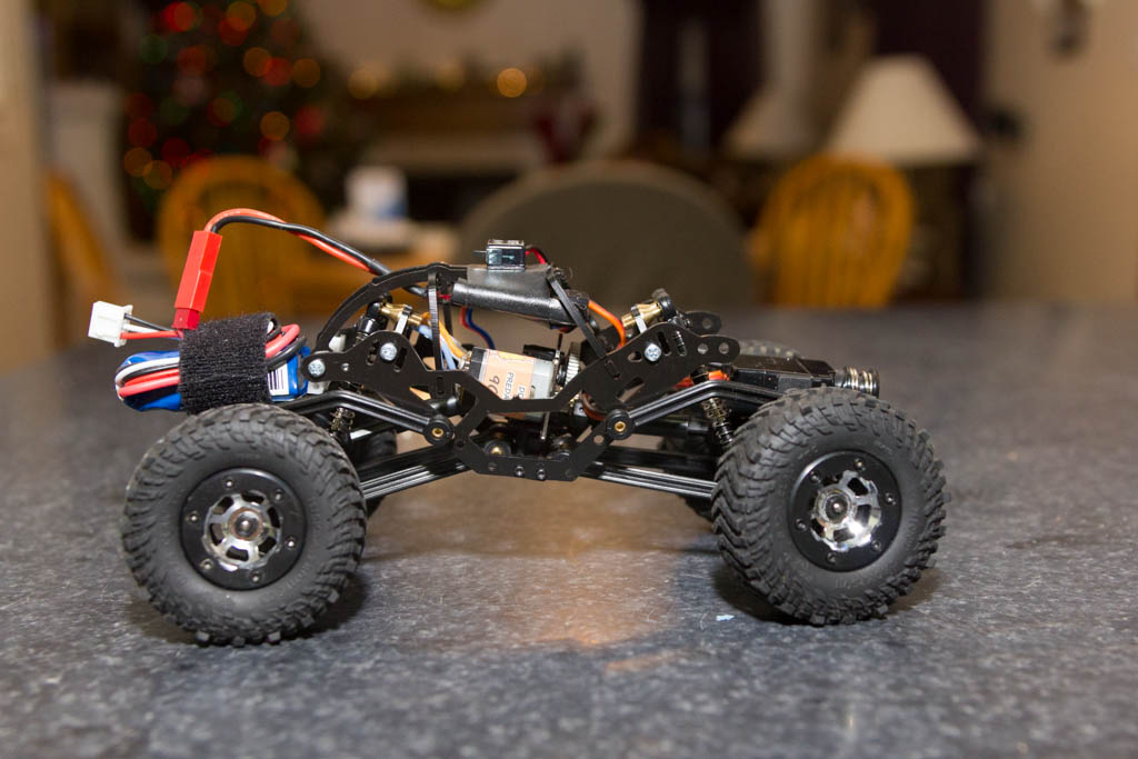

Ok it is built... built it last night..
I am not too happy with it...
1. Instructions were not included and I am not a great builder.. I require directions... so I emailed them and they gave me a link saying they need to do better instructions as this is the V2 and a bit different...
ok so different.. part my fault on this next step. They have a pic that shows the roof bars going over and have a C at the end that you put onto your battery holder that needs to be cut... well the v2 version has a D on the end and I couldnt figure it out.. so said EFF IT.. and cut it into a C...
then I look over and ask my son what the white piece is ... well it is what goes through the D instead of cutting it... UGHHHHH
2. stupid nit pick.. but I did pay good money for this kit... but that piece is white... really.. a fully black rig with a white piece in the back?????
also it has 4 screw holes.. and they dont line up so you cant screw all 4 in... only 2.. which is ok as the shocks hit it.... so had to twist it to vertical instead of horizontal.
3. the pic on the site shows the orange panels... I figured the panels would need to be colored... or painted by me... but I didnt expect them to NOT COME WITH IT!!!!!! dont think I would have bought the kit knowing this....
4. the esc in the pic on their site looks like there was a mount to put the esc on... ummm no it just sits there.. for now we electrical taped it in.... I dont like that one bit... oh well.....
so I need to make longer links... cut wires and make things fit better... I know my son will like it when we are done...
I am in no way putting down the build.. it is ok... I am not impressed with it though.... and I rely on the pics when I buy stuff and little modifications as my 2 kids do MANY sports and I just dont have time.... I expect to get something.. put some time in and get it running with minimal effort...
my son started playing with it and he is happy with it.. i told him we will get it going better soon...
anyone know what I could do for panels like they used? it would hide some of this stuff....
only pic I took last night...
blade by TeleFragger / RootBreaker, on Flickr
I totally feel your pain, that's how it was when i got the Ridgeback chassis, its really hi quality work they do, but lack instructions of any type, i had to google images and search youtube to try to catch a glimps of how it went together. And i just got the Blade SMC 5.5 EX and looking at the bag of pieces, here we go again lol. For the panels, you can try home depot and get some aluminum sheet, really thin and you can trace and cur with scissors, or finds some lexan and do the same. looking at the pick it looks nice good job. "thumbsup"
