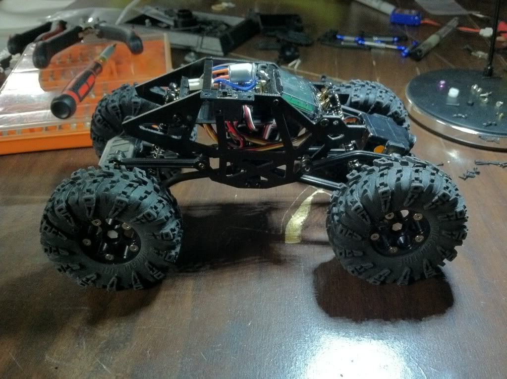

I was not having any luck with the RidgeBack TMC from Blade, or at least it just was not performing like the Blade TMC and I wasn't looking to loose performance, so I picked up the Micro Eclipse chassis to test it out. And I am pleased with the results.
The Build;
Micro Eclipse Chassis
Tekin B1R esc
BWD Beadlock rims
BWD Wheel Wideners
MiClaw tires
HS-65MG servo
Predator 90t motor
DSM SR3500 Micro receiver
Bent lower rear links
56t aluminum spur
Rear axle lockout
BB's for front wheel weight
Aluminum skid plate
Losi 2s 300mAh LiPo
DX3s Transmitter
Trail Trekker drive shafts
Trail Trekker upper links front and rear
Trail Trekker lower front links

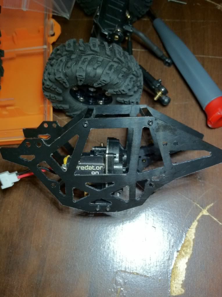

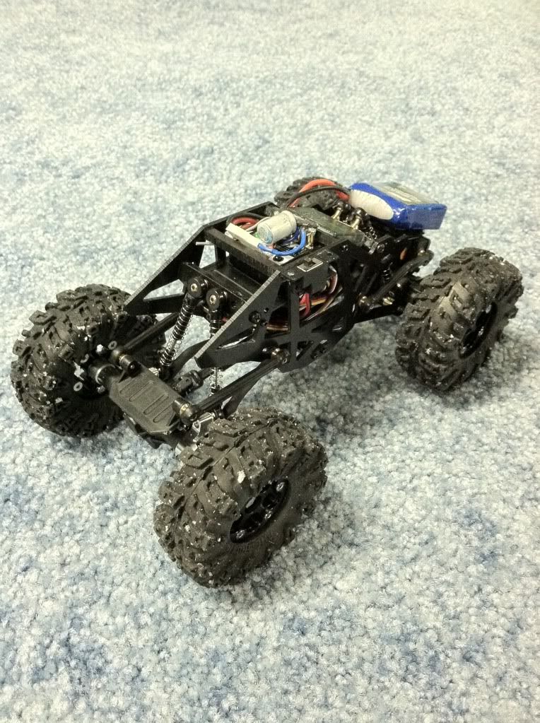

Here is the frame assembled;

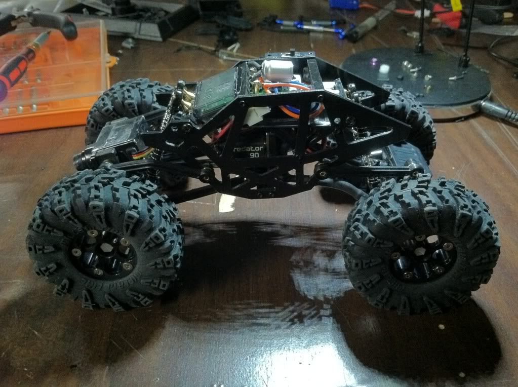

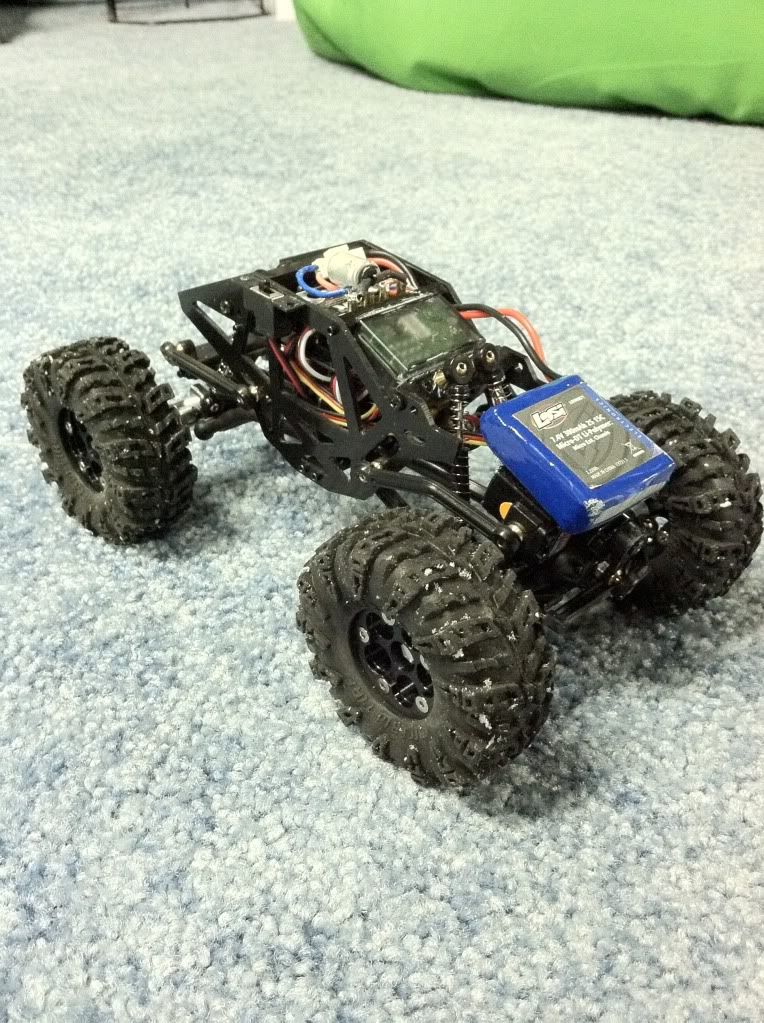

Then I added the esc/rx tray from a stock MrC, yes for some reason everything is crooked in this picture;

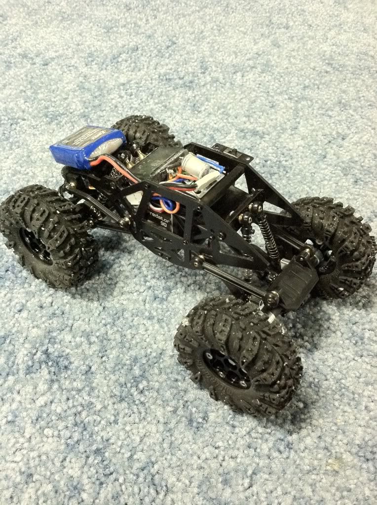

Here it is assembled;
On/Off switch mounted to the side top, possibly a bad idea...

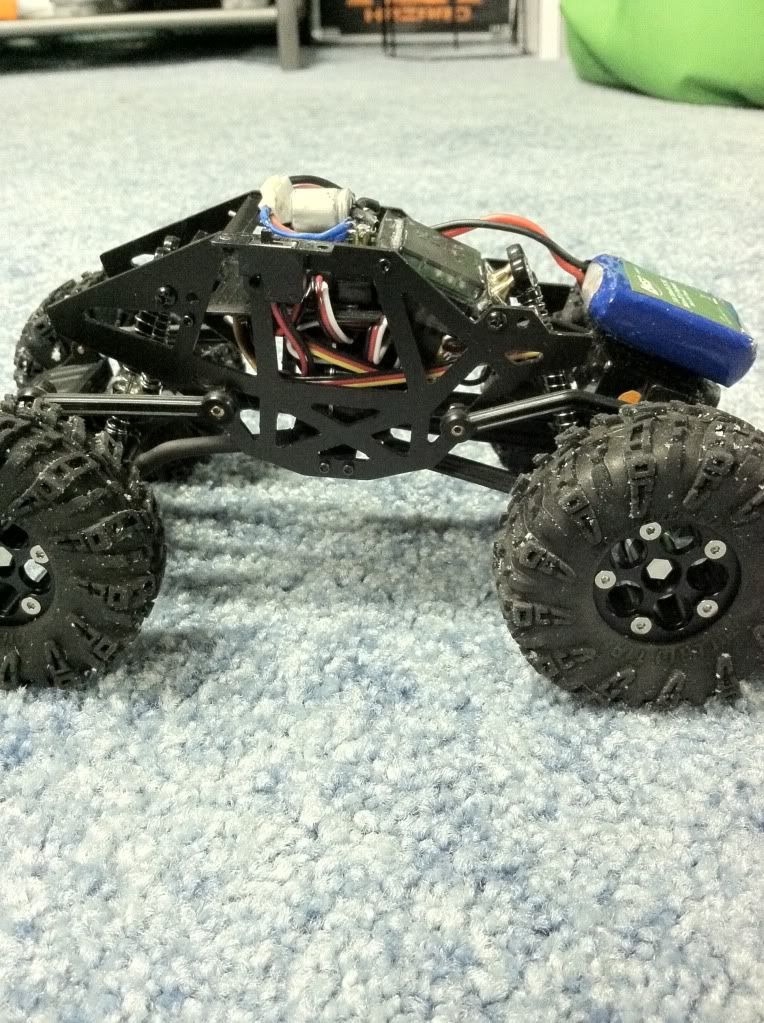

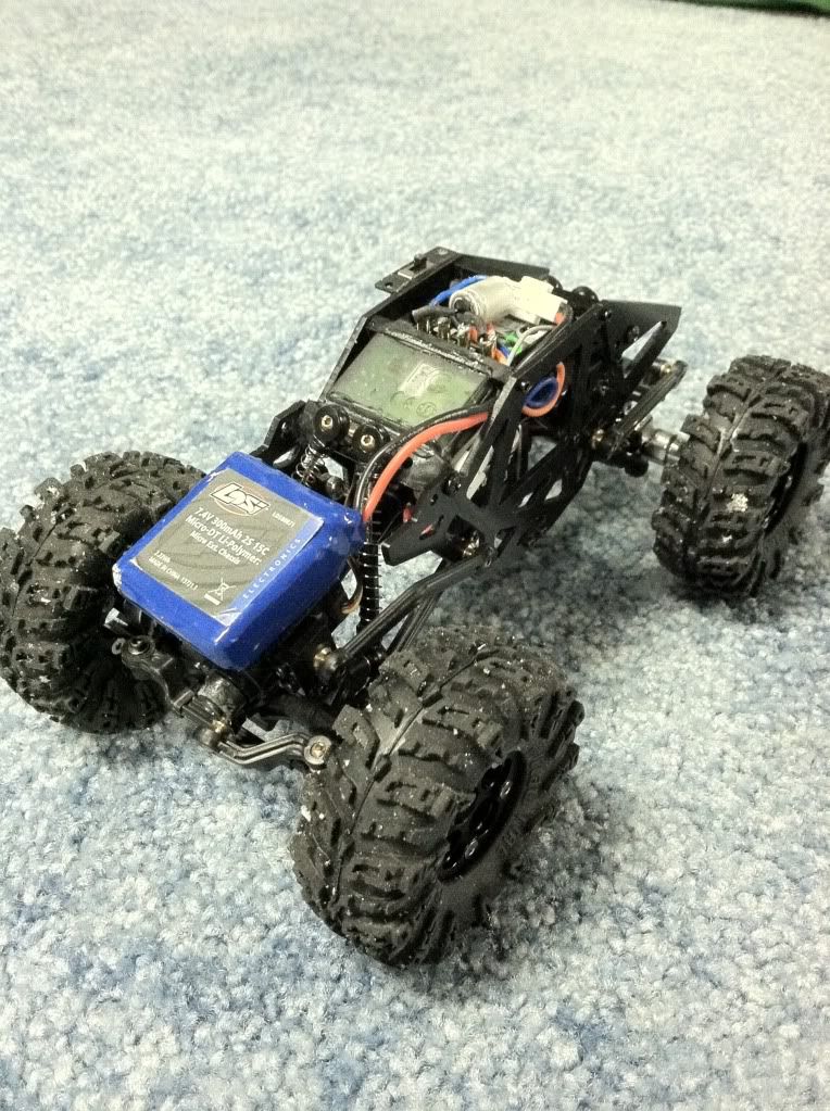

Battery mounted to servo and ready to crawl;

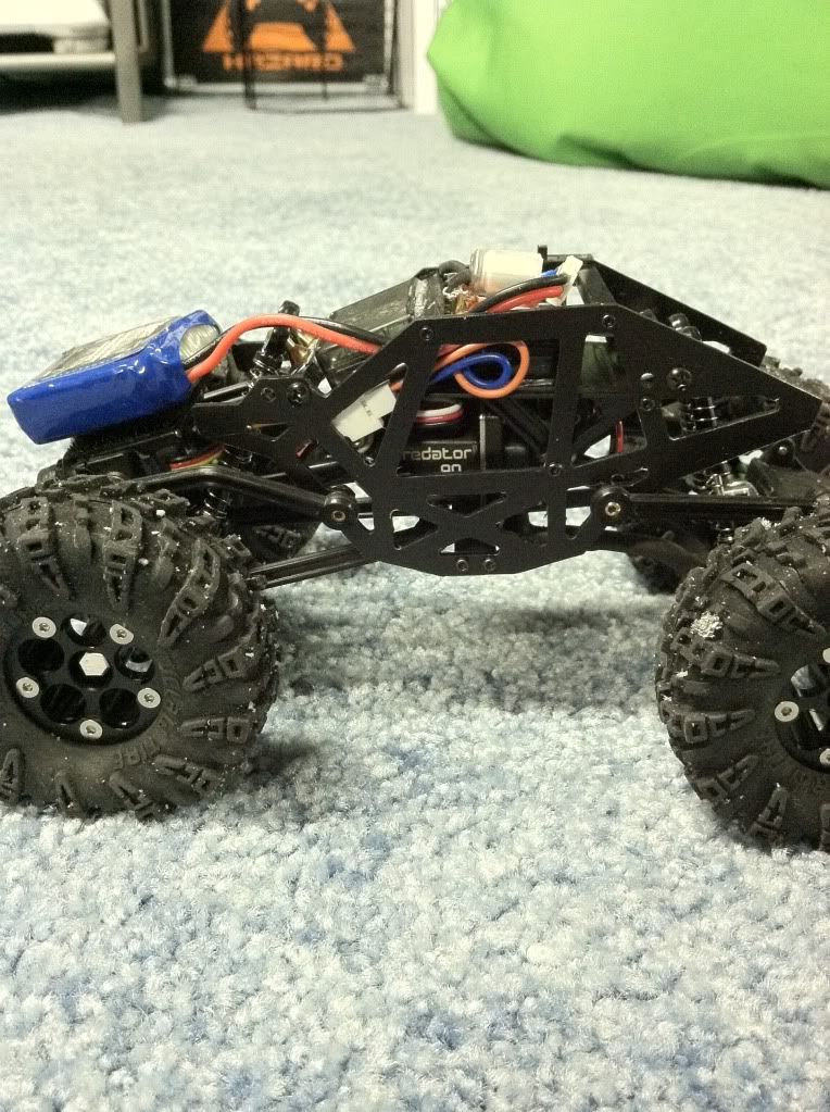

I've rotated the rear tires to get a reverse tread pattern, I'm going to see if that improves performance.
Update:
After crawling on my course for awhile I decided to remove the rear suspension springs all together. And it was a major improvement! Front suspension is still straight up stock MrC.
