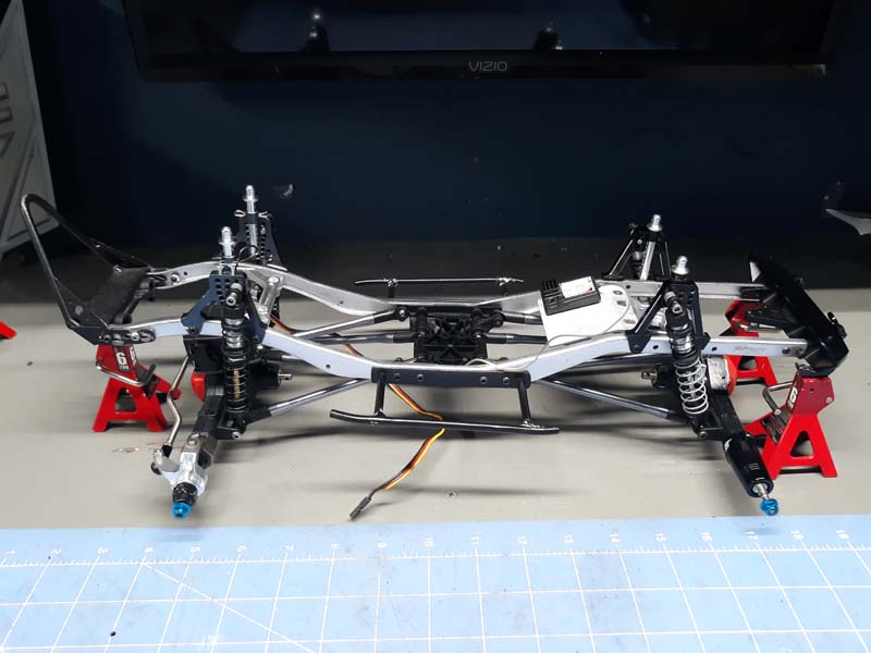

But then I dug though my Axial box and found pretty much an entire SCX10 chassis in aluminum bits. So I decided to just run with it... Through the magic of the interwebs, it's here in all it's glory! Left out was hours of digging through links, hardware, and all the random bits and bobs that go into putting a chassis together from random parts.
The chassis is from an Integy trail roller I got in a trade. (and the trans actually) The chassis itself is garbage - even for Integy standards...it's aluminum and light, which is good, but it's as flexible as a Russian ballerina - not so good. Pretty sure it's already bent in bad ways, but it's what I had so started bolting stuff to it. All the chassis span parts except the skid are aluminum which helps stiffen things up, but I'll be replacing the chassis rails with something better ASAP.

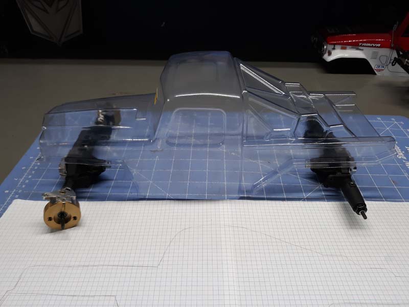

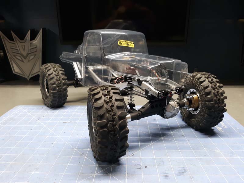

Dropped on the tissue paper body to see how I like it....turns out a lot! Has a pretty badass stance imo. Wheels are TBD, have a few options I'd like to try out, but the TSL's are staying for sure.

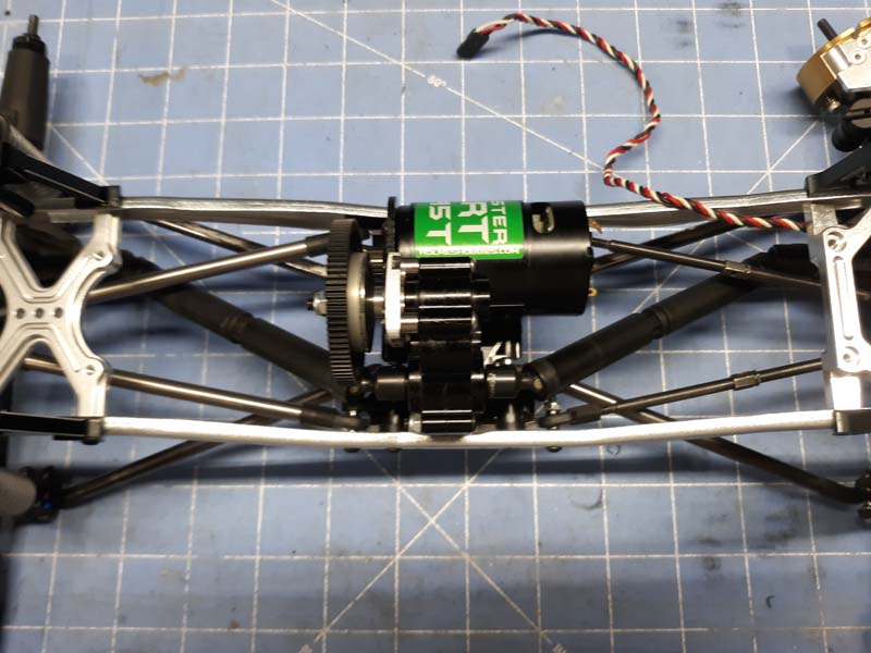

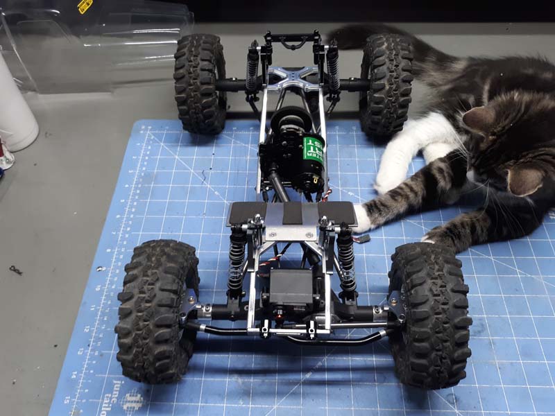

Had a Holmes 45t motor sitting here that I ordered by mistake for my TRX4. May as well put it to good use! Newest and shiniest part!
Got the transmission and driveshafts in. Very funky layout, though thankfully there's no binding. Trans outputs have to be on the opposite side of the axle or the shafts hit the upper links. Have to say I really like Wild Boars...they've held up well for me and are easily trimmed or sized to just about any project. I do like the older style though simply as they are a bit smaller. I tend to mix and match old and new parts as needed.

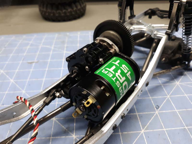

Aluminum trans case, steel gears inside. Super smooth and plenty strong. I shaved the threads on the input shaft at some point for some reason, and now I can't fit a slipper spring so I used a compression washer and a nut... should slip only when bound up, and only a little. In theory of course... in reality, it basically eliminated the slipper.

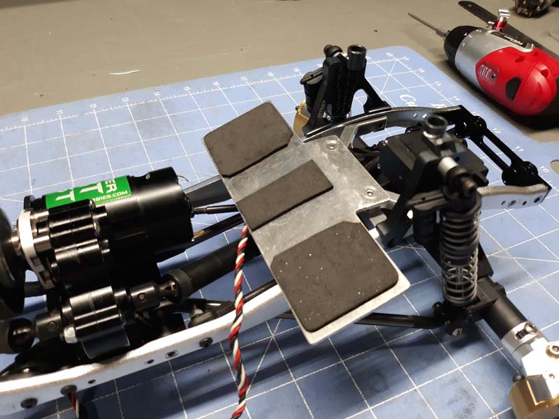

I must have made this simple battery tray a while ago out of 2mm aluminum. Good to get started, though it's a bit heavier and bigger than it needs to be. I used to run 4-5k packs for long trail runs, though I've moved over to smaller 2200 packs as of late. Not sure if I'll trim it down or what.
I always test out the drivetrain with 3v just to check for any issues. Found the rear axle rotated the wrong way.... must have used the wrong one from my 2 pairs of AR60's. Dug out the other rear and swapped them over. :) Much easier than flipping the gears inside, and they are both spec'd out the same.

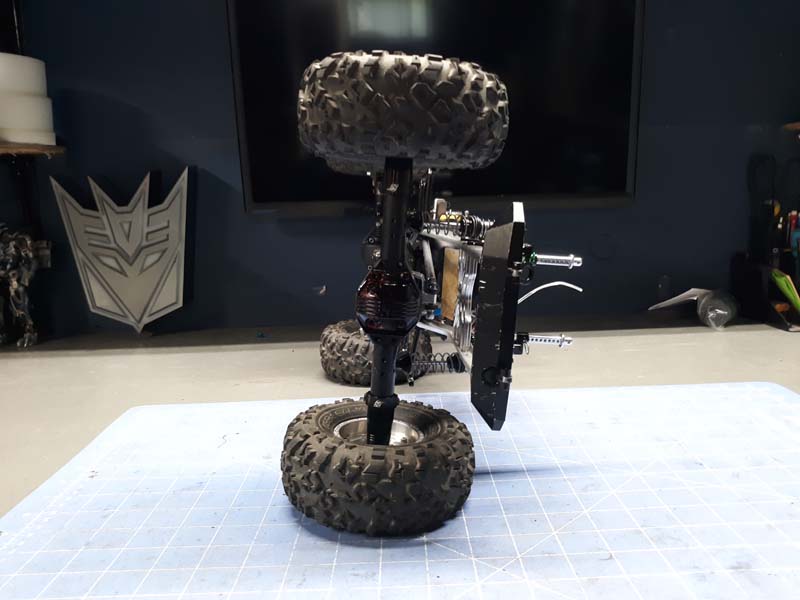

Got the steering links sorted out. What a pain! Would have rather used stock AR60 knuckles as the high steer really limits travel with the SCX10 chassis. I think I've got enough flex baked in that it won't be too much of a problem, though I won't really know until I test run.

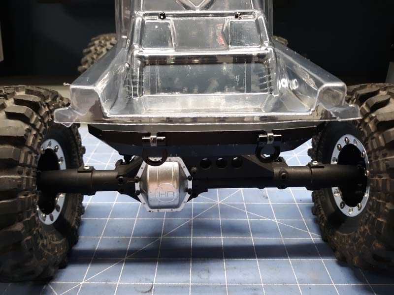

Found an SSD Deadbolt bumper in my stash, and bolted it in the back. Not sure I like the look, but it protects the rear of the body so it'll stay for now.
Up front, a big old stinger fits this build perfect. Had this one in the pile - Scalerfab or Wertymade, I don't remember. But it looks great!

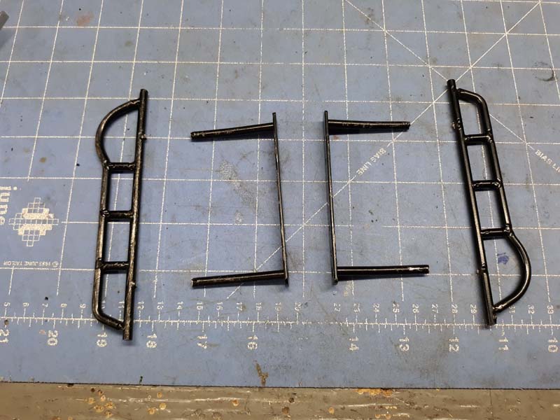

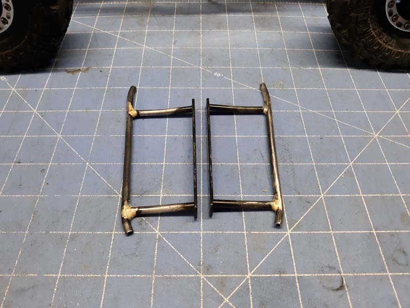

Here's where I had massive fail...I'm not great at brazing, but figured this was simple enough. Found some RC4WD sliders, but they were super wide compared to the body. So I cut the ends off, trimmed them a bit and re-shaped them to fit the body.
All was going well, if you call having a ton of trouble with the flux, burning the heck out my leg, and almost burning down my workbench going well. Realized I brazed one of them backwards so I fixed it and got here... Not bad, right? Sadly, it took almost 3 hours to get here.
Then broke out the flapwheel, cleaned them up and painted them. Went to mount them and realize I "fixed" the correct one, so now I have 2 that are brazed backwards. Each with 2 lovingly applied coats of satin black. 4 hours total. So now I have to strip them down cut them up, and re-do them the right way. Basically start over.

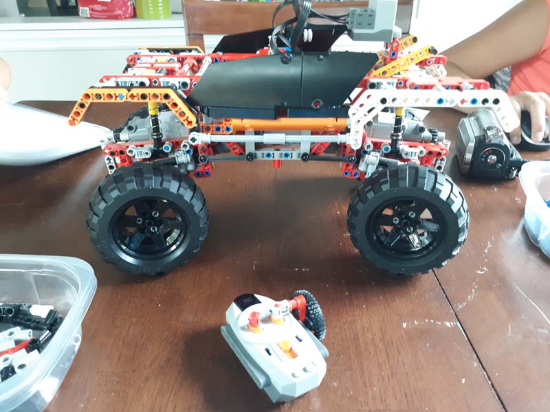

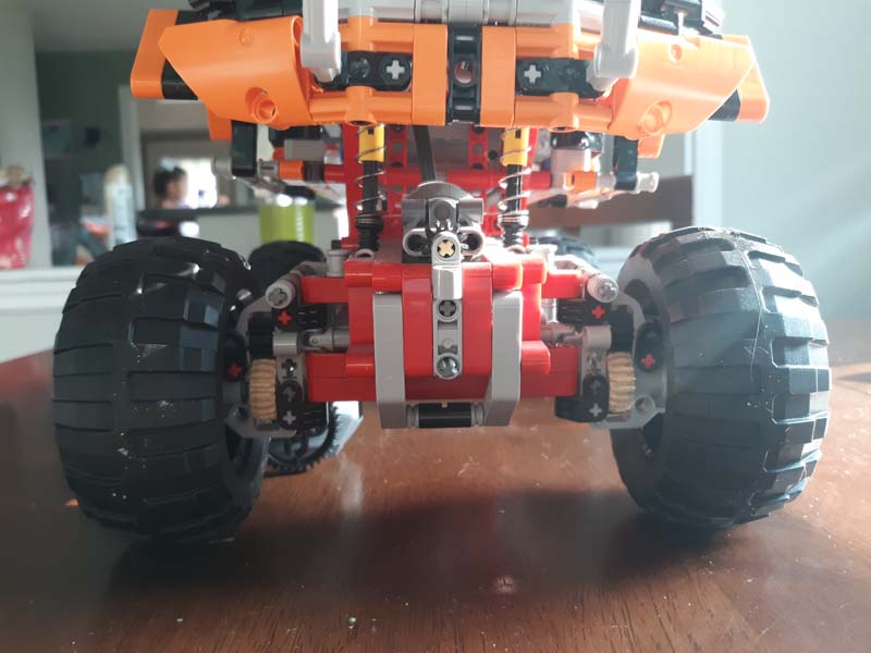

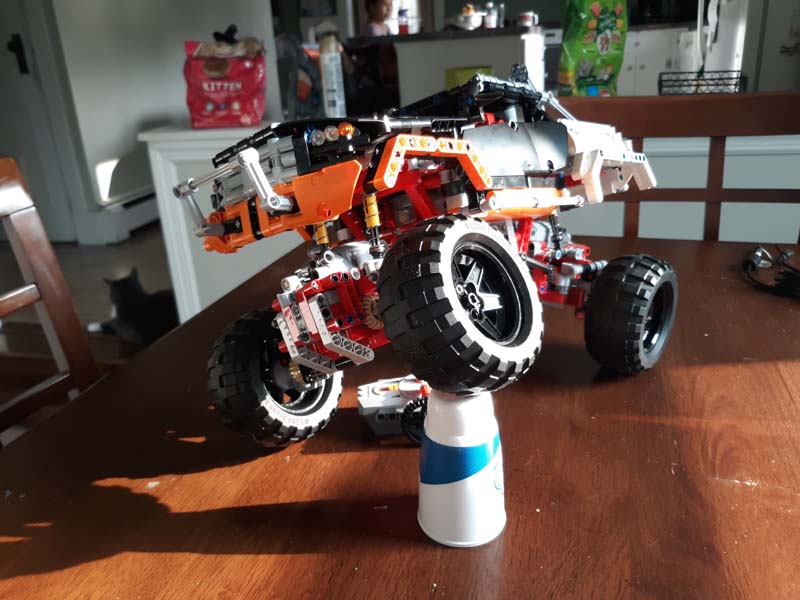

Frustrated with myself, I had to walk away for a bit and decided to finish up a project I've had laying around for years - my Lego crawler. I lost the decals along the way, but with some help from the girls I got it finally finished!
Flex shot..
And yes, it actually has portal axles! Pretty cool how it all goes together.
Consider that a minor win... So at least I've got that going for me which is nice.

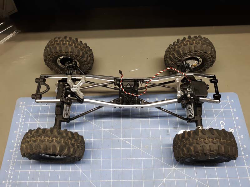

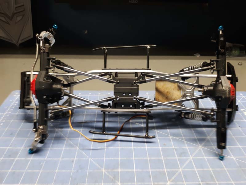

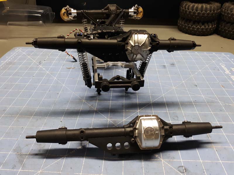

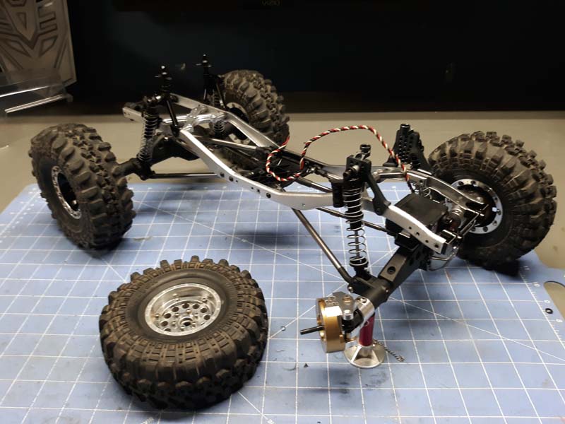

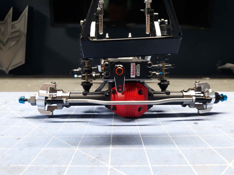

No matter, still lots of spare parts laying around. Had this pair of XR width axles on my 1.9 Wraith so I stole them for now....
Set up pretty nice internally...OD/UD and FI lockers. Took them apart to check them out...all was well, just re-greased and bolted them back together. Found an axle mount for the servo in my parts bin.
Axles are still pretty wide, I'm thinking they'll be ok with 2.2's.

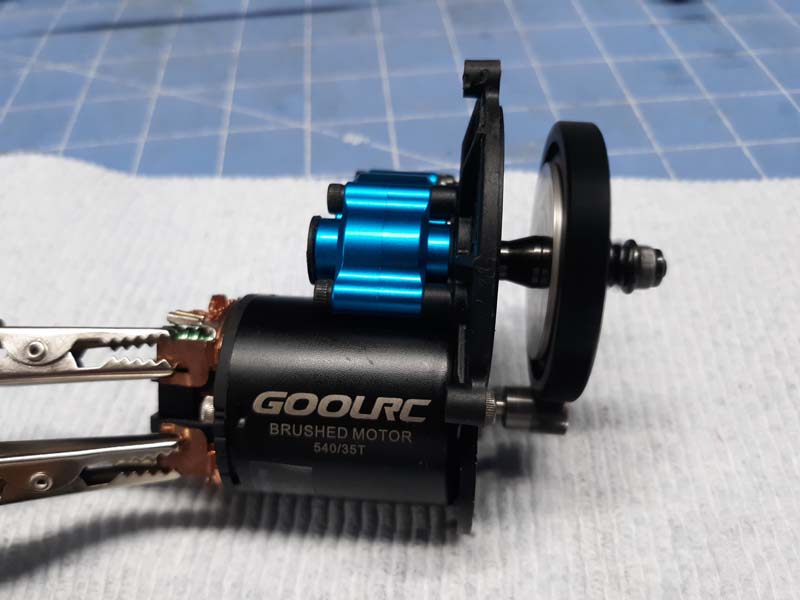

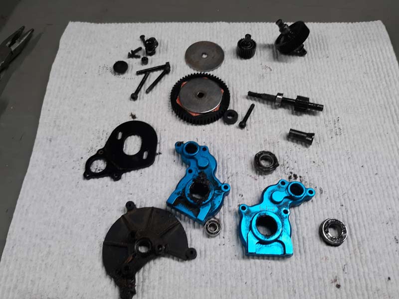

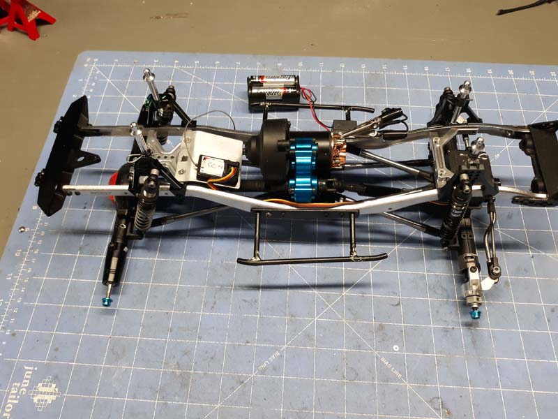

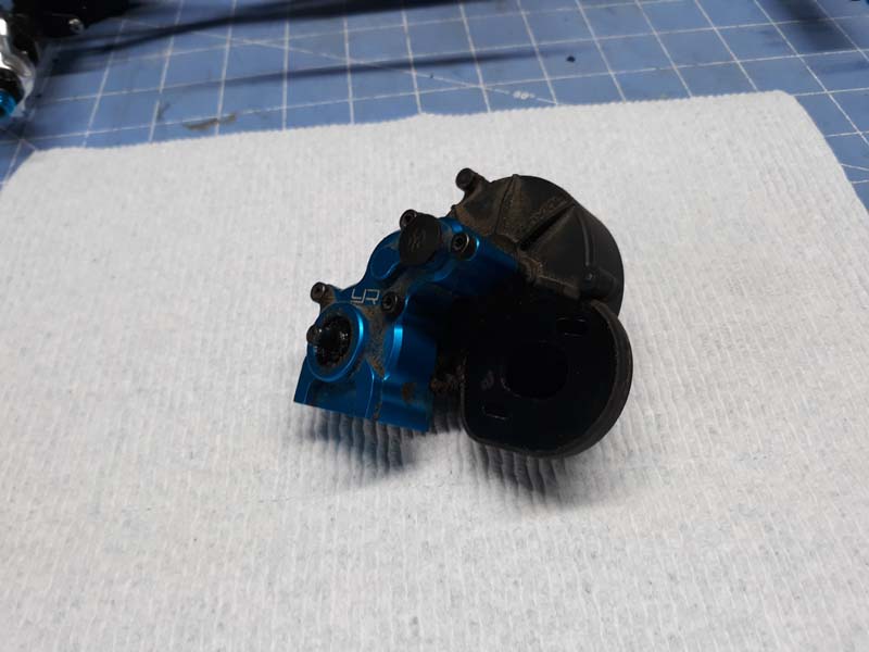

Made a trade recently for an SMT, and it had this trans inside of it. Have some other plans for the transmission, so this came out.
Opened it up to check it out...aside from a TON of grease, it's very well built and in great shape. Full metal, should hold up fine.
Cleaned, relubed the bearings, and rebuilt. Spins like butter. Frankly I love these old 3 gear transmissions. Built right, they are tough, quiet and very strong.

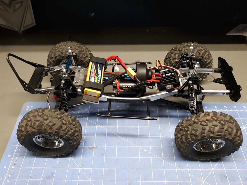

Mounted back in the chassis. Thought I was going to have to buy some driveshafts, but found an old mystery steel shaft and an old 'pede shaft. They'll do! Tested out the driveline with some low voltage and it all spins nice and smooth.

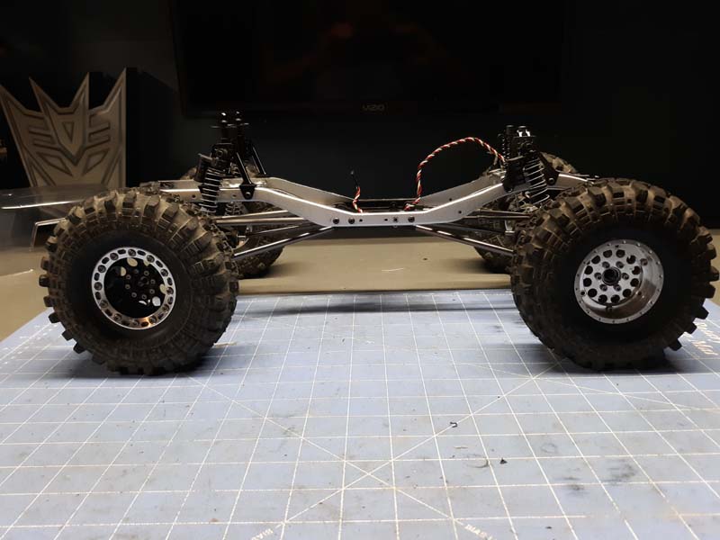

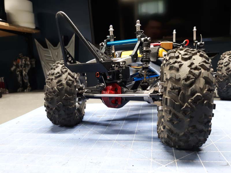

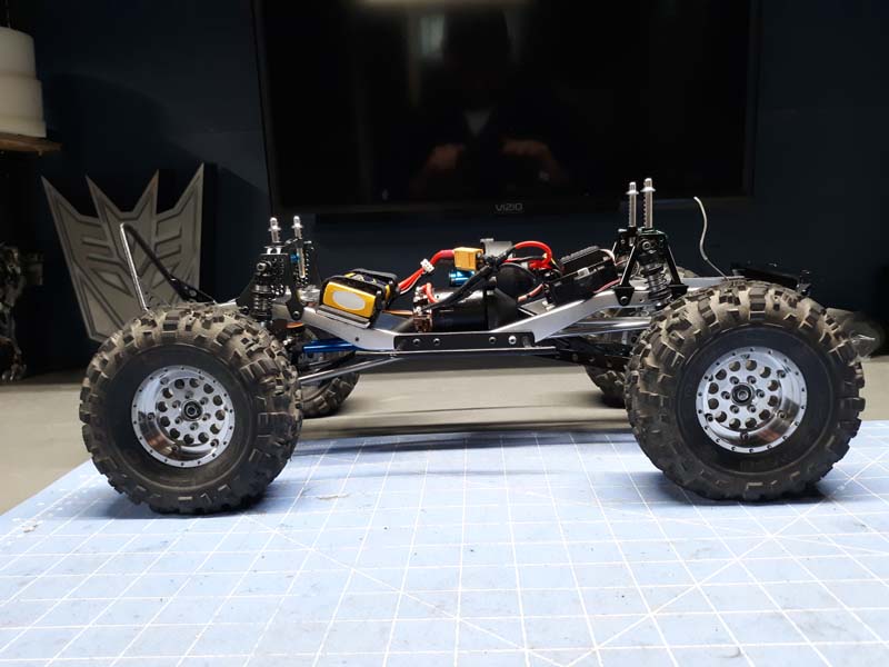

With the driveline now back in place and spinning smooth, time to sort out wheels and tires. Decided on some old CAC (Now Gearhead) 2.2's I've had since forever. These wheels really do mount to any tire. Paired up with an old set of Losi Rock Carvers with 2-stage foam. Found an AE-5 ESC in my stash and got that wired up. Mounted a small battery tray and it's a runner!

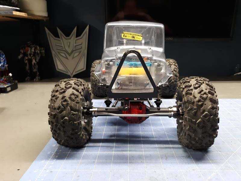

COG is pretty good! Has no trouble sitting sideways. Very stable.

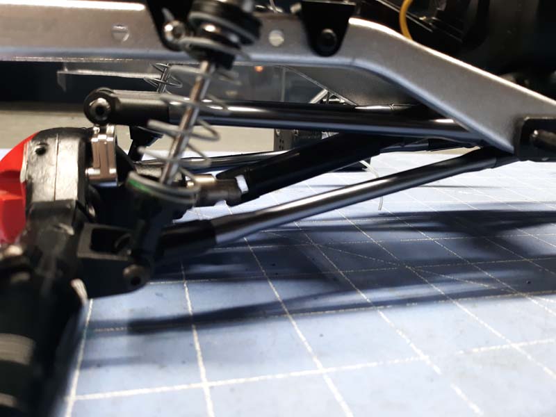

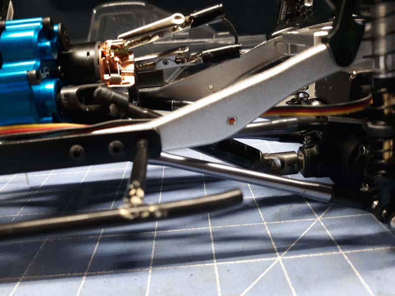

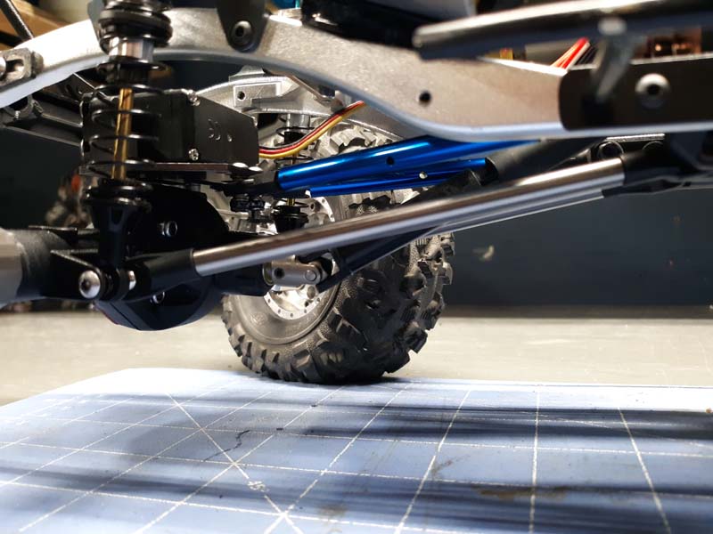

Only thing I don't like is to get the castor angle I want, the front driveshaft angle is a bit wonky. Kinda goes with the territory with the V1 axles. Used turnbuckles on the uppers for quick adjustment. Might have to fine tune this a bit.

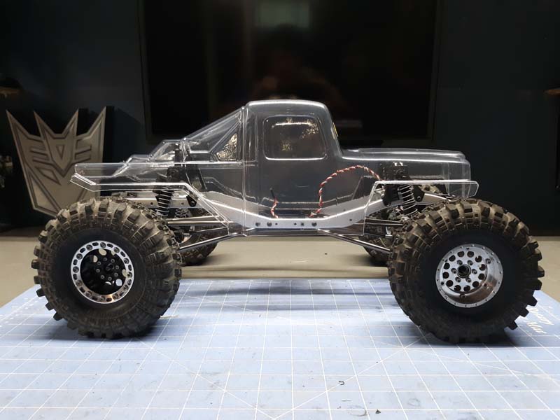

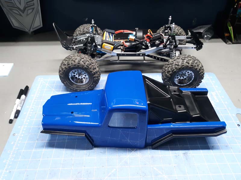

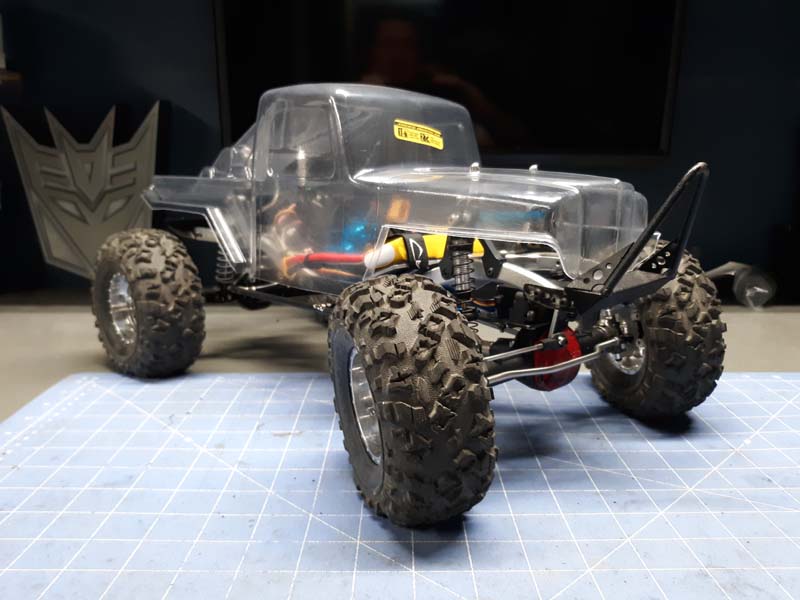

And a few posers with the body. Doesn't quite have the stance it did with the AR60's, but still looks pretty decent. Off to the paint booth!
Oh and eventually I'll get around to fixing that spring....I have no idea how I did it, but one of the 2 stage setups in the front is upside-down. Now that I noticed, it, I can't unsee it.

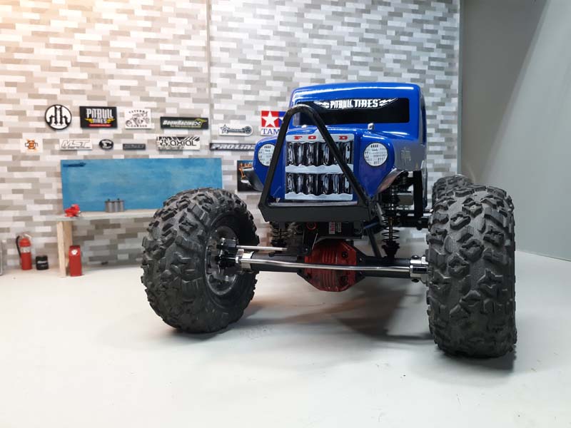

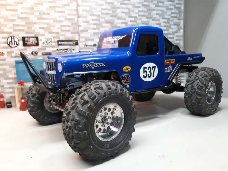

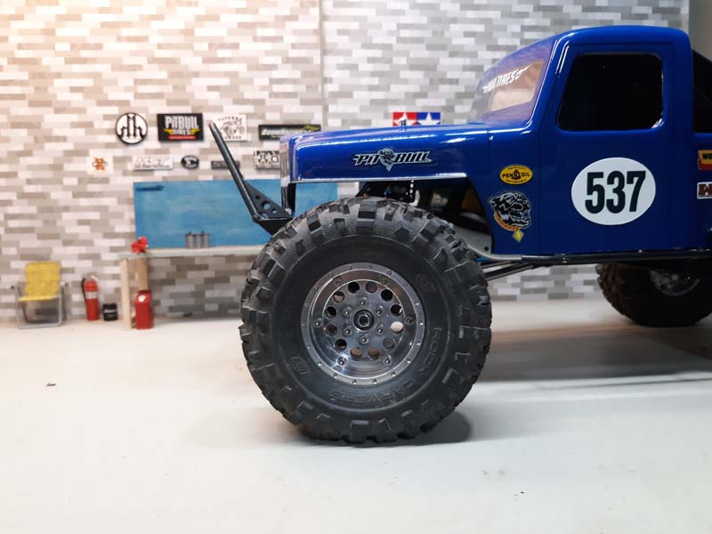

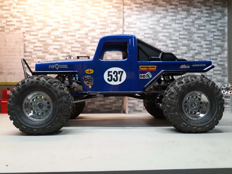

Got some paint on the old girl, think this one's about done...
Had a bunch of fancy ideas, but in the end I just went my favorite simple blue. I'm almost out of fascolor blue, and supplies are really drying up...been using it for years. Not sure how many more are coming out of the basement with this color. :(

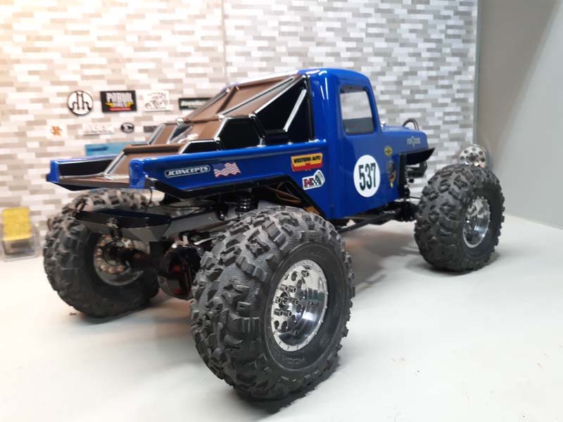

Dressed it up with some vintage decals here and there and called it good. Really like the way it came out, has a nice mean stance.
Weighs in at 7lbs exactly with battery, 54.5/45.5 front bias. Should do just fine out on the trail.
Excellent breakover and approach angle. No panhard means that front axle can be pushed out pretty far.
Very happy with it for just being stuff I had laying around. Came together pretty nice! Can't wait to get out and shake it down.
