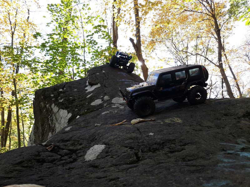

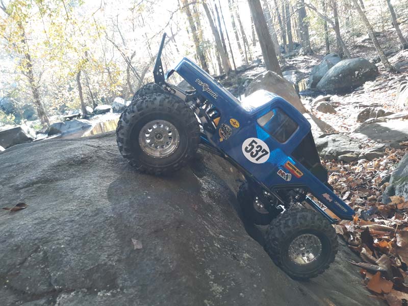

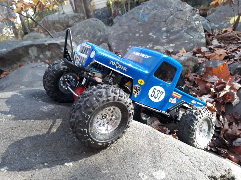

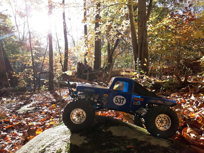

Man alive, I thought this would do pretty good, I didn't expect a rock killer... holy moly. Only adjustment I made from off the bench was to put the shocks down a hole for more ride height. This truck is so planted, it's crazy. The width of the axles, big contact patches from the 2.2's and light body up top means this truck goes just about anywhere. Just have to mind where those big center pumpkins are... :)
Wasn't all sunshine and rainbows.... the servo was weak, my 'pede shafts up front kept popping off, and the motor was super hot at times... need to gear down, but it's off to a great start.
39 degrees at the start...beautiful fall day though. Love the crisp air and smell of the leaves.

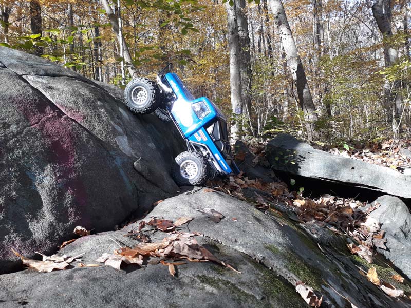

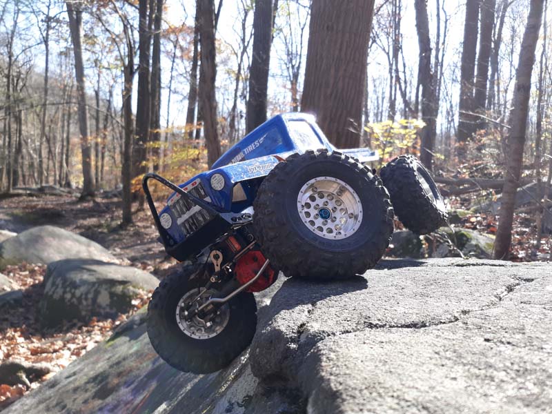

Twisting all over...Great flex. I will outboard the rear shocks I think to plant the rear better, though I'm not even sure it needs it.

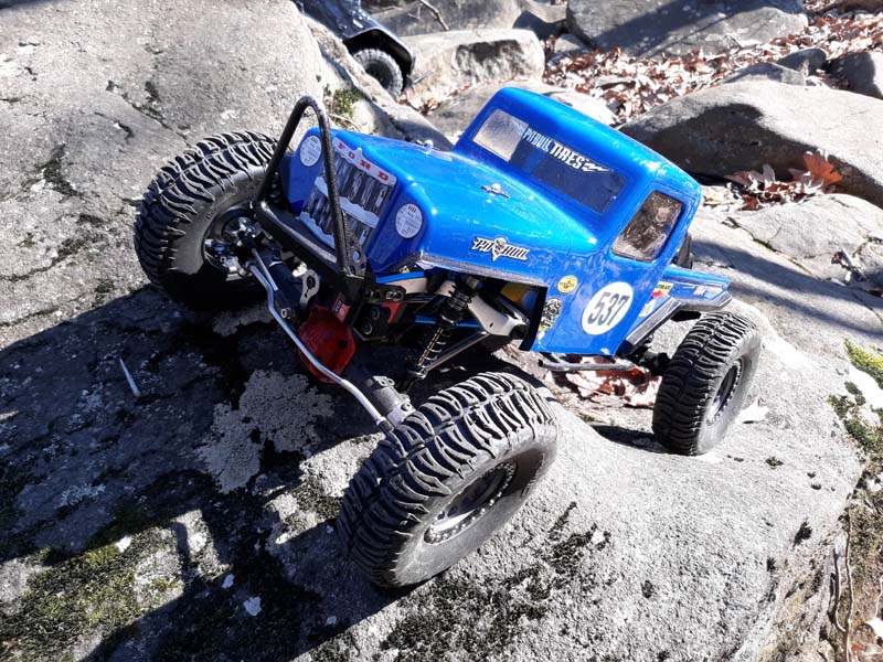

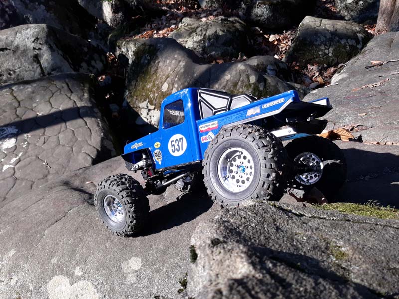

It warmed up pretty quick and the Rock Carvers softened up quite a bit and started biting much better than when we started...

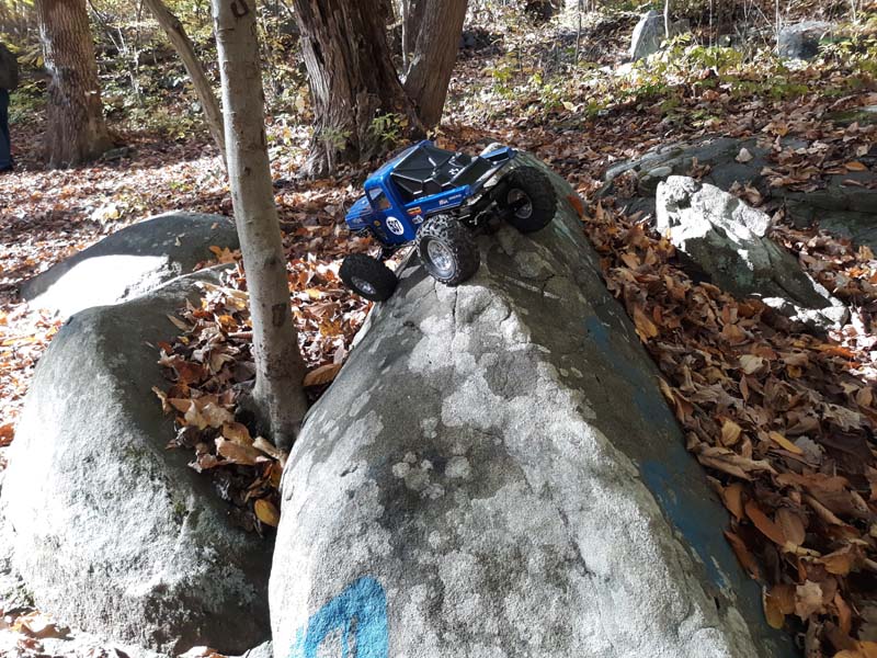

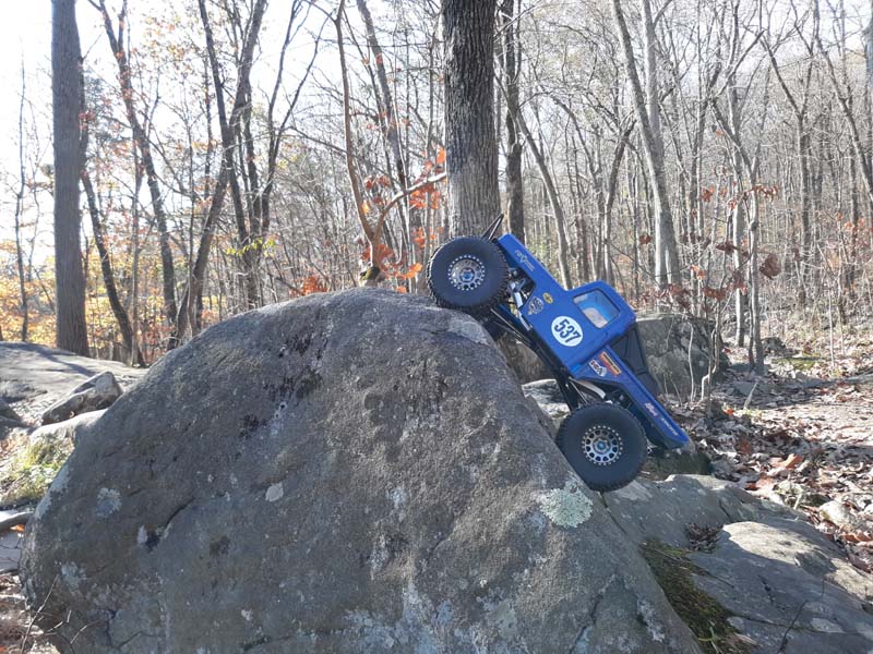

Test rock... usually don't do the left side as it's so steep. No issues here today.

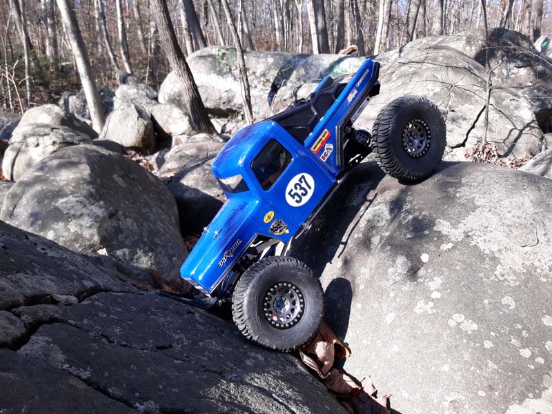

Another climb that's usually pretty tricky. Large lip at the top of the rock makes it very easy to go backwards at the top... Not so for this truck... slow and steady and it gripped right up there.

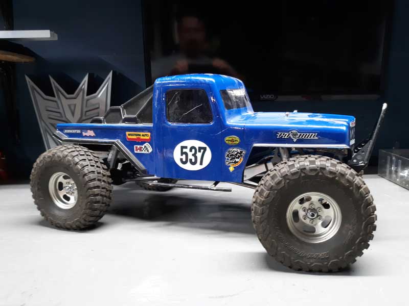

My buddy called this truck Pops - Pile O PartS...I like it. It's Pop's from now on... Off to a great start - for a bunch of random parts, couldn't be happier with it!

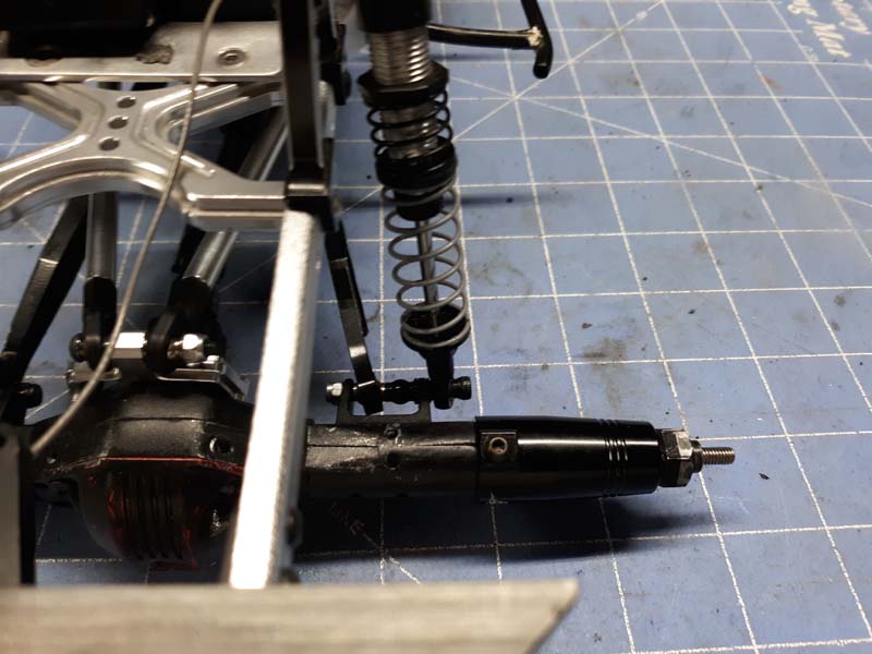

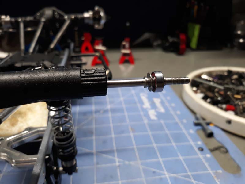

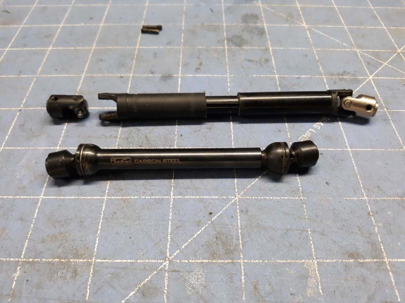

Anyone remember Stampede shafts? Popping the shafts constantly? Yes, it's just as annoying today, there's zero warm fuzzy nostalgia going on... replaced with a steel shaft I dug up.
The rear axles had a lot of lateral play. Very odd. I shimmed them with some washers until I got rid of all the slop.
Outboarded the rear shocks ..there was just a tiny bit of torque twist, not enough for a swaybar or anything. This should help a bit.
A vintage looking body, old SCX10 v1 style axles and chassis....why not some vintage tires to boot? Tried out these old RC0WD tires I've had around for ages. Super stiff, though they actually broke in decent after a while. Not comp tires, but not as bad as I expected.

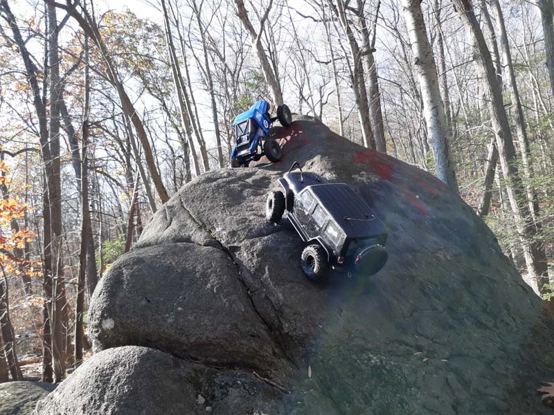

This is a hell of a climb. 60d plus, can't believe the old tires clawed their way up there. My buddies TRX4 did as well, super capable truck until he drove it off the left side of the rock and it did about a 6-8ft drop straight down. Yikes. There was carnage.

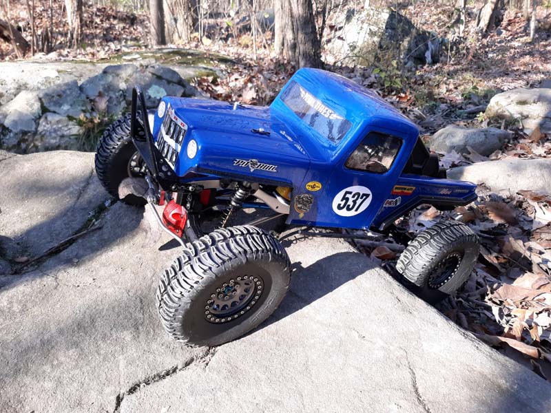

Speaking of old tires, put the carvers back on. They don't like the cold, but they were marginally better than the Gauntlets.

BTW, where did you get the old school 537 number sticker that's on the doors?

I going make my own number decal as I can't find what I want. How wide and tall is the sticker on your truck? Would you mind measuring for me? Thanks

Sorry, I missed this. About 1.75 " X 1.5"
