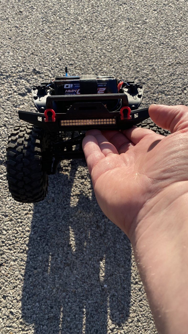

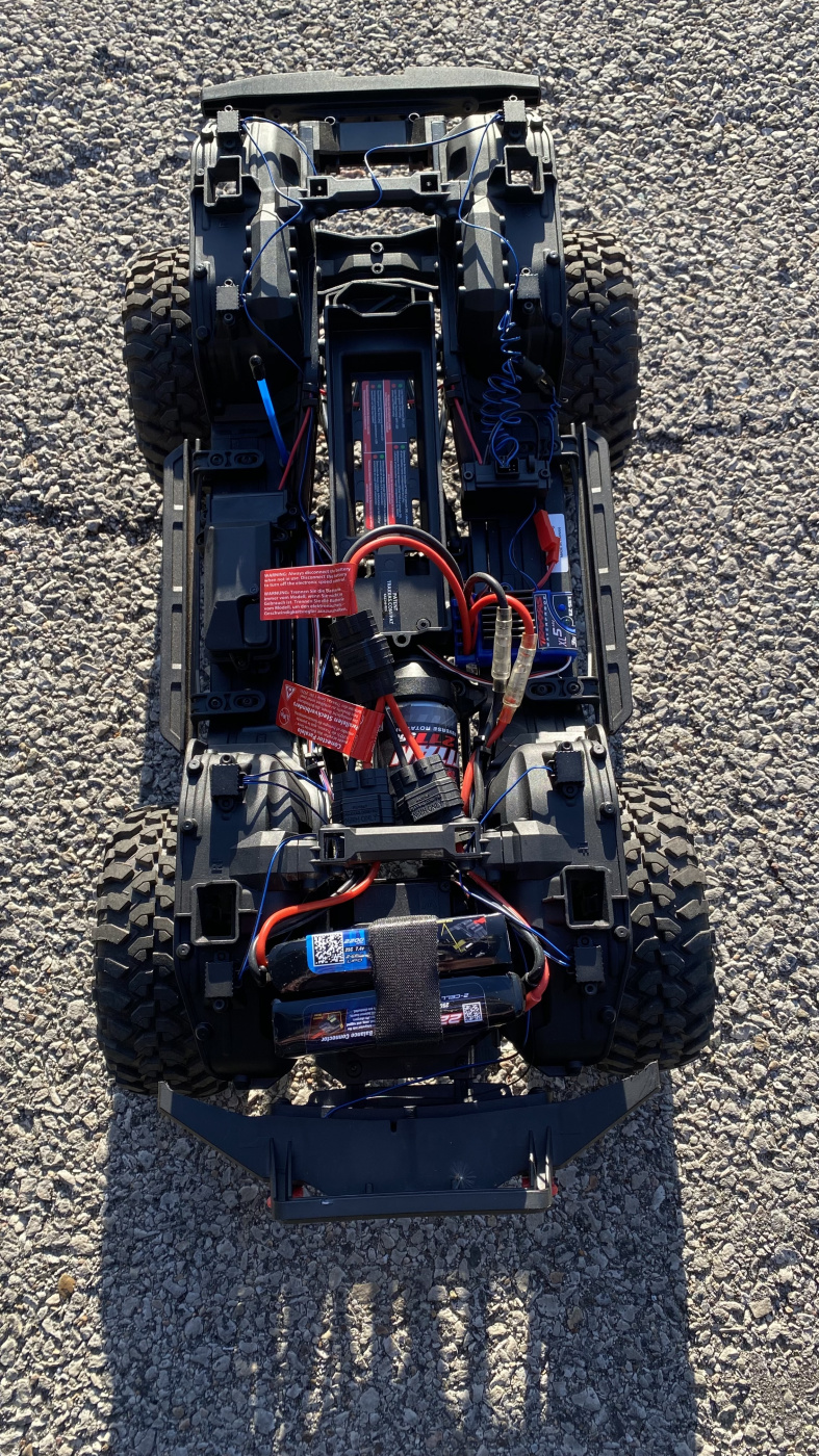

Here's my hot mess...well, two of them. I do have 1 truck where I run the battery up in the front tray. I prefer the balance better with it on the slider, but it's not bad with it up front. It's all preference really. Both places are better than stock IMO.
slider setup
stock location (TRX6)

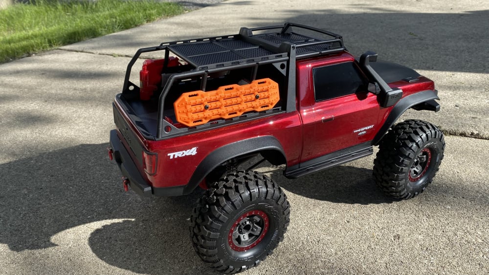

Got the body painted last night, bed lined the bed, rockers, flares front “bumper” and inside then painted the sculpted portion of the hood flat black.
I am half thinking about detail painting the lids for the roto packs, the sprayer portion of the extinguisher, as well as shovel, axe, and high lift at some point too. They’re not installed yet, but also have the 9t pinion, 45t spur and white .29 Rate springs on hand now. Also now have it set it up to run dual 2200mAh 2s 1/16 packs under the hood and have the 1/16 parallel adapter on hand so I can run both at once and have removed the hold down strap and latch from the battery box in the middle. Not gonna lie, but I’m kinda curious on what it will do now with just lower gears, softer springs, the body clearanced for the tires, and putting the 1/16 batteries on that plate ahead of the servo.
I do have the 8112 Sport Body that had the bed topper on order for it and have picked up a TQi Rx so I can use a couple of my TQi Transmitters with it. Also thinking about adding all of the optional lighting except for what mounts to the cage work since it will see some night running.

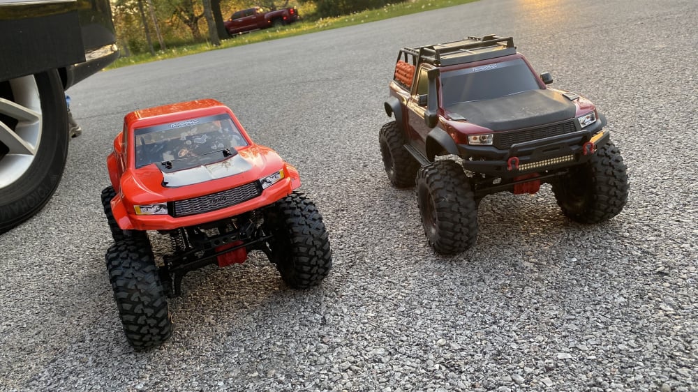

Been a while since I last posted, haven’t had much time to play with the truck when it hasn’t been sweltering here. That said, I did get new batteries for both TRX-4’s as well as a pair of T-Style to Traxxas adapters so we don’t have to swap out the plugs right away😁
I thought I had posted in this thread already but I guess not, or it didnt save, or whatever, but that flat black accent you added to the body looks really really good!
