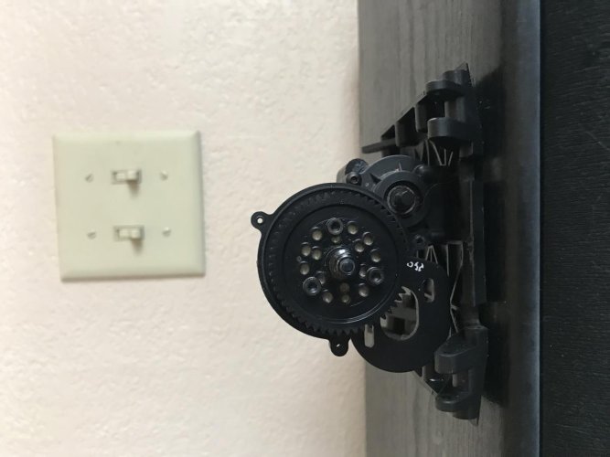

This one is a circle slipper pad. The one I linked before has a 6 sided pad. This one also attaches with a pin through the shaft.

Yes I have. Its completely stock with the 80/20 gears. Stock spur gear AXI30665

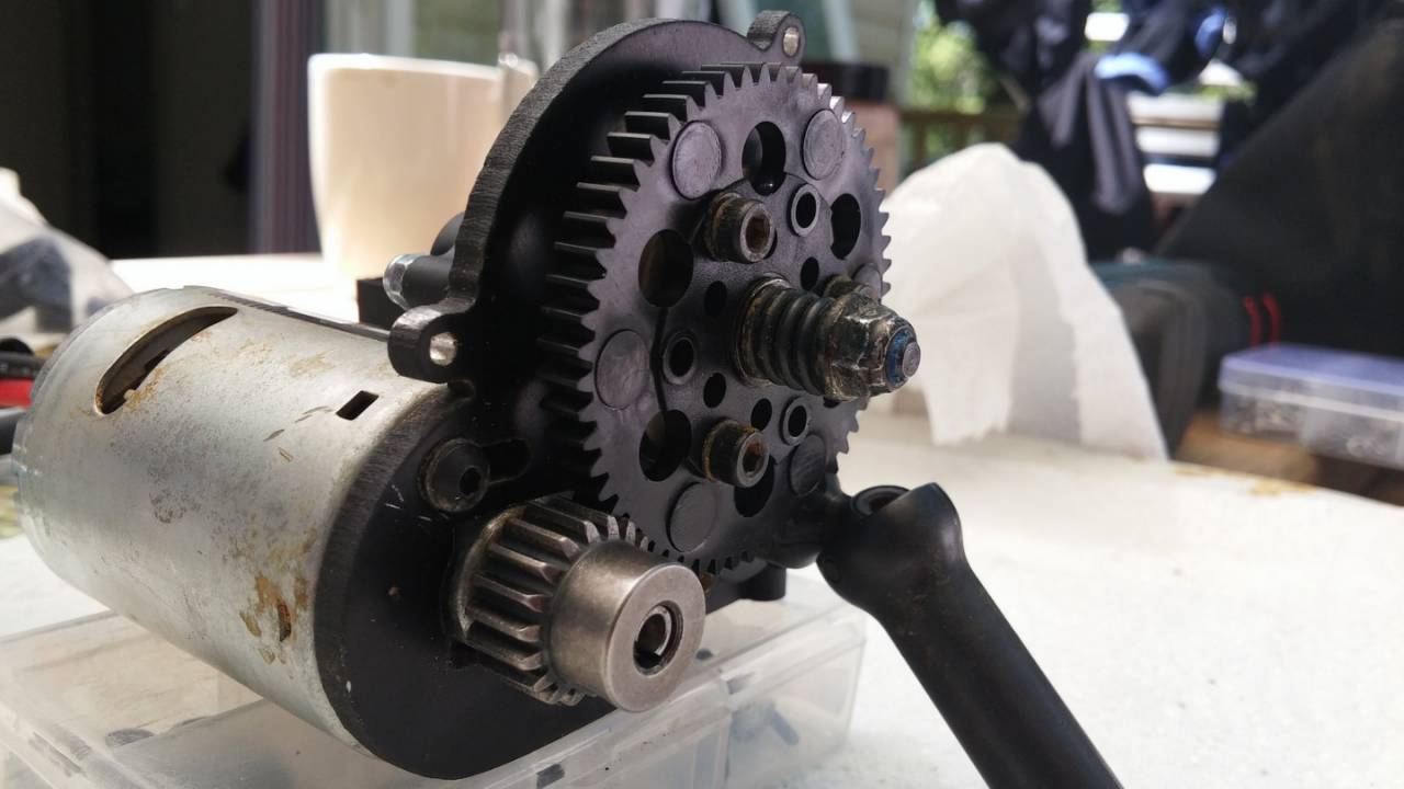

Hi,
I'm running a 48t 32p spur Duratrax*#DTXC9397 with 11t pinion.
Cheap and durable!
Don't look at the motor. It's been changed.

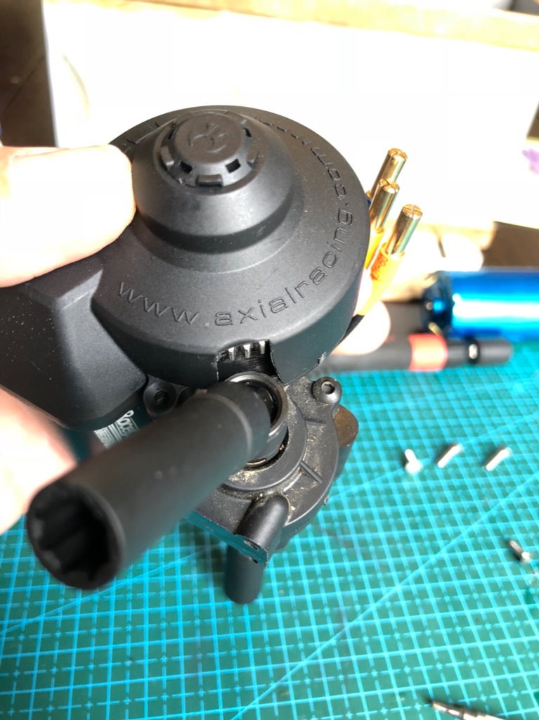

Disregard all I said. It’s a 32p 60t spur and is as large as will fit.
Trim here.

That’s why i posted both styles as there were two. 60t is as large as you can fit without contacting the driveshaft.
