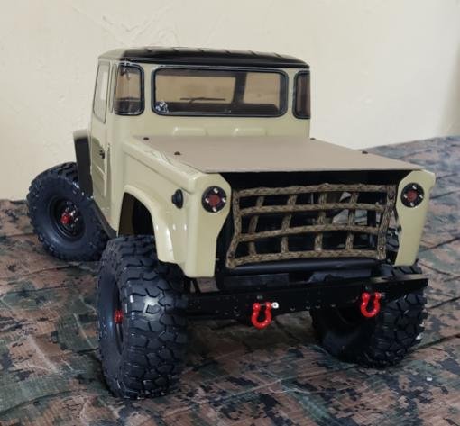

Thanks. And I couldn't resist another bedcover to cover the clutter. Flat dark earth-fall. The tailgate was made from 550 cord with the internal cord removed and a little superglue.

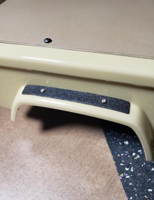

The body is finished..............for now. I added anti skid plates to the rear fenders, I'll blacken the screws. Think I'll change the wheels, get studs and bolts and black caps. Then I added a little flair.

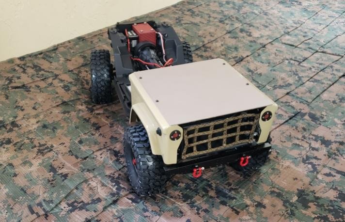

I have finished my rig and test drove it. We have a problem Houston. The right side of the body lifts up when I go into reverse. At first I thought the body was rubbing on the tires but that is not the cause even though I have the shocks mounted with the low rod ends. I also noted that the G8 tires seem to grab the carpet a lot more than the predator tires on my portal even crinkling when in a tight turn. Then I started to think (not done often) about it and then it hit me, it must be the panhard link and possibly the drag link. I took a look at how they are and it does look like they could be extended, I believe I have them screwed almost tight like the portal. So if someone could confirm my assumption before I start working on it, it would be appreciated.

when adjusting panhard/ steering, look at your truck from the front with steering centered, each front shock should be the same distance from the frame, vertically each shock should be straight up/down
edit-when doing this check make sure your lower shock pivot balls are the same on both sides, just want to center the axle and this is the only way I know to do this.

Are you only noticing this on a high traction surfaces like carpet? Also what o/d % is the trans in?
I’m wondering if it could be a normal characteristic based on o/d and high traction causing the front suspension to lift since the front tires are trying to move faster than the rear.
Twade is correct due to torque twist in reverse, the right side will lift, in forward the driver side will lift. this is more predominate in straight axle versus portal due to the gear reduction in the portals

Thanks. First, I was wrong about the lower shock ends. I was going to use them but didn't and thought I did. I have it locked in low OD and it responds the same on linoleum too, to a lesser extent.
Thanks. I believe your both right, it's natural for this to happen. Now that I think about it I think my portal did this too but to a lesser amount. I was going to get my portal out today and see how much it lifted up. I had taken off both links and added two turns, to no avail. Before I did this the alignment was fine so I'll just put it back the way it was. One problem I discovered is whenever you start flipping your rig over to work on it the shocks start leaking. I'm going to have to find better shocks. Thanks again guys.

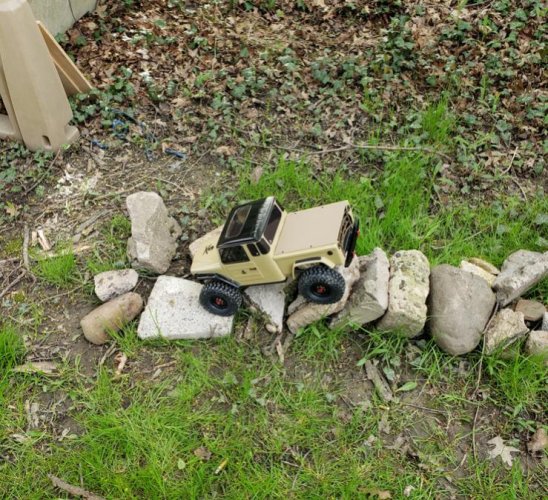

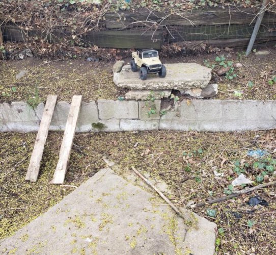

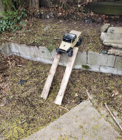

I tightened the shock collars down about halfway on the portal to compensate for the heavier tailgate. Did the same for the straight axle. Took the straight axle out for a it's first spin around the backyard rock course. It did surprisingly well, I think it has better stock foams than my Hyrax tires. I haven't dived into different foams yet just stock. But the PL BFGoodrich Krawler T/A KX tires seem to have good foams and they grab very well. Yea I'm happy.
