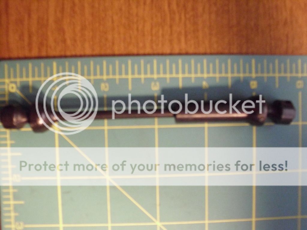

This is what I have on the silverback. WB is a little over 14". I think its a revo shaft, not sure but I can get the part # if you think it might be long enough.
Creepin king, Yes, please get me the part number, You can PM me or put it here. Thank you!!!!!!!
Cheatin, thats what my plan was if I couldnt get a purpose built one.
Thanks for all the info guys!!!!
I'll dig around this afternoon after work and get it for ya. Also if you needed a little more length than that you could use the wraith outputs on it too. Probably pick up another half inch.
