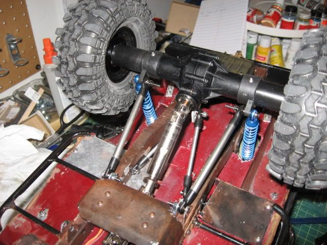

With the opening of Super Shafty and all the great upgrade parts coming from them, I thought it would be a good idea to give a review of the items I purchased and installed on my 1/6th scale Willy’s.

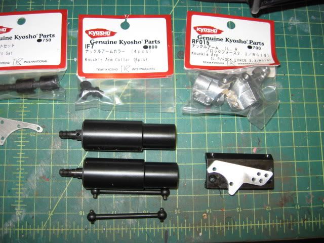

I picked up several items from them, 2.2 Short Length Lock Outs #SS-102, Diff Spool #SS-107, Rear 2.2 conversion Dog Bones #SS-105, Front 2.2 conversion Dog Bones #SS-104 and Front "Stub Carriers" #SS-106 along with some stock Kyosho parts.

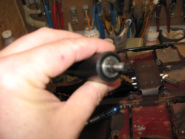

Finish on all parts was great, no complaints at all. Assembly went smooth on the rear lockouts. The only thing needed was some sanding on the outer diameter for the cut down side to slip in easily. This is normal though and is not because anything was incorrectly made. This is a huge improvment to the looks compaired to stock.

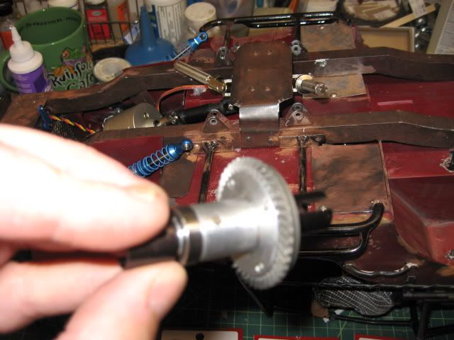

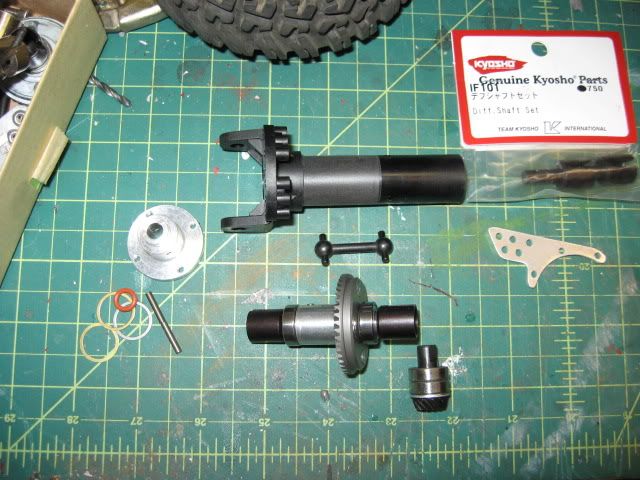

The diff spool is well made and a needed upgrade, all parts needed come with it minus ring gear. Stock one will bolt right up but I chose to go with the Kyosho Helical set Part #MA050. Dog bones are nice and beefy and fit the way they should, another good upgrade even for stock width applications.
All in all, the rear went together great, looks perfect under the Willy and will outlast the WK or Axial most run today. I give it a big thumbs up overall.

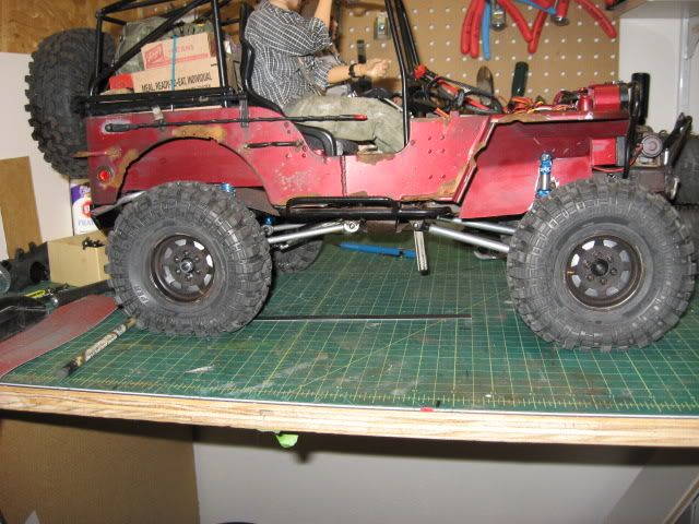

WOW.....:shock:
Your build looks SICK as HELL :twisted:
That rear axle fits perfect under there...........Thanks for the review "thumbsup"
But can I see more pics of the chassis & body?
From what I can see that chassis looks BEEFCAKE :shock: Did you make that?
And that body is..........WELL.............awesome !!!!
Cant wait to see video of this thing rolling down the trails
Very Nice.........Two Thumbs up "thumbsup""thumbsup"

Thanks Rick, your parts all fit it perfectly, about a 3rd of the tire sticks out which is just what I wanted.
Here are more pics of the chassis from when built. It is solid alum.
I'll get some more current ones later today.
wow, that is beef, that must be at least 1/2" if not near 1" stock! might need some lightening holes:)
great review too buddy. thanks for showing us these awesome parts in a build.
Thanks, the from is only 12mm wide and 15mm tall, not bad for weight compared to the rest of the rig, everything is 3/16 solid rod, need to keep try and keep the weight low and the frame helps.

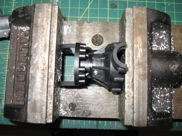

First thing you do is decide where you want to cut. I took the easy route and made one cut on the long side down to the gussets for the "Stub Carrier" and very short dog bone
and use a stock length "Hub Carrier" for the other side with a stock short side dog bone.
Key is to use JB Weld at the joint. Thanks to Rick for that awesome tip !!
In vice drying

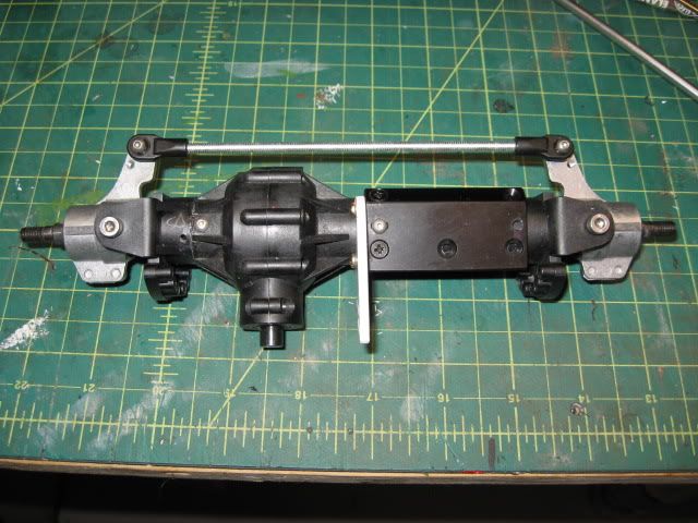

Assembled. Width is a perfect match to the rear.
Mounted up with my link locations

Isn't the front diff on a Heep supposed to be on the passenger side?:lmao: Just playin.... That is a pretty sweet scaler."thumbsup" I'm glad we have all these sweet parts for Kyosho axles now/again. I need to build something new. Hmmmm
Well not when it's been upgraded !! Duh . "thumbsup"
I did it this way for better steering geometry to be honest with you. But when upgrading, it can go either way depending on what your running gear is.
Great build RDD"thumbsup" Or should I call it rebuild. Nice review too. Rick is doing one hell of a job with ALL this new T/MF stuff. Very cool of him to take the time and design and produce all these sick parts. All at the one stop shop!!!
And Toyota guy, it depends on the year and model too:wink:
