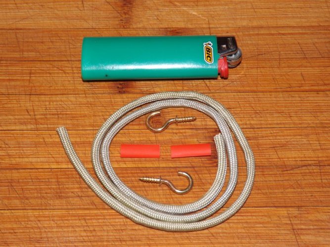

This is all that's required: a lighter, a length of paracord, heat shrink tube and a couple screw-in hooks.

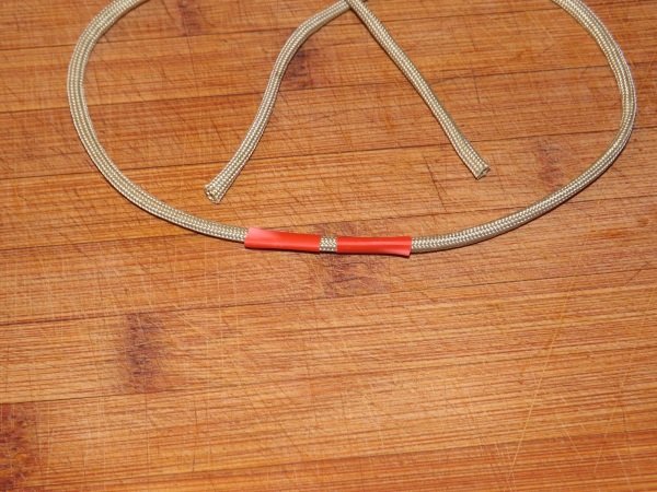

First, gut the paracord and slide the heat shrink tube to the middle.

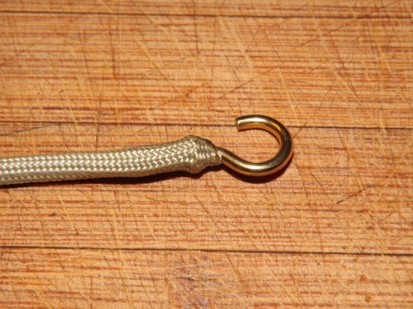

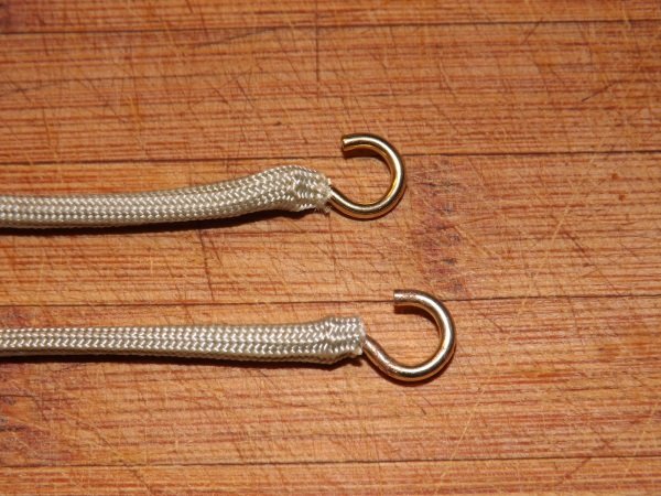

Insert a hook into each end of the paracord until the shoulder of the hook is completely inside.
Give the paracord a good melt with the lighter so it forms around the shoulder. At this point you could apply a few drops of CA glue for added strength. Mine is petrified so I have to get a new bottle.

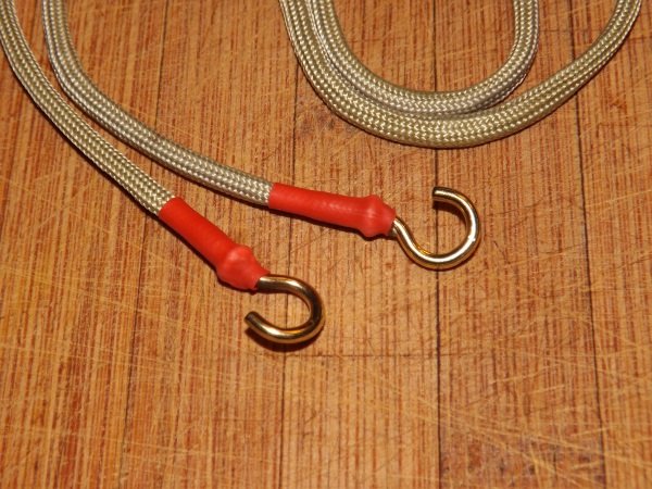

Slide the heat shrink tube up to cover everything.
Shrink the tube with the lighter and they're done.
So fast and easy, you can make a whole pile of them. "thumbsup"
