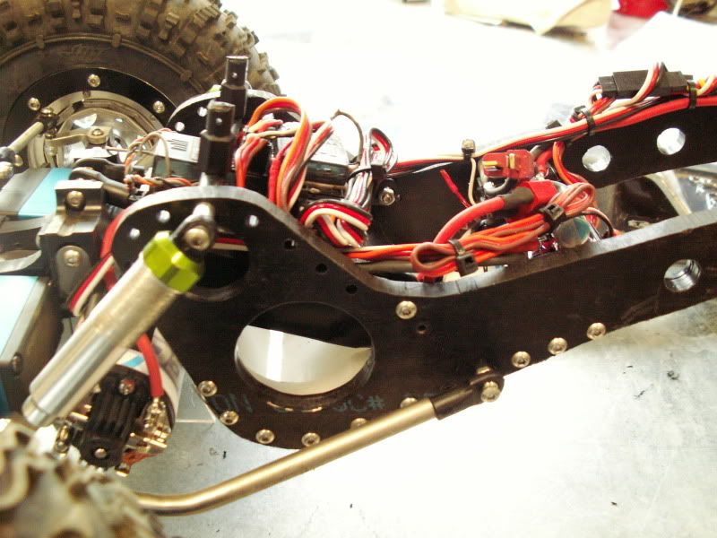

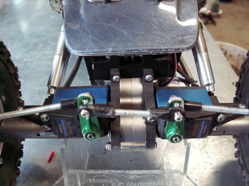

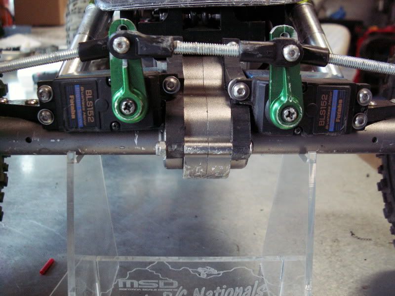

The pictures do this super no justice. Some good closeup shots of the custom servo mounts and uppper link mounts are in order to give you an idea of the time and skill that went into this build.
(Taps foot impatiently....)I'm waiting to see them Jim:mrgreen:
You got any shots with the body off? It looks like a Mantis chassis clone from what I can see. It looks great and the steering angle is great
H3rescue started the mantis with a super, then made the 2.2 and hasn't done alot with it. He offered it to me(2.2) to play with, so I ran with it! now there is a SD2.2 version of the chassis!!!!:twisted: Since ive been wanting to buikd a super for a while I figured why not for worlds(At least since im building bombproof berg axles) So It is a mantis of sorts. It is quite a bit different from the OG version of the super.
Yup that's what it is, I was checkin it out at the last comp we had. I think it's 1/4 delrin, maybe thicker?
Yes we started with 1/4 derlin for this build.
No clone there. The ORIGINAL Mantis was a super and Superdave is frineds with Jason who is the designer of the original Mantis.

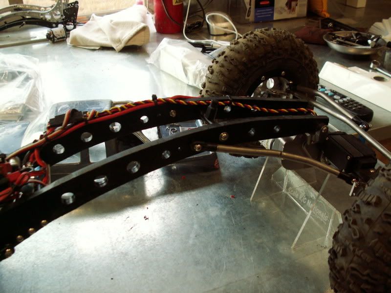

here's a few more pics of the car. thanks for all the comments guys! i hope she does me good this weekend!"thumbsup"
I like the longer front link geo and wider spaced chassis at the rear mount."thumbsup"
Great job guys! There is a lot of nice fab work in that truck. Those servo/link mounts are just awesome.

Why the duel servo up front and only a single servo in back?
with the 6.75 tall tires u need more steering (i think). I run this same car in a 2.2, I like to make the truck reposition with the steering. 900 in oz. gets it done up front. in the rear on a super to much steering can move the truck at the wrong time if u release the steering!
