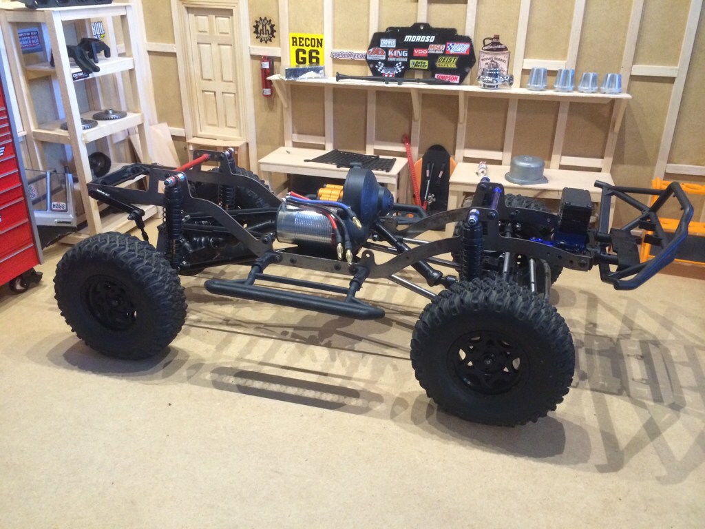

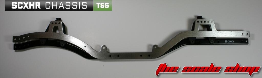

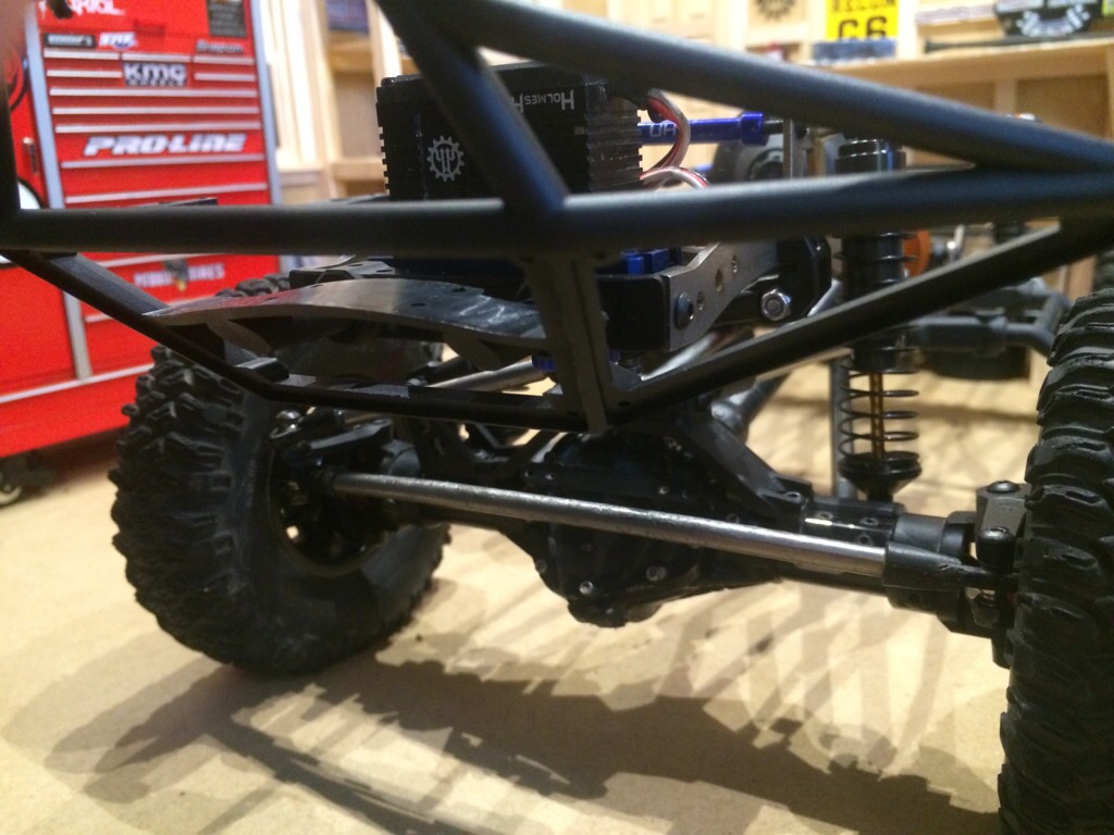

Starting off with TSS SCX-HR chassis
Big Bore shocks, JeepinDoug spring cups, losi blacks and RPM two stage pistons (blue for now)
Mock links
Vanquish SCX Curries
1.9 MTZ's
Crawler Innovations DD foams
Mock up wheels
3-link for now
Holmes Hobbies BL Servo
Mock up honcho bumper. May not use this
Axial sway bar out back with mock up tlt mounts on curries
TSS Smooth Skid
Vanquish trans case
Robinson internal gears
32p spur
Mock up Tekin 13.5
MIP drivelines

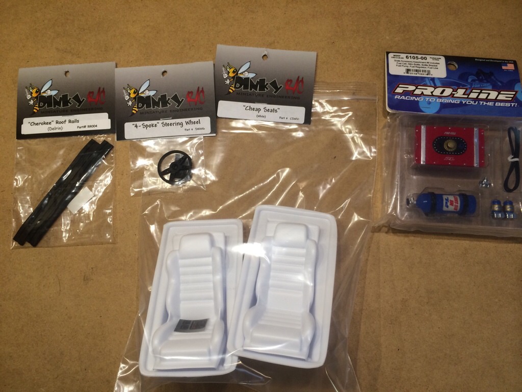

Dinky RC Cherokee roof racks
Dinky RC cheap seats
Dinky RC steering wheel
Proline fuel cell

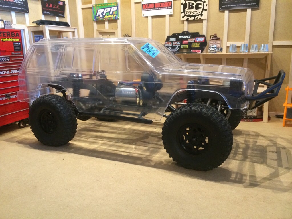

Mocked up

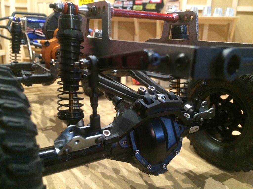

Thanks, It's not at final ride height right now, ill adjust all that later. The springs are losi 1.2's and will probably be too soft. All just mock up right now. Went with second from lightest blue rpm pistons too. Not sure which pistons ill end up with when its ready to roll.
After your last Cherokee I cant wait to see what you come up with! Looks good so far "thumbsup"
You remember that ol' rig? I plan on topping it with this one. Or getting close.

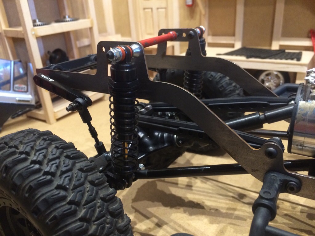

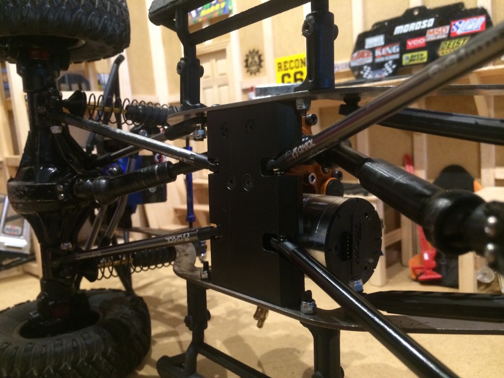

All I am waiting on is the 3/16" tube and a few odds/ends parts but there are things I can do now. The shock setup is going to be interesting, as I have never used these two stage pistons and it took me about 2 hours to get them installed but I think they will be worth it.

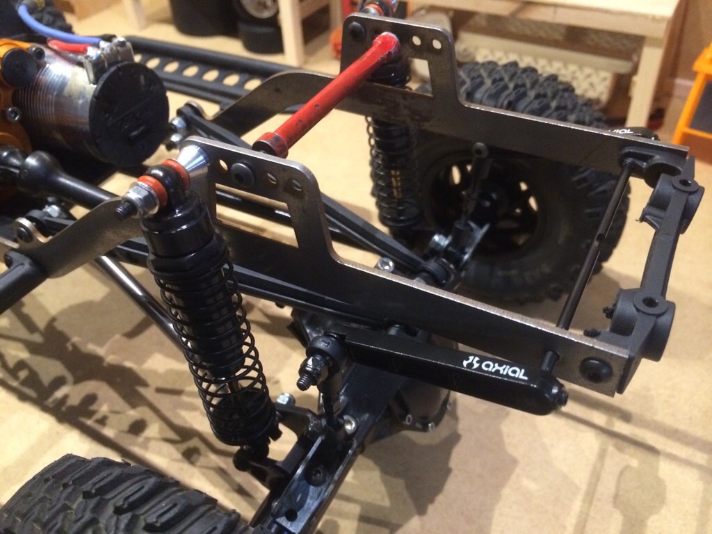

Solid axle's for this build. :ror: there are 6 RPM pistons to choose from. Let's call them 1-6, 1 being lightest. I put in #2 front and back to start with and 35 wt oil as it recommends.
That's a good plan to stick with :ror:
I think the pistons would be great for fine tuning. Especially with the softer springs that you have installed. Or at least they look it.

I will probably end up going with 20wt oil and the lightest pistons. I built 4 other shocks for my 2.2 wraith today and learned some things. Also been texting with Almighty Malach about RPM and MIP piston setup "thumbsup"

i find RC trucks like to have a bit of weight about them when it comes to properly functioning suspension. would you agree? or does it very much depend on the shocks themselves?
You are correct but it really depends on how good you know how to setup suspension, weight distribution and shocks/springs. It does depend on the shocks as well, I am learning not to skimp on shock quality or setup. I think a heavier "thrown together, not tuned" rig can be a "band aid" for a lighter weight, correctly setup truck, if that makes sense. But heavy rigs can work great too, when setup for it. I had a 7.25lbs custom twin hammer that had a 6oz scale LS1 out back and it worked awesome in 2nd fast runs, blasting around the ultra4 track or in 1st gear crawling in the trail.
