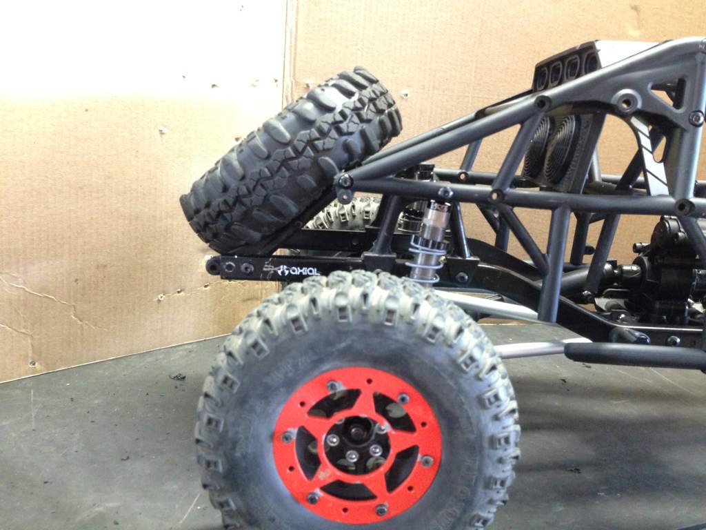

Twin Hammer spare tire carrier grafted onto a wraith chassis piece grafted to the exo cage
Not perfect but works

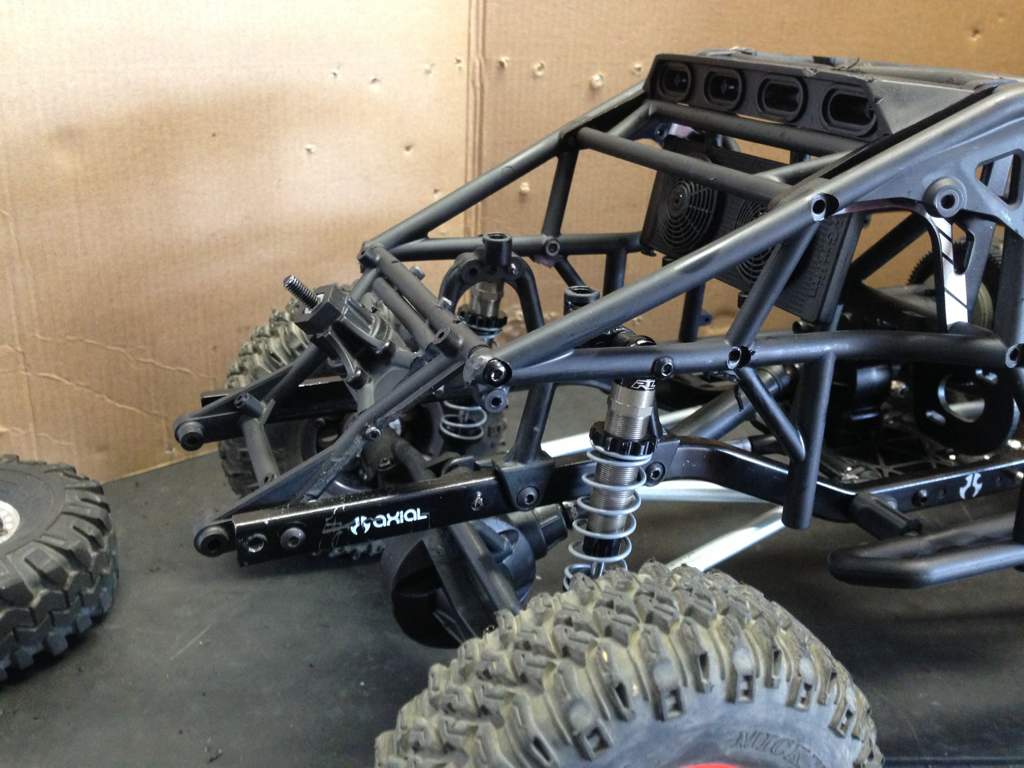

New upper link mounts for rear end. In highest hole. One lower and then the stock hole is still useful.
Quick steel mounts MIG'd to the SCX.
Backside of frame is boxed in.
Trans flipped and just clears spur cover.

Love where this is going. I'm going to do the same to my rear links after doing the math on the geometry (as seen in doublej's thread in the general scale section)
I love that this is legitimately a kit bash build from at least 4 different vehicles. Most of my builds are kit bashed but I think so far maxed at maybe 3 different vehicles.

I haven't ever changed up the SCX geo, so we'll see how it goes. Definitley should help while climbing to get the front end to squat down.
Glad I have a hoard of 7 years of RC crawler scraps and bits in my garage. Parts used so far Wraith, Exo, SCX and Twin Hammers.

Gotcha. I am about as low as I can go now. It's in a semi-droop shock setup now. I would have to notch the chassis and rework the upper cage. That would require more work than just cutting and drill some more exo or wraith plastic bits.
Right now, I think the ride height is good for the rig I am invisioning. Ultra4 type racing buggy/crawler.

Thanks, just some scrap steel I had laying around. The inside of the frame channel is boxed in with a small piece of steel as well.
