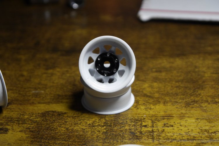

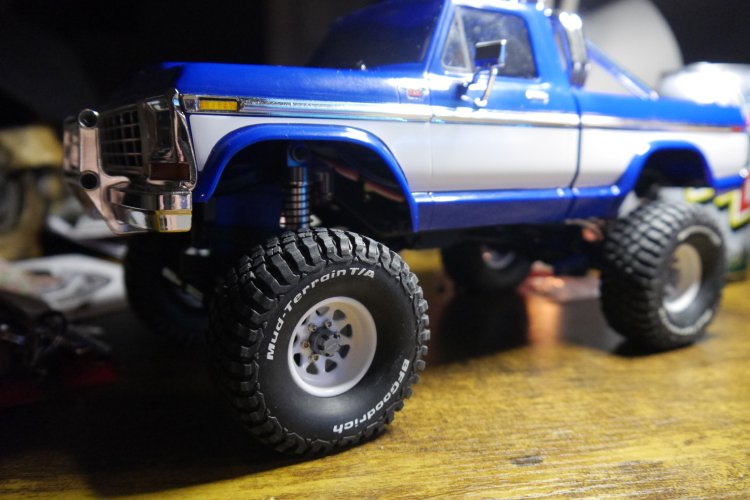

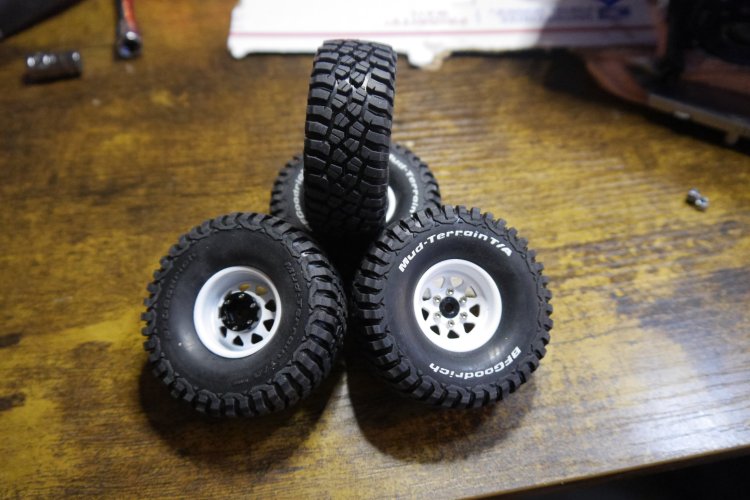

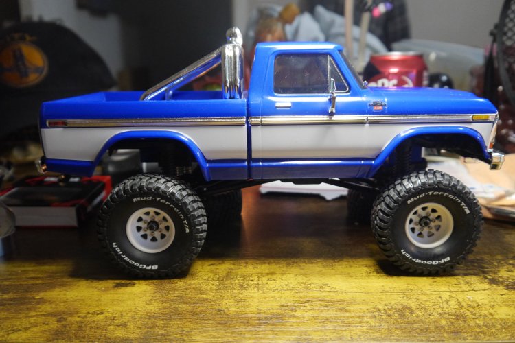

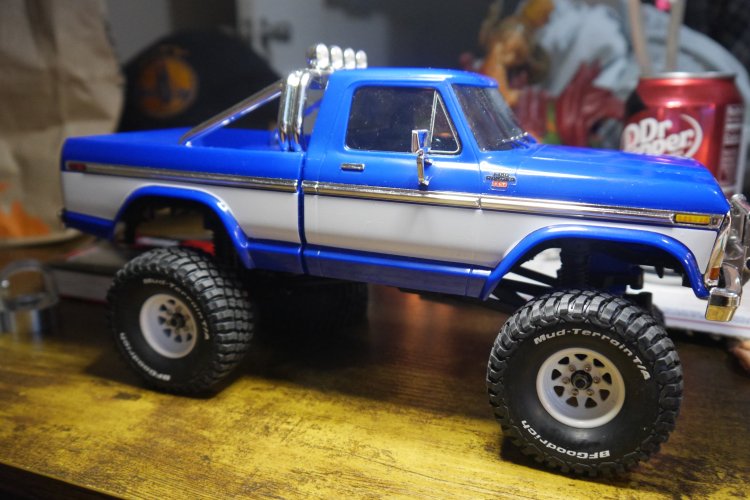

I received the 1.3 mm hexes today. So, I put the wheels together without the rings and mounted the tires just to see truck with all the wheels and tires on it. It looks awesome IMO.

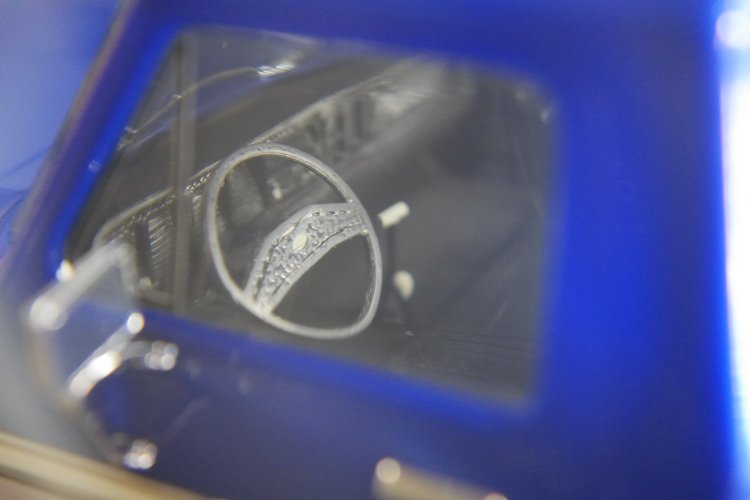

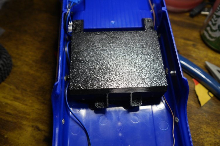

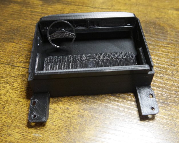

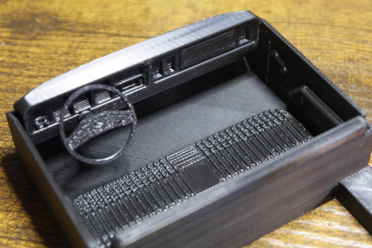

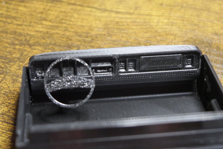

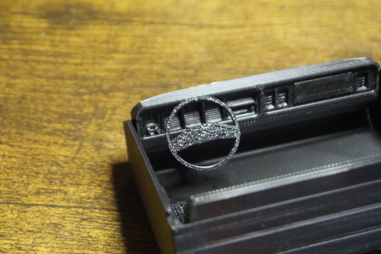

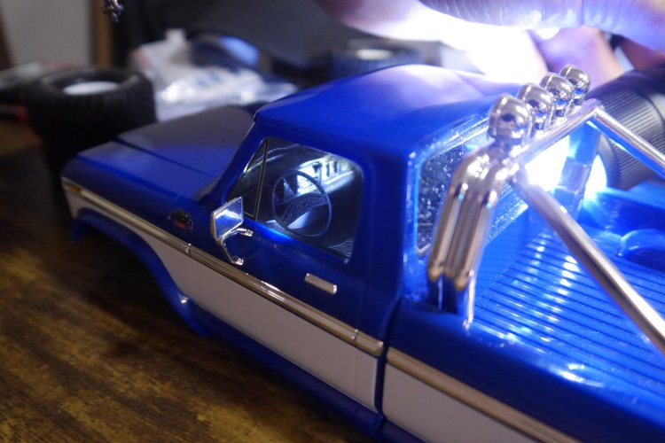

The Interior came in from ShrinkRC. It looks pretty good. I sanded the steering wheel a bit so it wasn't as rough, but forgot to get an after pic. But you can see it through the window.

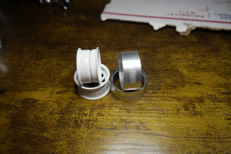

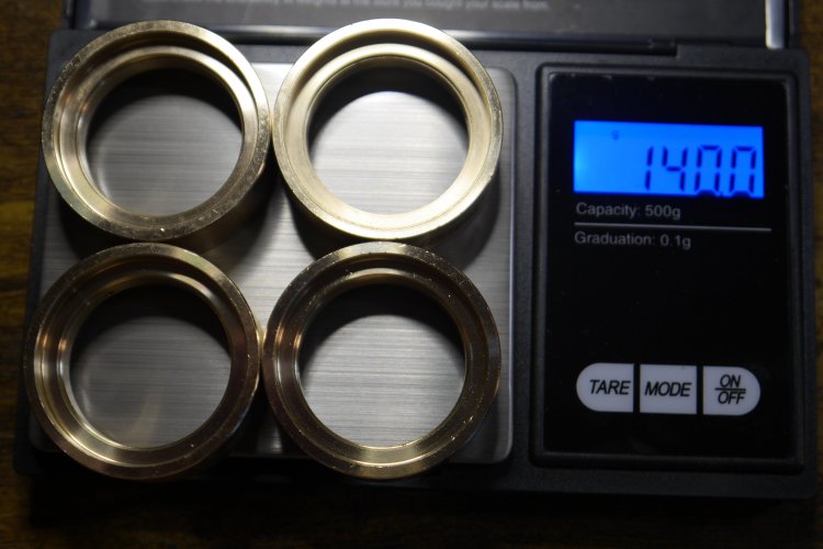

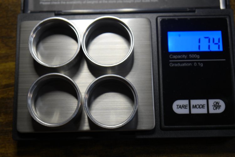

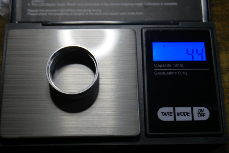

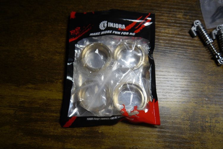

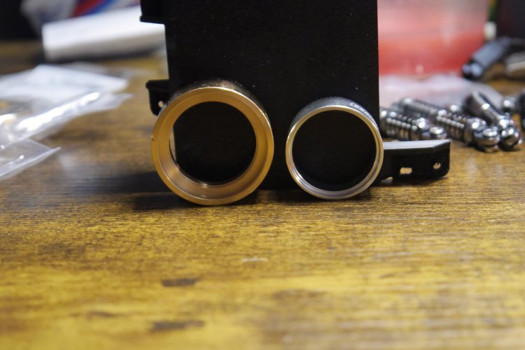

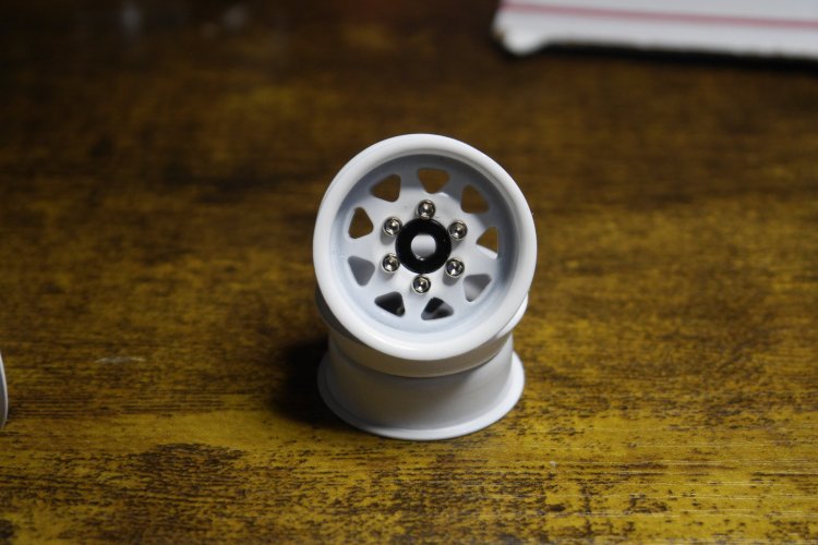

The wheel, "Ring/Weights," arrived. These work with the Traxxas tires with the thick beads. They add some great weight down low. I put them on the scale versus the rings that came with the wheels. Huge difference. On the scale, the rings that came with the wheels are 4.4g. The other rings are 35g. The total of the old 17.4g and the new 140g. Tires, wheels, and rings total 8.64 Oz. That's a half pound of unsprung weight way down low.

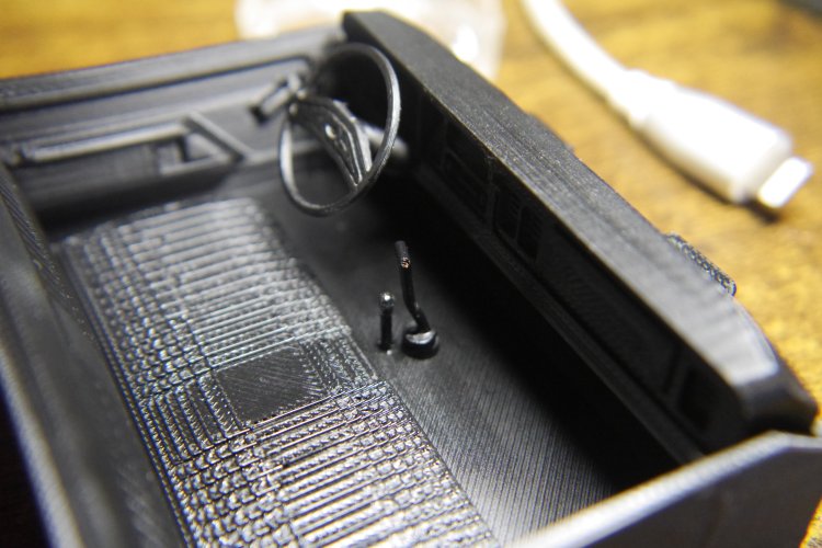

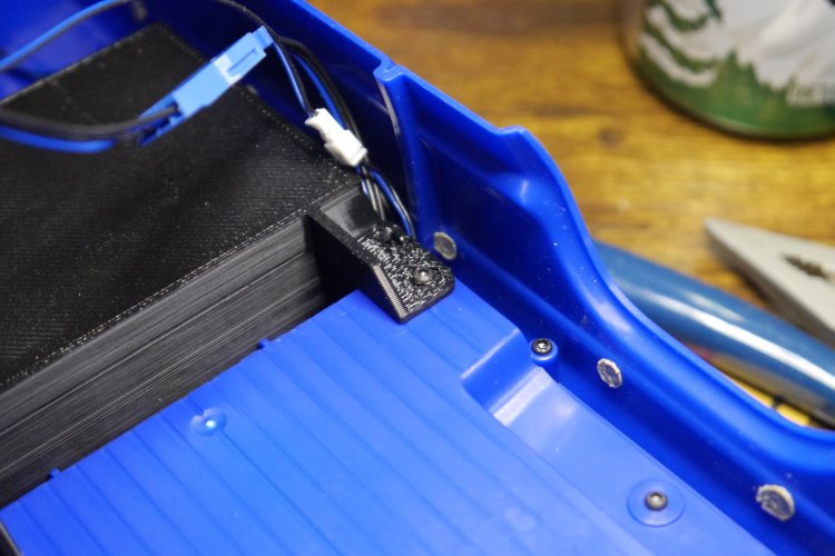

So, the ShrinkRC interior doesn't come with any type of gear shifter. But now mine has one. It's not painted yet but when it's done the "T" handle will be silver and the knob on the 4x4 shifter will be silver. And all thanks to a pair of broken headphones...LOL, but I'm looking for a better shifter, one that looks realistic. Not just thrown together like mine.

Idk, just one guys opinion but I'd keep both. They look good and legit enough. To me there's something really cool about taking some old part ( completely unrelated to RC) and modifying it to suit a purpose in the innovative scale-building world. Many times I look back at things I've built or modified or fabricated and smiled due to the creativity. Also cool to make stuff rather than buy.
Thanks, man.
Oh, you should see my ClodBuster build I did. (Which I'm also working on. I'll be doing a write-up on it soon.) Breakline and all-thread links, cutting board spacers/platforms for the battery tray and ESC tray between the chassis sides. Which are from a wheely king...LOL I know all about using stuff for what it's not intended for... It's one of the funnest ways to build custom RC parts. They don't make it? Then build it yourself...(y)

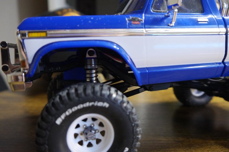

Since the body was off, I decided to get a pic of the shocks installed. I ordered the wrong size. These were 56mm. They should be 51mm. So I got some new ones on the way, but until then, I internally limited these with ball ends. It makes them a perfect 51mm. I reused the stock springs.

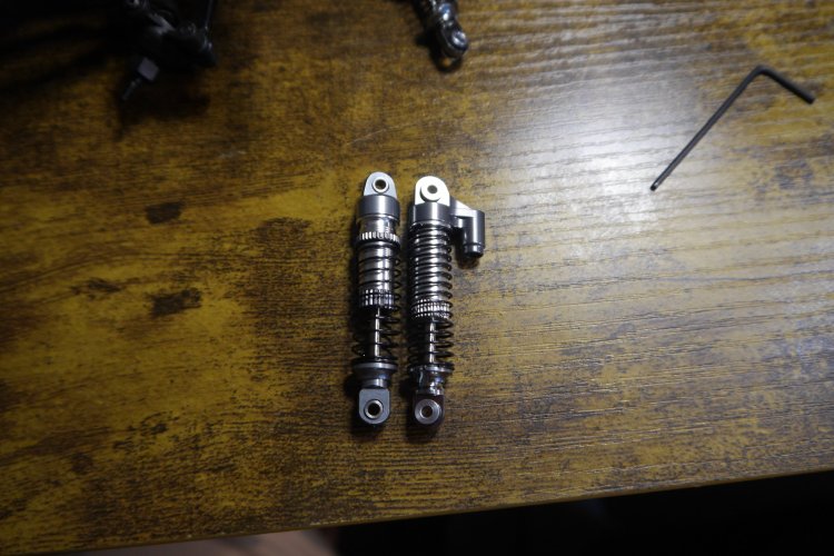

And yet another new set of shocks...lol. These are 51mm stock, with no internal limiting, unlike the last ones. Plus, the new ones are adjustable on the spring rate...

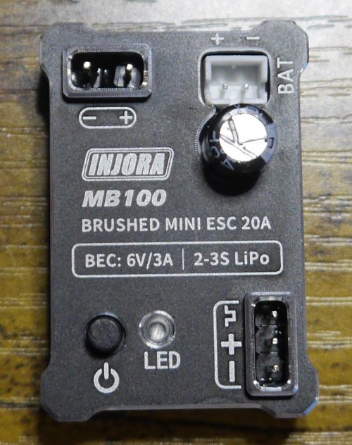

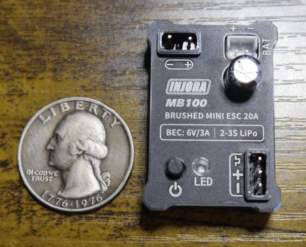

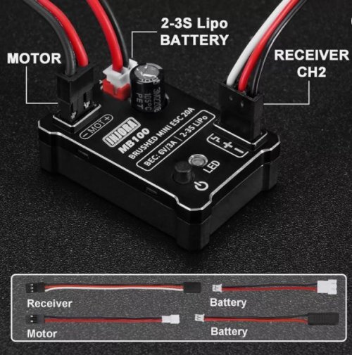

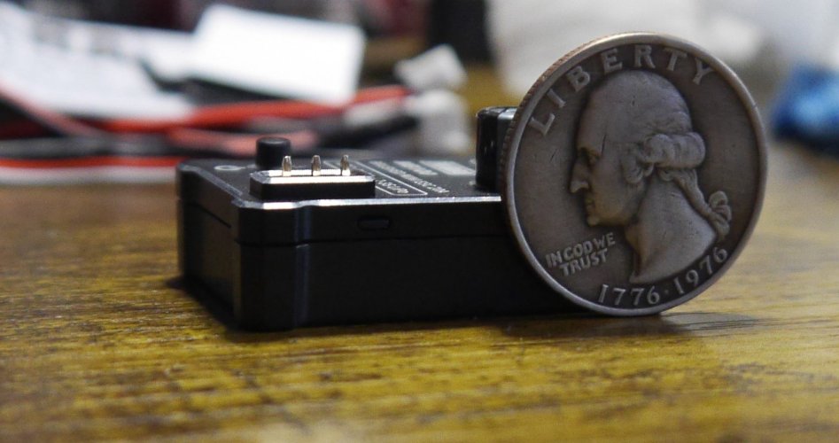

The Injora MB100-R80 ESC got here today. It comes with all the wiring needed to install into a TRX-4M right out of the box. With your receiver, of course. I'm still waiting on mine. (I have a weird idea on how to mount the receiver as well) The wires it comes with are a receiver, 2 battery converters, and a motor wire. And in case you've never seen one in person, here are some pics for scale. I'll be cutting my wires down to as short as possible and soldering then heat-shrinking them back together. I should see you guys/gals Monday night after the receiver gets here.
