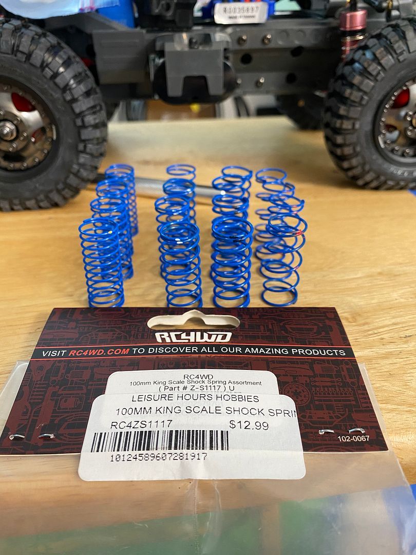

Made a trip to the LHS I bought the tires and battery for it at to see if they had any springs that would fit it and found a little package of RC4wd 100mm King Scale Shock Springs pn Z-S1117 that has 4 sets that range from very soft to stiffer than what it already it had on it.
I’d swear that these springs were made for these shocks too, they fit THAT good!
Just the softest springs up front is a huge game changer on this thing!
The *with the next stiffer springs out back (had to counter the weight of the rear motor)

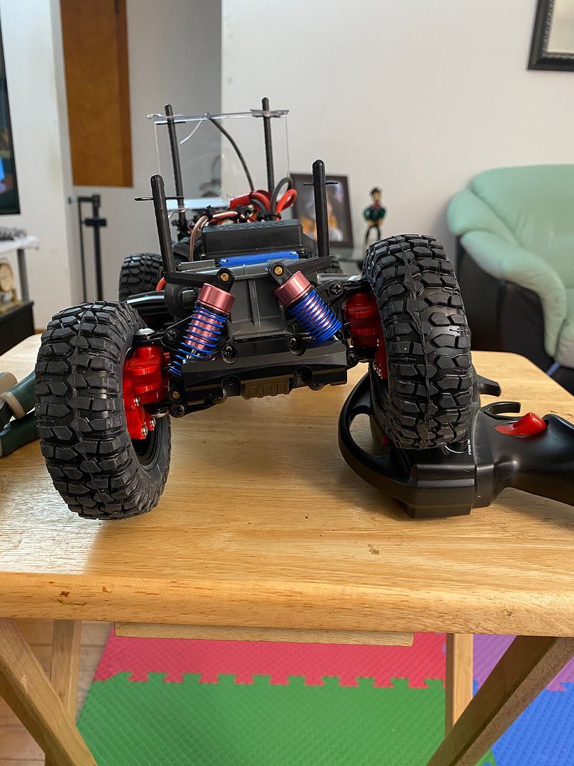

Then with the body back on it.......some trimming is needed for the front opening, the tires grab the back part of the fenders and front*bumper.
*And finally, the flex pics!
