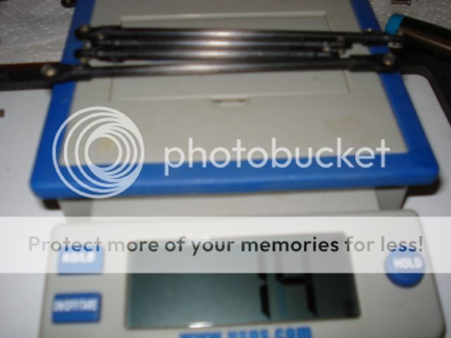

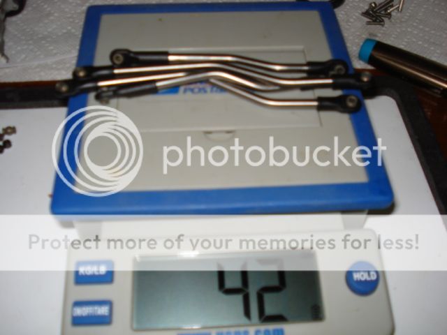

Thanks Rick@ Sniperfab. A whopping 17 grams with Steel rod balls. Al balls should be here Friday from RPP. Will weigh them again.

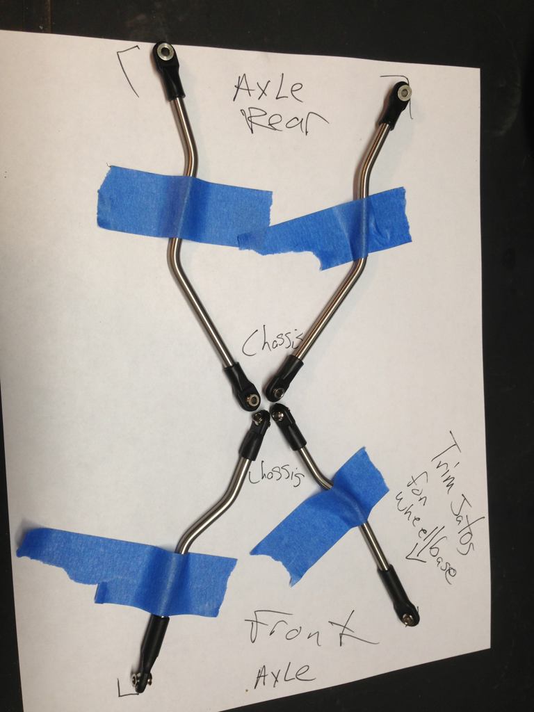

Got a pic from Szczerbza of my lower Ti links. Should be here tomorrow according to the tracking. Gotta love the follow through with the instructions. Bet even Sally could put them on right:ror:

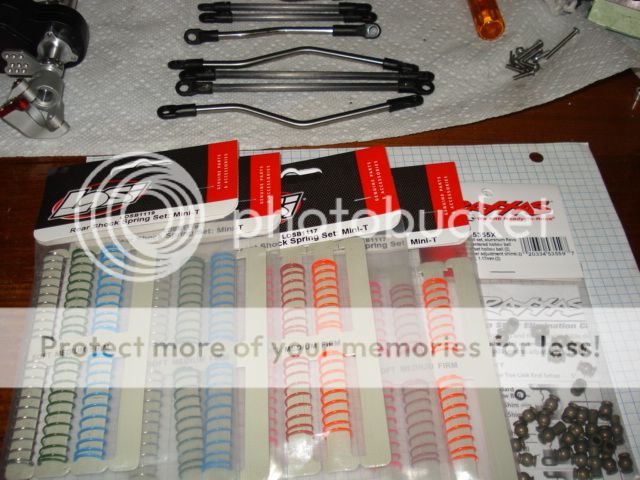

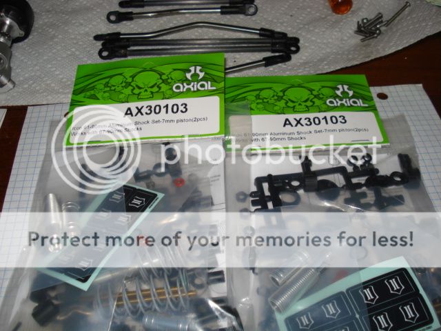

Ordered a set of the shiny Axial Icon shocks with the machined pistons(gotta be like 11enty million times better than the others) Hopefully, according to tracking they and the multitude of springs i ordered will be here Friday also. Might actually get to crank it up over the weekend8)

Before they were 18g now 14g
Lowers via Szczerba(coolest guy ever, would not let me pay him a cent for his time"thumbsup")

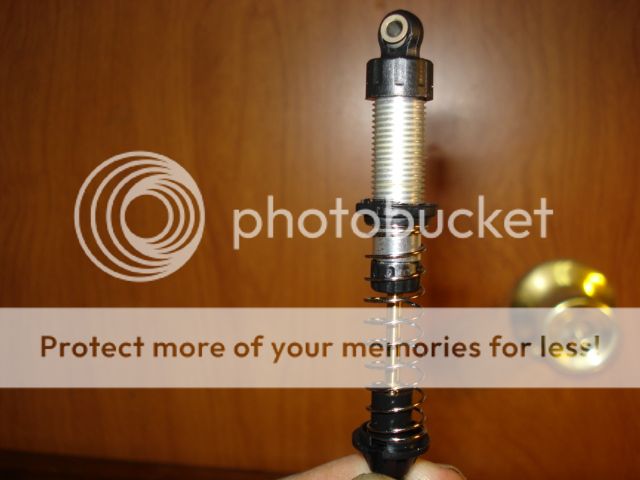

Machined pistons sooooooooo much smoother than the molded pistons"thumbsup"
