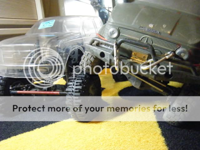

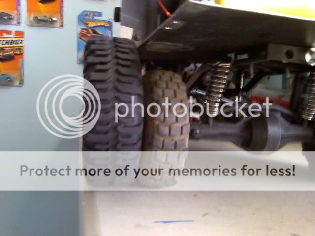

First off a size comparison with the boggers and the pluggers on my 404:shock:

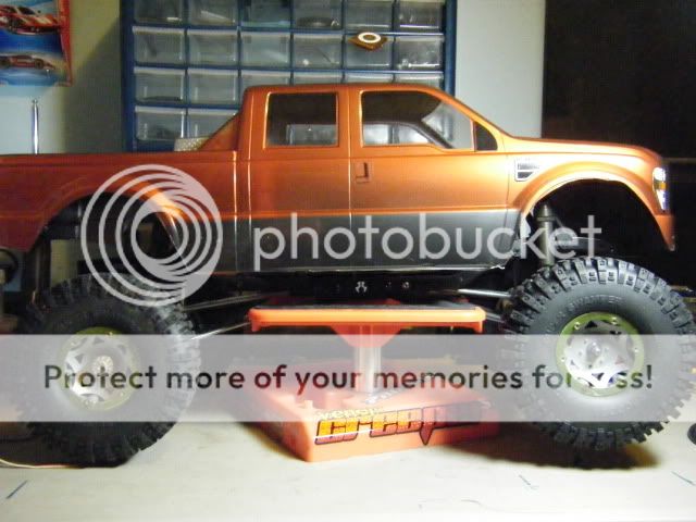

The official Flex shot

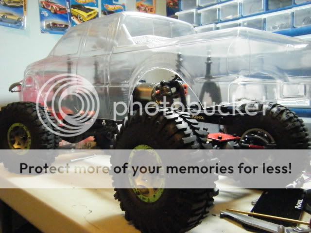

This afternoon i got the trans mounted with the installed 22T Mag Mahem motor and 19T pinion. I also got the body cut out.

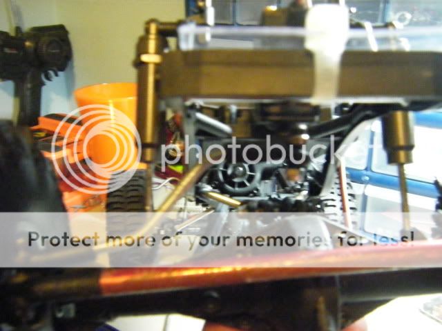

Started working on the cms this evening. I made a plate out of lexan to hold the servo in for mock up purpuses to make it easier to work on it
As you can see in the above pic i set the servo to be right about in the center of the frame and then proceded to test out different length and bends drag links...
But out of all the links i made i still got bump steer to varying levels with each drag link
So im thinking that i need to mount the servo on the left frame rail and have the longest possible drag link. Weather it works well or not i dont know but ill give it a shot tomorrow. However the handbros kit is probably out of the question as im not running axials or have a "standard" scx10 ride height. Besides, that would be the easy way out. I gotta figure this out, that's the fun part:mrgreen:

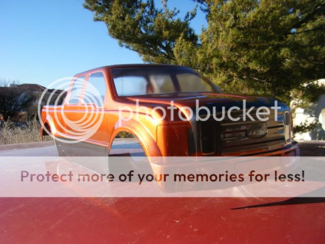

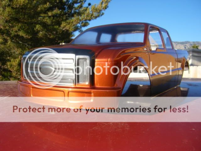

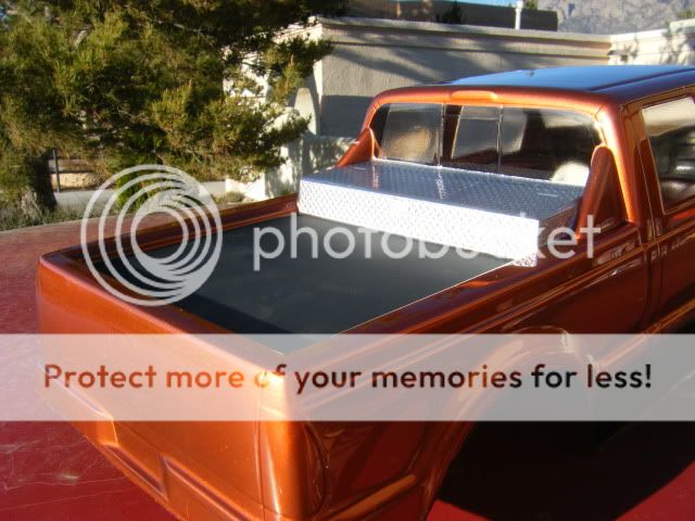

Finally got around to painting the F250. I had had it masked off and ready to go for the last 2 weeks, so i cleaned up the fenders with my dremel and blew everything off with the air compressor so it was clean.
I ended up going with Tamyia Copper and Gun Metal with a silver bed box. the bed is gun metal with flat clear on the outside giving it the look of a tonneau cover or bedliner. I do like how it came out

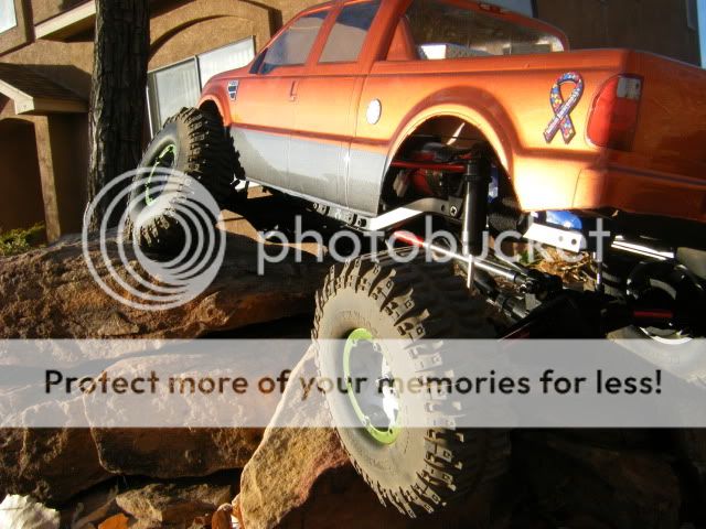

Walked out to the driveway and saw this...dang kids
20 minets later i saw this beast
And my favorite shot

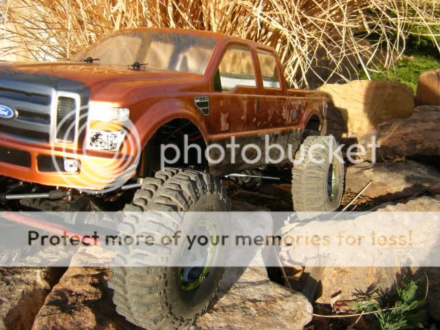

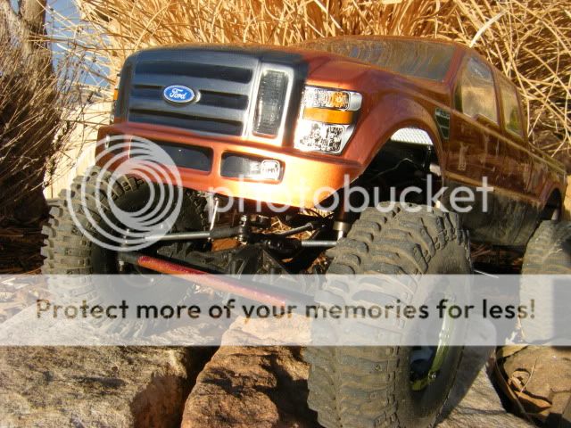

I finally got it running today after wrenching on the 1:1 mog. The 22T motor actually is pretty good on the rocks....when the damn tranny isnt slipping. Yup :roll:. It could probably hold up to the 22 for a while but lt lets the motor unmesh from the gears no matter how much loctite and how tight the dang bolts are. Its fine for a few minits than nasty gear grinding and then a free spinning motor.
Axial trannys are superior...period. I think this deserves it
