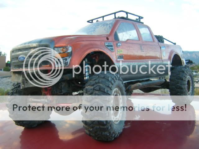

been a while on the updates but finaly got one.

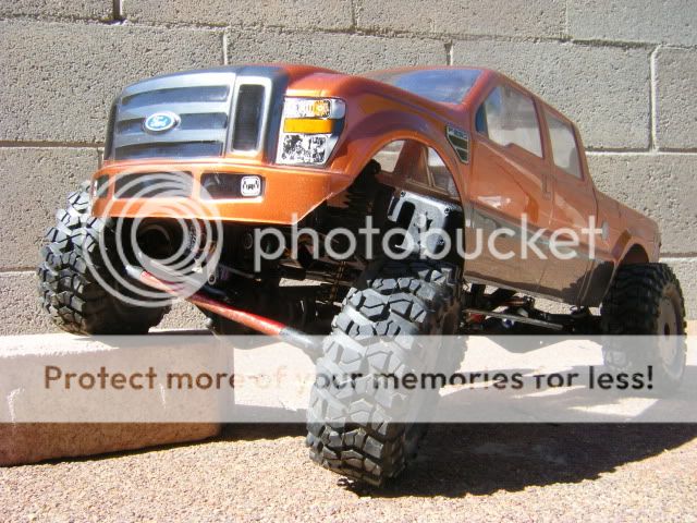

I ditched the boggers. Ever since i got them, i know that they just wouldent look right. not without major body trimming and a pinch/dovetail on the body. I reverted back to the stock flatirons from my scx10 kit and they look much better. I also used the scx10 shocks from the kit and lowered the body. Way better i think. Thinking about going to 1.5s but not to sure.
few pics before and after
Before
After
Still need hardware for the beadlocks, electronics installed, fenders/interior, and....i got till June 16:shock:

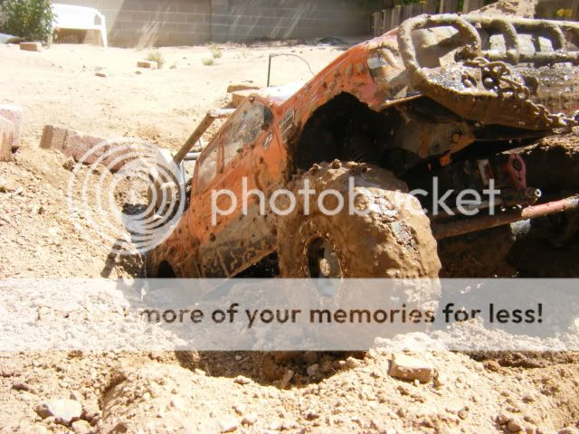

she is a runner. Ended up loctiting the motor bolts and have no problems with the creeper tranny:ror:

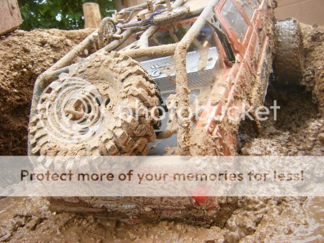

Mud?

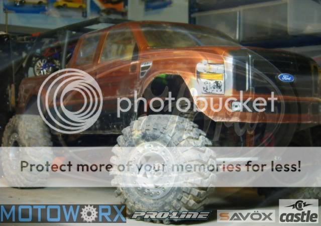

and with the Motoworx TR rings installed

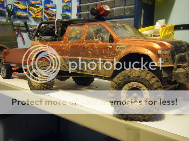

Finally did the velcro body mounts. I was worried about the strengh but so far so go. I am also align the body correctly so it dosent look like i missed on the links

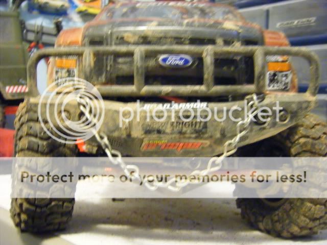

Started looking at the Road Armour bumpers for the 1:1s. and knew i had to get one made for my ford. I thought about having one made custom but i saw this one from a radio shack rc in the FS section with near exact dimensions as the front clip of the body. so i picked it up. No depth to mount a winch or anything but its the look i was going for. And it dosent kill my approach angle:ror:

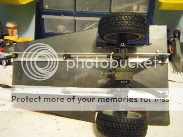

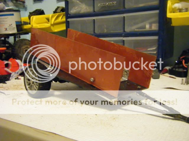

Also made this trailer out of aluminum and .093 thick Lexan sheet. Used a mrc axle and hpi touring car wheels and tires. Not the best but its my first trailer and i used what i had. More of a utility trailer than anything

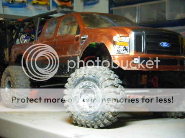

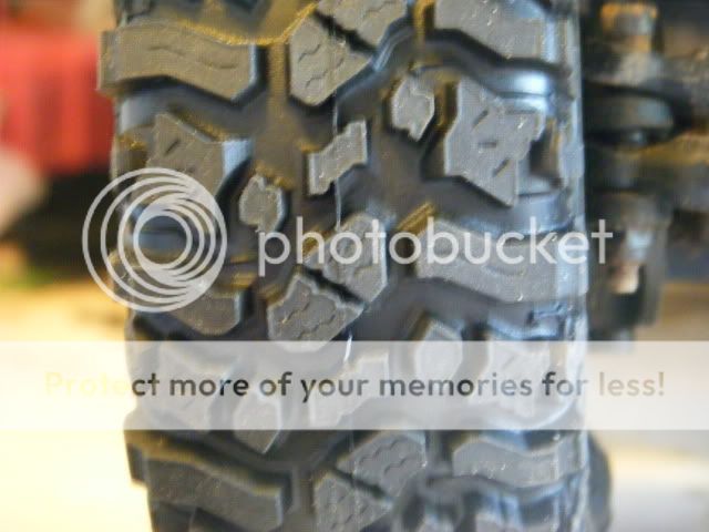

My order of the new 1.9 Pit Bulls came in today. Been waitin since late may for these:ror: Look is stellar. byfar the best ive seen of any scale tire. oh and the Komp Kompound with dual stage foams...well im super exited to try em out:mrgreen: Oh and there mounted on axial 8 holes painted with hammertone bronze and motoworx TR rings

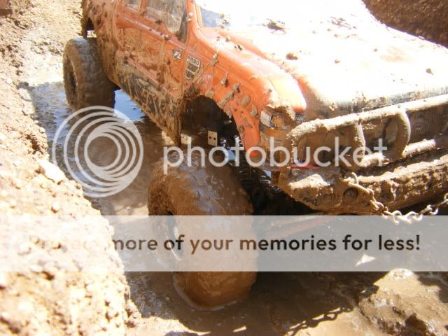

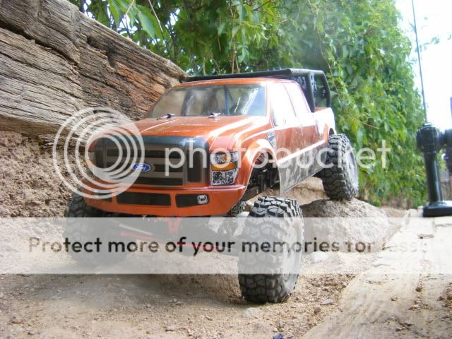

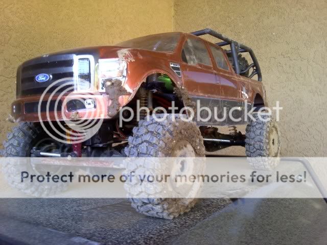

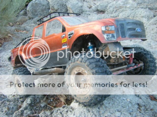

Another update. Hadnt touched it in the last couple of months but i gave the ol rig a tune up and ran the NMRCC Halloween Hammer-down last Sunday. Which was pretty dang fun"thumbsup". No major damage other than the front wheel bolts working loose and stripping out the hexes. It was after i ran in the 1.9 class while we were doing some scaling on the course. I didnt stop running it:ror:. the Pit bull tires were the reason it was doing so well in 2wd:lmao:
3 pics of my truck at the Hammer down. (thanks stick boy rick and dubaaron)

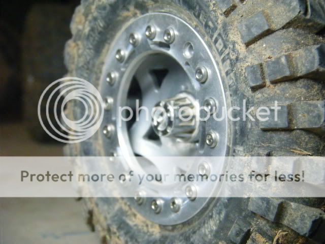

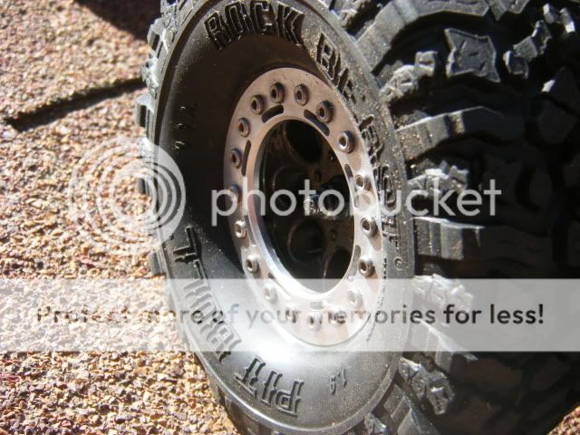

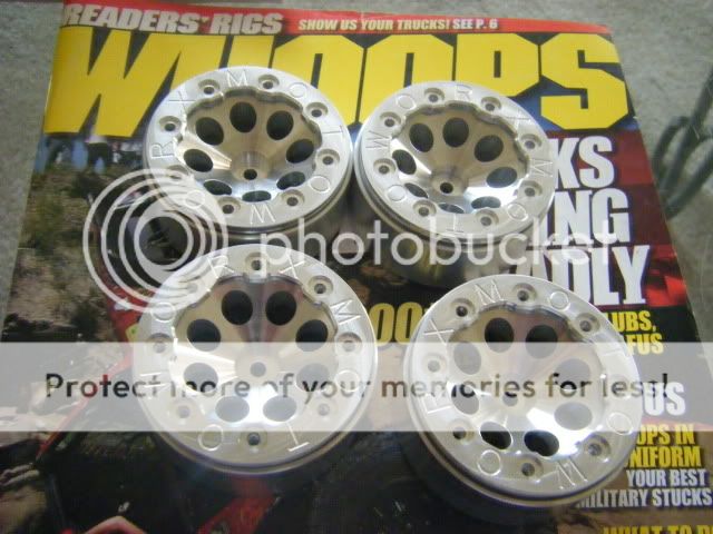

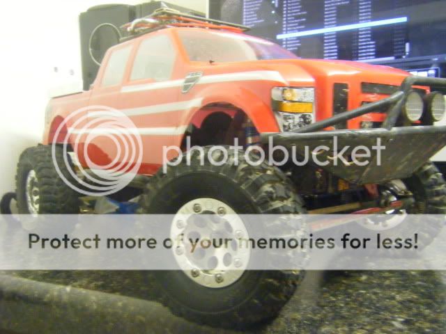

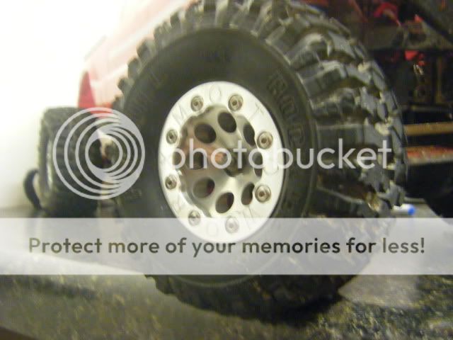

Now i knew that i needed new wheels and i had been looking at Motoworx's wheels for a while now. Well the tough decision of picking which 1.9 aside, I bit the bullet and bought them.
Ive never had Al wheels before so it'll be a big step up and it will at 1lb of goodness down low ( motoworx i gotta ask how you get each wheel and its rings and hardware exactly 4 oz:shock:). They also mounted up to the Pit Bulls beautifully.

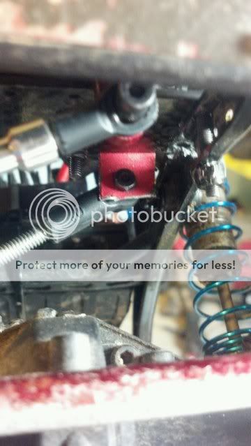

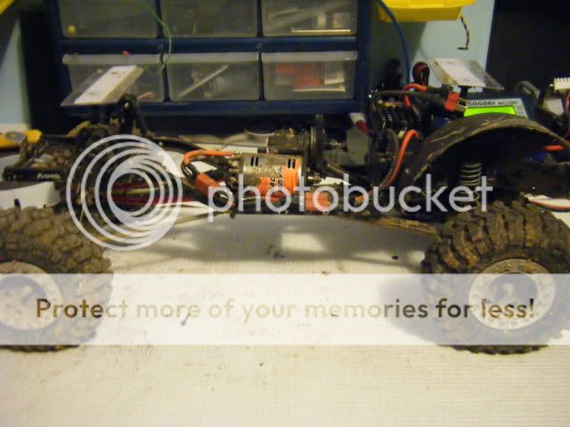

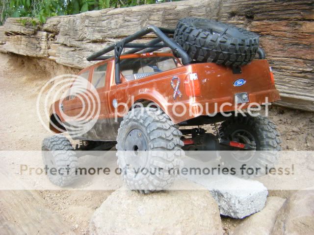

did some more work on it today. the big thing was getting a working CMS all setup in the truck. If it were not for a carbon mrc servo plate i had laying around, the servo would still be on the axle. with the plate sitting on top of the rails directly in front of the shock towers, the horn had lots of clearance all around

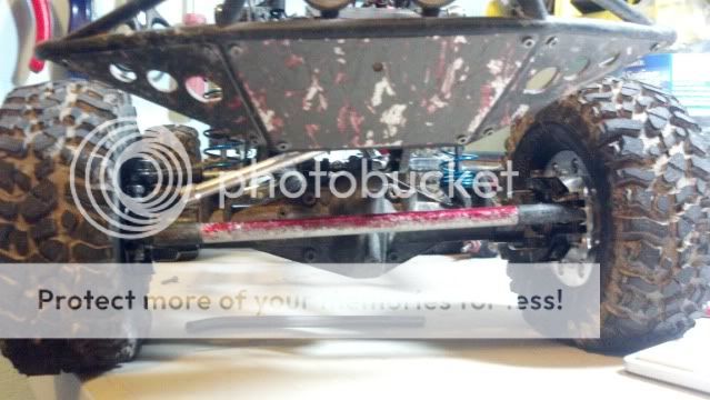

i had planned to keep the 4 link but after some reading and searching, i ended up going to a proper 3 link. The panhard bar took some thinking to get mounted because im using venom axles but i got it to work
The lower mount is bolted to the top of the knuckle( its aluminum so no worries)
And i made a bracket that bolts the upper to the driver side rear of the servo plate
Due to clearance issues, I had to bend the panhard bar but in looking at it , not as much. Works fine but Ill need to make another

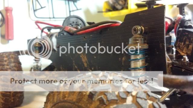

I also found these cool plastic strips in the garage. I figured they would be good to help keep some of the gunk and dirt out from the venerable area of the chassis, namely the battery

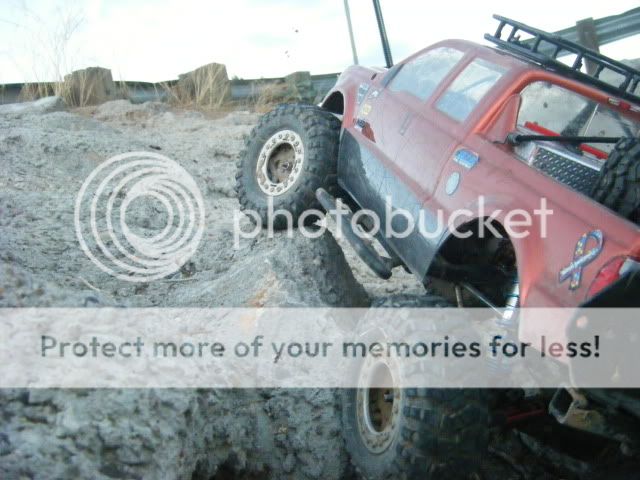

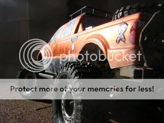

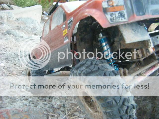

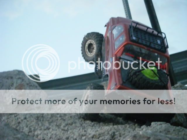

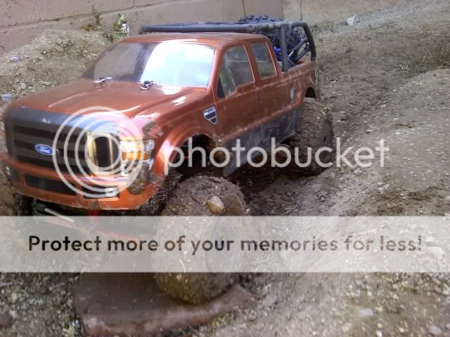

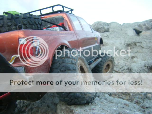

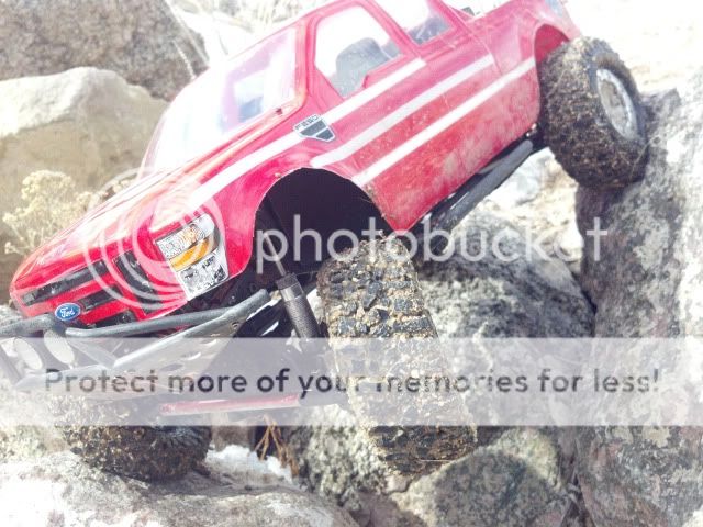

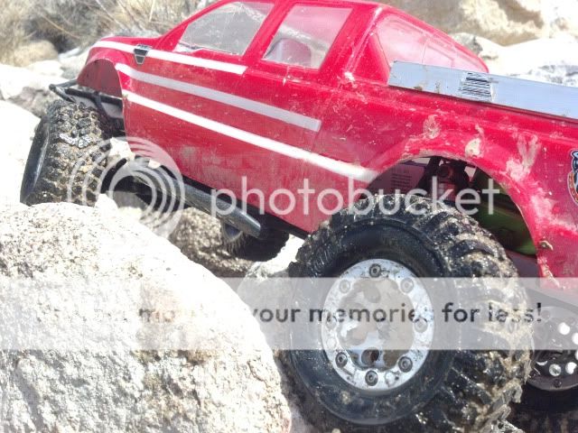

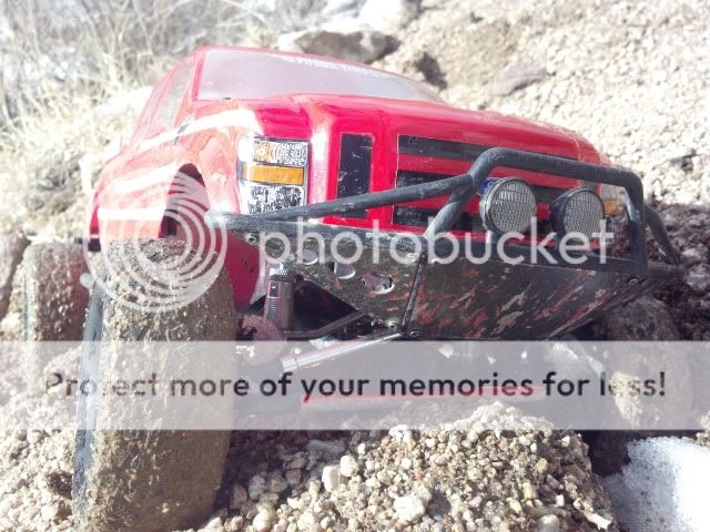

After running the truck for much of December with a Raptor body, i felt it was the time to swap in the F250s rear links and swap in the 50T motor in place of the Trinity Midnight motor and do some crawling. Still a good amount of snow but the rocks were dry. Got some pics with my phone. Enjoy"thumbsup"
And my favorite pic
