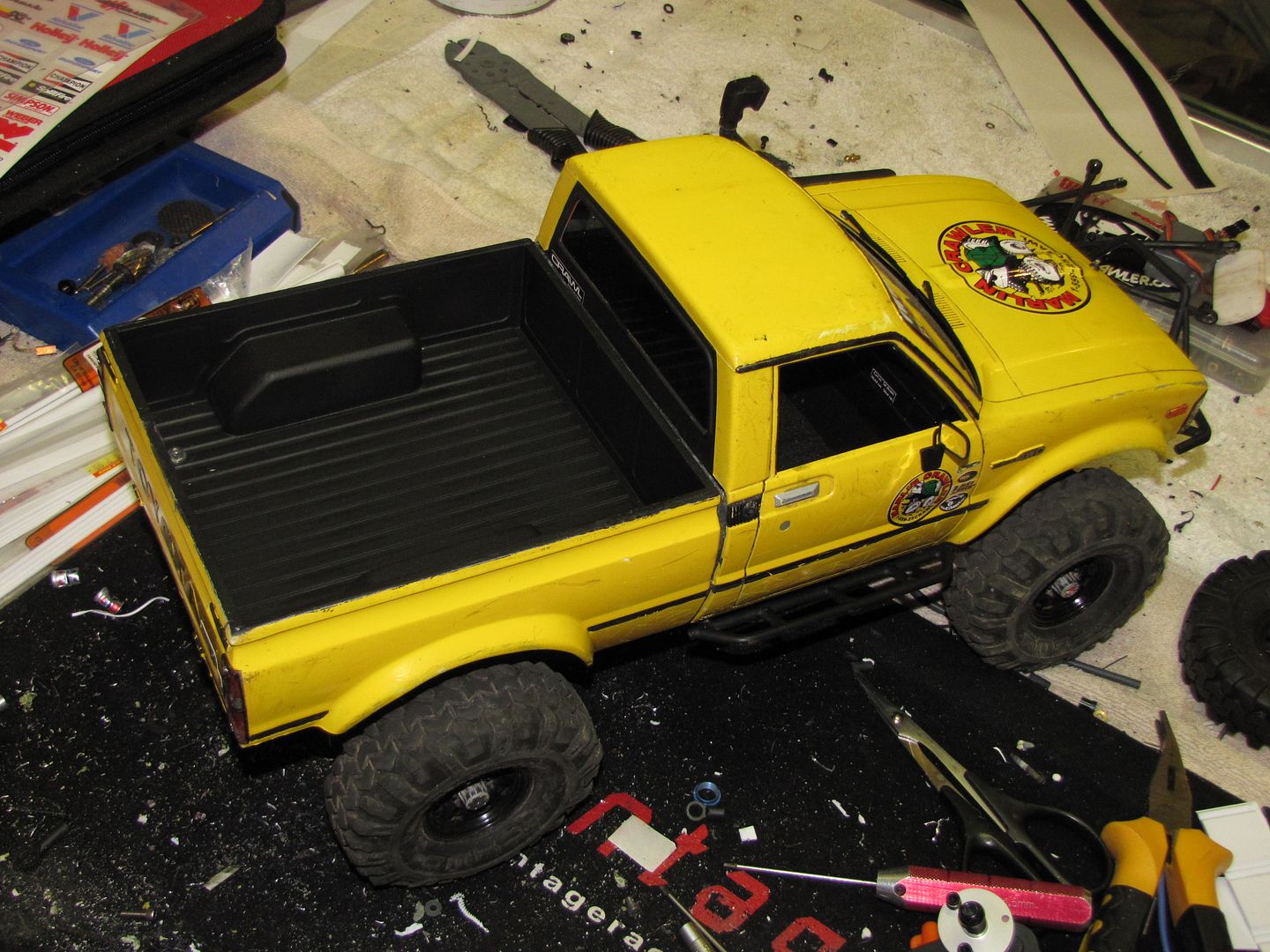

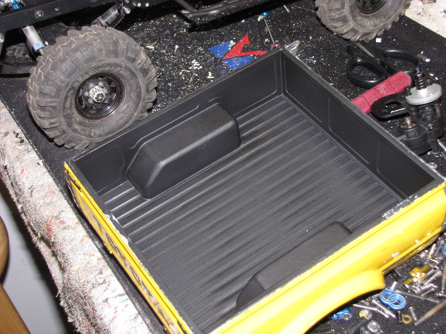

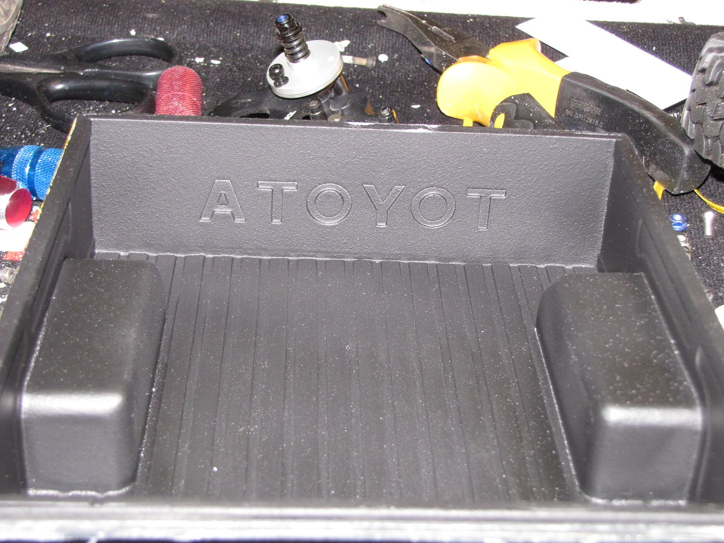

Here is another update. Got in a Drop Bed kit from Rogue Elements and hacked apart the bed this weekend. The end result is AWESOME! I will NEVER build my own drop bed again. This kit makes it so easy and the finish is awesome. Even with having to modify the kit to work with my drop bed it was still painless.
Onto the pictures

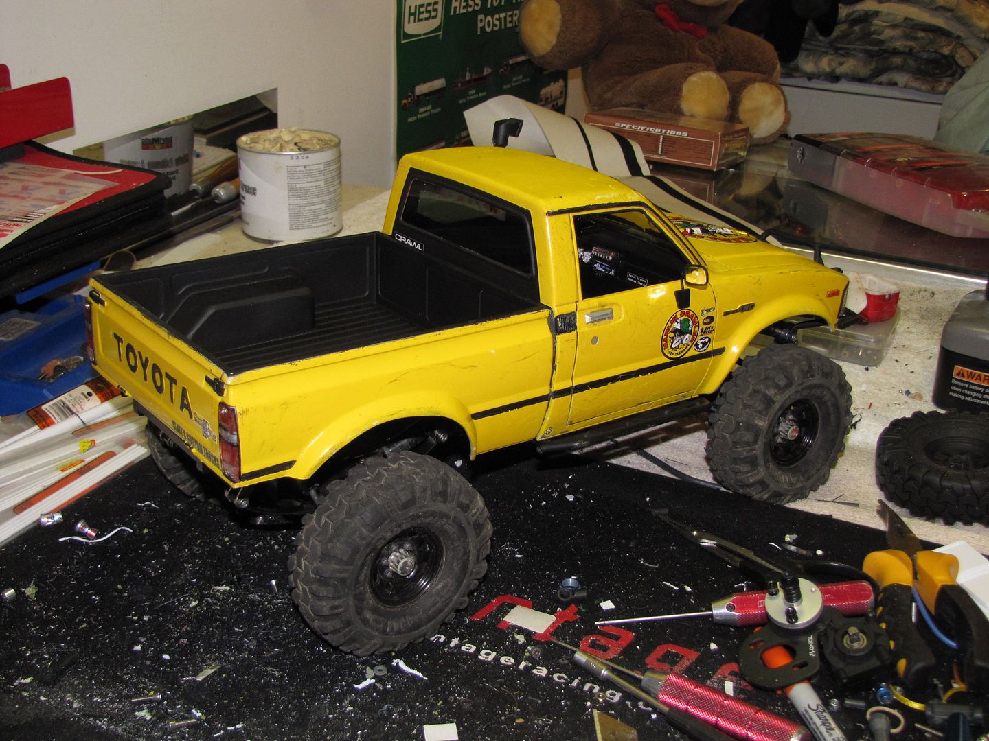

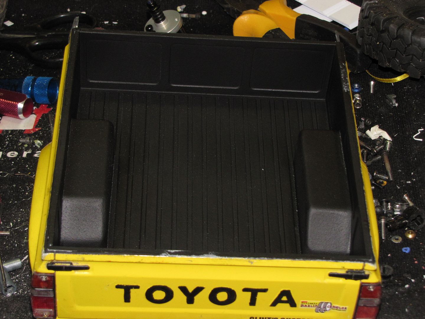

And back together on the truck
Sorry I didnt get any build pics but my time is extremely limited until I graduate from the academy, plus assembly was really straight forward. The most time consuming part of the whole thing is shape the rear fender wells to fit. I used a dremel and then some course sand paper and finished the finish with some smoother stuff in the end. I then sprayed it with a textured paint and flat black to give it a bed liner look. Last I comp cut the bed and plan to make a rear bumper for it when I have some free time.

Damn good looking
Rig I always thought that rogue kit would look awesome with some dents and damage to the wheel wells and bed floor give it that 20 year old yota bed look

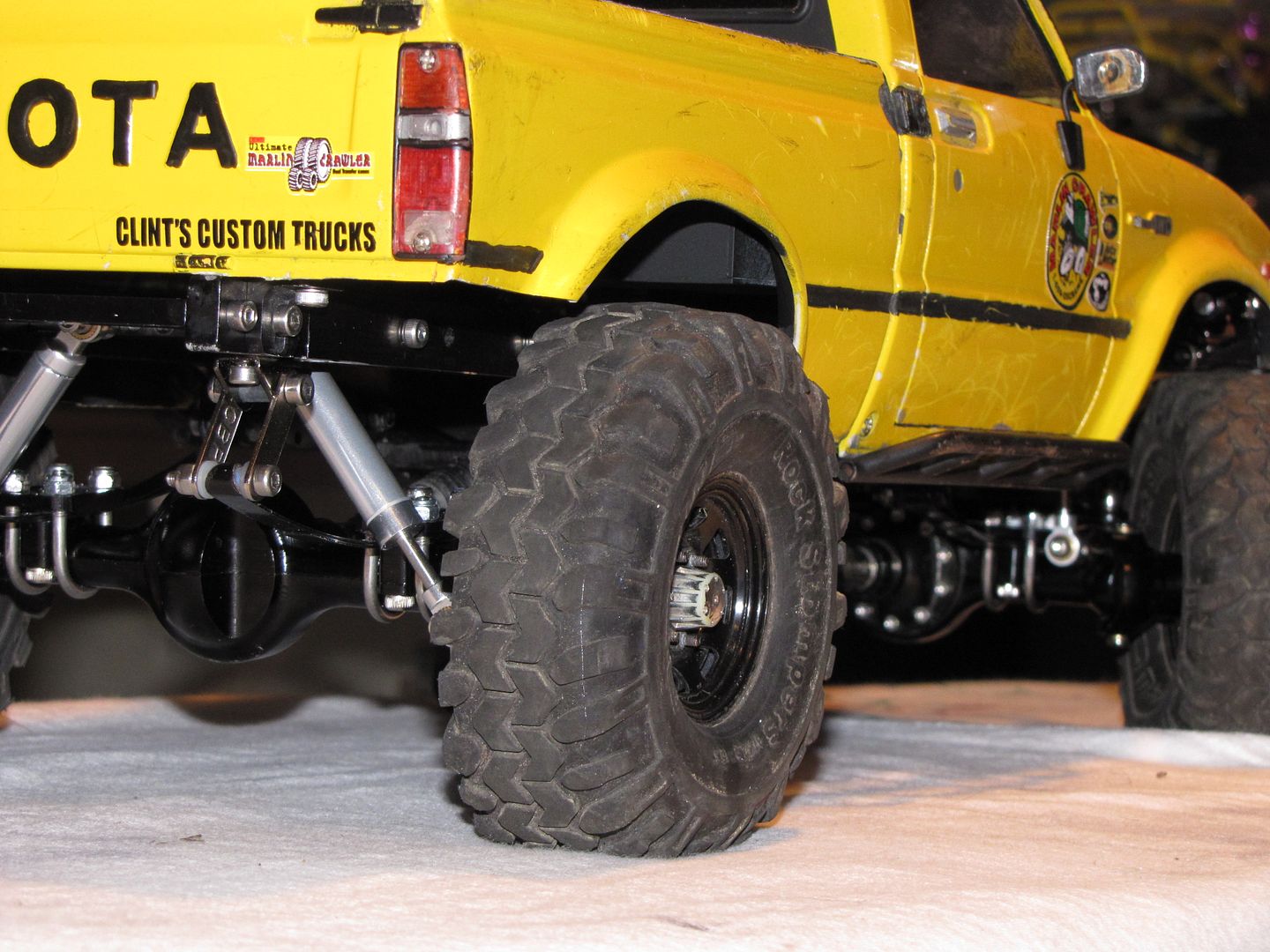

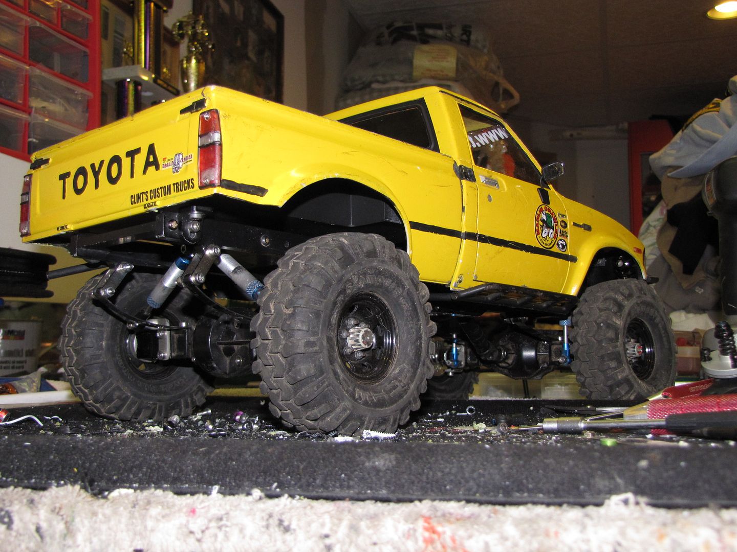

shocks, springs, axles, and shackles?
You are good, new RC4WD shocks, newly added longer and flexier RC4WD rear leafs which meant I needed to move the shackle hanger back like they do on real Yotas to get the proper shackle angle. And the obvious, Ultimate Yota axles :mrgreen:

Yeah I should have done that...didnt cross my mind at the time :x I plan to buy another kit and chop up another existing body that I have, I should try doing that on the next one.
