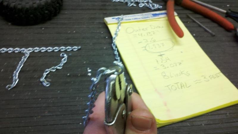

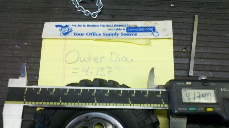

Ok so the first thing you will need to do is measure the inner diameter of where you would like the chain to wrap around. Once you have the diameter find the circumfrence. i.e. Diameter x Pi = circumfrence.
those were the measurements i chose to use. So take the circumfrence and measure the jack chain to the circumfrence then round UP to the nearest full link! I took it to 23 links total.
Write everything down as you go for reference. you will need the diameter for the next step.

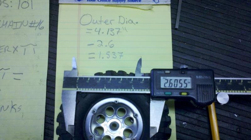

Now you need to minus the inner diameter from the outer diameter of the
entire wheel.

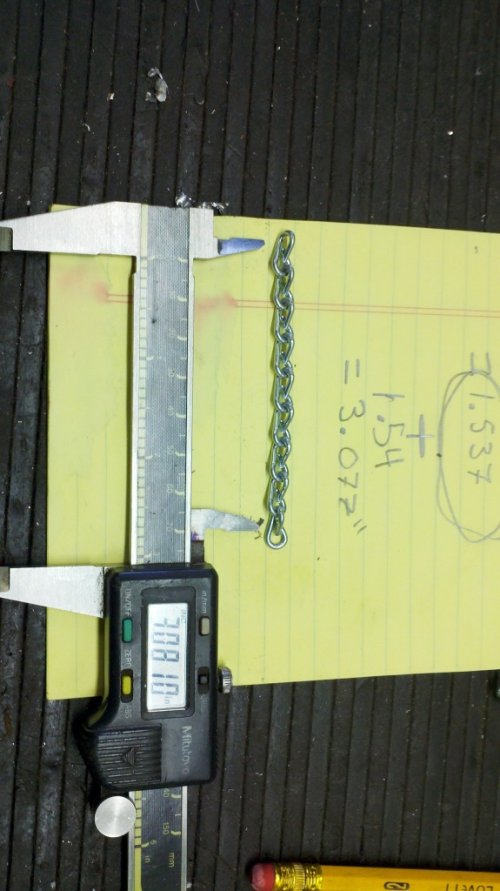

The length that you have there will be added to the width to get the
length of the runs
Note!!! i removed on link from this measurement to 7 links not 8.
In this case make sure that you round to the closest link i rounded up which did not work for me.
During this instructional i only used 6 runs but upped them to 8 runs. So total length per wheel was about 3.5 feet not 3 feet.
